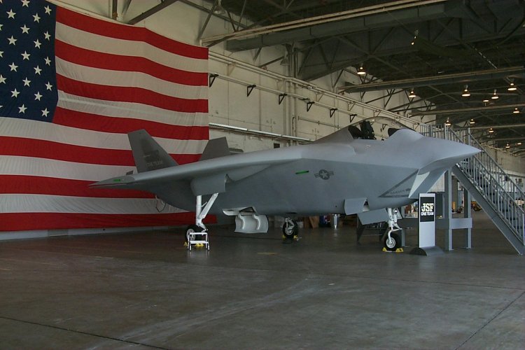

You absolutely can put fuel in the wings outboard of the folds.
It’s rarely done. The A-6 Intruder is one of the few designs I know that has fuel outboard of the folds (143 gallons per side, 950lbs each).
On a supersonic wing it makes less sense as the wing will be thin and the volume available in the outer section will be limited, especially considering the added complexity and weight, which is not desirable on a VTOL aircraft.
