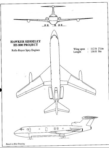

In his book British Secret Projects: Jet Bombers since 1949, Tony Buttler mentions the various aircraft that were possibilities for the replacement for the Shackleton.
Two of those possibilities were militarised versions of the Trident and the VC-10.
Does anyone have any information on these?

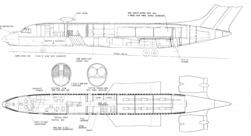

From the Crowood book on the Shackleton, IIRC

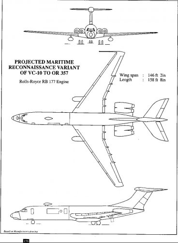

rickshaw said:
Interesting that neither has a MAD boom.
Well, there could have been a retractable MAD boom in the fairing of the high mounted tail planes?
Source: VC10: The Story of a Classic Jet Airliner, Key Publishing 2015, page 95
  • VC-10_OR-357_Maritime Patrol and Reconnaissance Aircraft _project__VC-10_KeyPub_page_95_810x439.png
