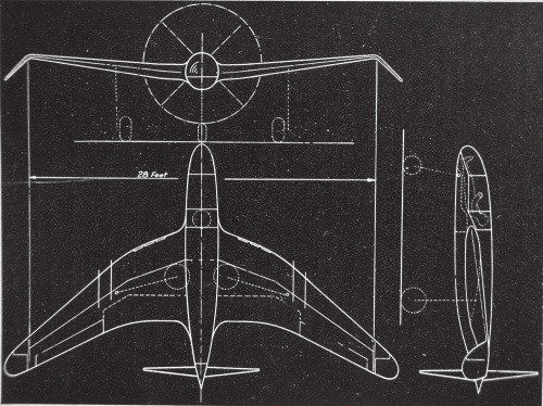

Can someone please ID the 3-view project depicted in the top cover? British or german?

I wish I had seen this thread before ordering this.
Lots of common myths repeated like the Tunnan and Mig-15 being Ta-183 knock offs and a large section about saucers/nazifos. The assertion that CIOS reports on the Hortens were biased against them and intentionally overly critical of their work. Oh and that the 262 must have been swept wing from the get go, because Willy wouldn't have started off with a straight wing design that was changed to swept.
But the most humorous line from what I've skimmed has to be this; "Of Alexander Lippisch we cannot deny that his 1930s delta and swept-wing experiments informed the Messerschmitt Me 163, and the Me 262." Yeah, I'd say his work 'informed' the 163 a bit....
1938 B.S. Shenstone design

sienar said:
Interesting tailless project! Thank you for sharing Sienar!
Is there more information available about this particular project, or other BS Shenstone tailless aircraft projects?
Slightly out off the "Bookshelf & marketplace" thread, Sorry

Cole's text no more than mentions Shenstone's design. Cole was in touch with the Shenstone family and drew on his personal archive, which seems to be where this blueprint came from.
To be fair to Cole, he has friends-and-relations ties in various high places and his gushing "I'm a popular journalist now" writing style masks a fair amount of original research and useful insights. Reimar Horten's work on yaw stability via control of sideways flow is one example where his discoveries are still coming to light and at last being integrated with Prandtl's work to create wholly clean and stable tailless designs such as NASA's Prandtl-D series of RPVs.
Due respect to Northrop, but he never got it wholly right and even with vestigial fins the big postwar bombers suffered handling problems, especially with pitch; it took computers to brute-force the B-2 into stable flight. Lippisch suffered the same struggle; his tailless Me 163 was an even worse handful. Others of Cole's darts aimed at established lore also sink home - if only he didn't exaggerate them worse than his targets have and then repeat endlessly.
What I do find interesting is how de Havilland interviewed Reimar before embarking on the DH 108 Swallow, and were also informed by Dunne's original certified stable tailless swept designs. Although Cole is unaware of the story, the old man used to tease his employees that Dunne had got it right all those years ago, so they better had too. The DH 108 flew well, only losing the plot when huge transonic forces of unanticipated amplitude appeared at the very top of its speed range, triggering violent flutter - a fault echoed by most tailed jets capable of such speeds. As DH wrote to Dunne, "The sensitivity in pitch is there, but not unduly so".
The thesis that Shenstone was a crucial player in shaping not only the Spitfire wing (the subtleties of which are also being rediscovered) but also British aircraft research in the mid-Twentieth century, indulging in influential industrial espionage when working abroad, also has more than a grain of truth to it. Note too just how many historic photographs, some published for the first time, come from the Shenstone family archive.

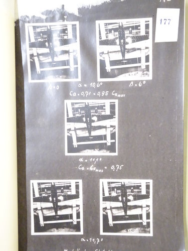

Ref Me262 with initially straight wings, I think this is now accepted, but for general interest here is a photo from 1940 of "P1065" wind-tunnel model.
Source: Imperial War Museum: File # GDC-15/615 - Messerschmitt AG file, by Dr Winter. (no idea myself who he was... but anyway....).
Image quality is c**p beacuse I took it myself. ;)

Thank you Calum. Two photos exist of the straight wing F-86 which was modified after German technical information was received. The Americans captured a Mach 4.4 wind tunnel at Kochel. The British interrogated the Horten brothers twice. Alexander Lippisch worked for the Collins Radio Company in the US post-war. Significant portions of what was found by the British T-Force (T for Target) still remains classified. T-Force, for those unfamiliar, operated in any area it chose under the cover name 30 Assault Unit, or No. 30 Commando. It would go into areas where the shooting was still going on in order to recover documents and equipment before they could be destroyed.

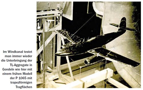

In Flugzeug Classic Extra september 2019 there is a photo of a P 1065 windtunnel model with straight wings:
