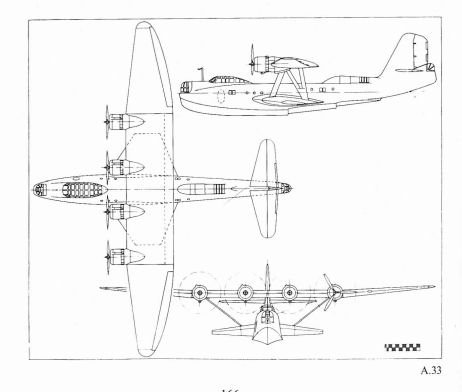

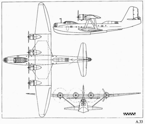

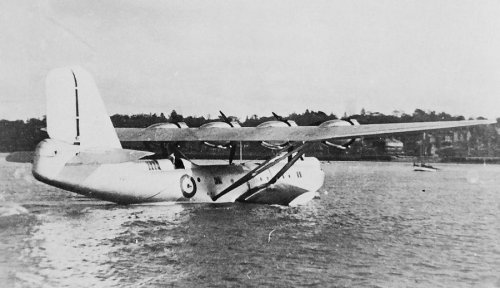

Does anyone have any good pics of the Saro A.33 flying boat to the same R.2/33 Specification as the Short Sunderland?
Here the "great" airplane : the incident of K4773 was reason of end of development of Saunders-Roe A.33
so watching on :
http://en.wikipedia.org/wiki/List_of_Air_Ministry_specifications
specifications of R.2/33 was awesome for Short Sunderland and Saunders-Roe A.33
So A.33 was less lucky :)

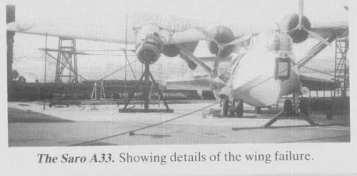

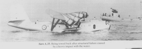

The A.33 is covered on pages 162 to 170 of Saunders and Saro Aircraft since 1917, Peter London, Putnam 1988.
The section has seven photos of the A.33 (three of the aircraft after the wing failure) and one of Saro Cloud K26881
modified to test the Monospar wing and sponsons of the A.33.
The 3-view and photo posed by airman are both in the Putnam.
The wing failed after the aircraft hit the wake of a Southampton ferry while on a take-off run, the A.33 began to porpoise severely,
porpoising was a problem with the aircraft, the A.33 leapt into the air and came down out of control in a stalled condition. At impact
the wing failed in torsion at a point inline with the starboard inner engine which caused the starboard leading edge to pivot around
the single-spar driving the propeller into the fuselage and sponson, missing designer Henry Knowler by inches.
Jon

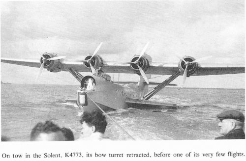

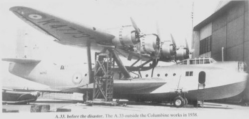

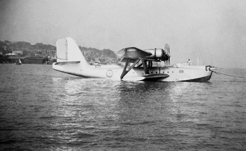

Photos of the A.33 from Tagg/Wheeler "From Sea To Air" :
Re: Saunders-Roe A.33 flying boat prototype......

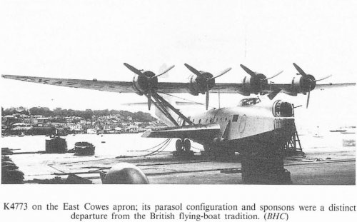

As far as I can tell, the A.33's wing was only supported by those angled struts from the "seawings". Is it any wonder it collapsed under stress? Does any one have any air-to-air shots?

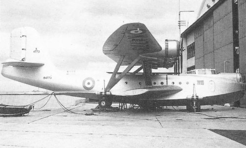

Dear Boys & Girls, here is an image I had found of a book jacket showing the A.33 prototype. Sorry I can't remember where the image came from, but look at all that thin air between the fuselage and the wing......
Terry (Caravellarella)

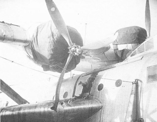

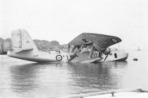

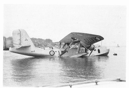

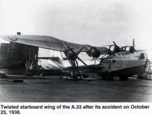

Taxiing trials of the prototype (K4773) was started on 10 October, 1938.
First flight was made on 14 October, 1938.
Take-off was uncomfortable due to porpoising tendency.
The damage was made during its fifth take-off on 25 October, 1938. The aircraft hit the wake and lose control. The starboard inner airscrew penetrated the hull and starboard sponson. The tail was damaged by flying debris of the wing.

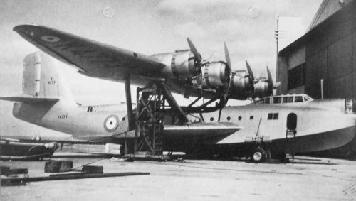

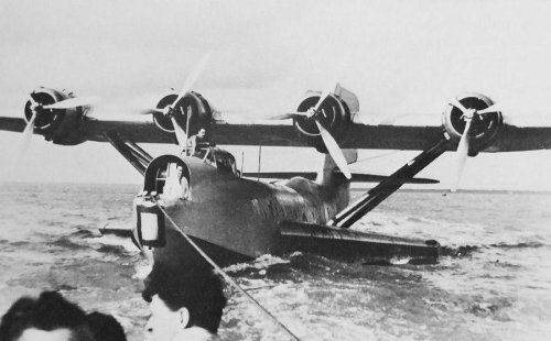

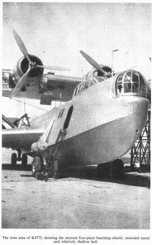

Four additional pictures of the beautiful A.33:
joncarrfarrelly said:
At impact the wing failed in torsion at a point inline with the starboard inner engine which caused the starboard leading edge to pivot around the single-spar driving the propeller into the fuselage and sponson, missing designer Henry Knowler by inches.
I trust he was suitably scared enough for a new pair of trousers - adequate punishment for screwing up the design!! Actually that's the good thing about large aircraft - you can put the designer aboard for the first flight and carefully watch their face on takeoff. If they're either too happy or at all scared, you know to say your prayers. ;D
I think I would have added a dorsal brace, to be sure, to be sure...
Does anyone know the purpose of the dorsal fairing just forward of the vertical tail? It looks like something pasted onto an existing design as an afterthought, not part of a new prototype.
Two beam positions under sliding hatches in the large dorsal hump forward of the fin were to be armed with single, pillar-mounted Vickers K guns.
From 'Saunders and Saro aircraft since 1917' by Peter London, Putnam 1988.
The aperture is visible in pic 'Saunders Roe A33 Flying Boat-04.jpg' as posted by Stéphane.
I wonder if the porpoising had anything to do with the fact that its beam gun positions are well aft (doubtless because of that high strutted wing; the Sunderland had its at the wing trailing edge much further forward) AND it has a tail turret (though that seems to be fitted for but not with in these pics), so its CG is going to be somewhat rearward, or just the hull shape, or a combination of both.
Does anyone know if there was a formal investigation into the torsion failure of the wing spars? Or was the stall-crash of the sort that any reasonable wing would fail?
According to Peter London, the A.33 was probably never fitted with a tail turret. In the same book, he describes porpoising in the Saro A.36 Lerwick. Saro seemed to have developed a knack for porpoising by design; then again, maybe just bad luck.
What was the estimated performance compared to the Sunderland?
'British Flying Boats' (Peter London) has a picture taken after the accident. "Failed in torsion" is a fair description of the damage to the wing... ;)
