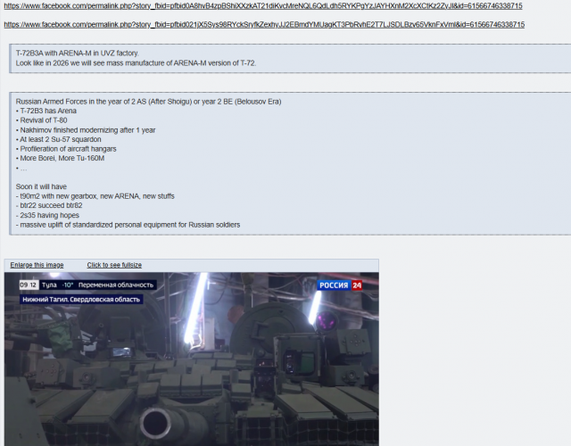

Presumably this mean Aramata is dead?
Not necessarily, but at the very least the T-14 aspect of Armata will have to be modified for the Arena instead of Afganit before entering service so that's yet another investment and delay.
At this time it would make no sense to invest further in the Armata given some much higher priorities especially in air power that are naturally resource intensive.
The Armata could also feed technologies to the T-90 and T-80 projects.
Even if they remove the counter ATGM/RPG capability, i.e. fast target detection and tracking, and stick only to slower drones to make this system serviceable, that would be a major boost and an important first step.
And it would also mean no more barntanks when it's equipped.
Given numbers of FPVs, it hardly means anything. Until and unless there's some more suitable hardkill solution, which can't be easily overwhelmed, this is literally worse than cope cage, even if works properly.
