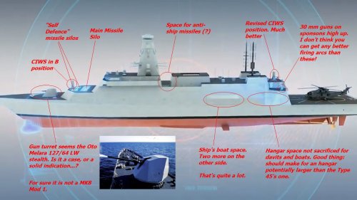

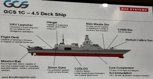

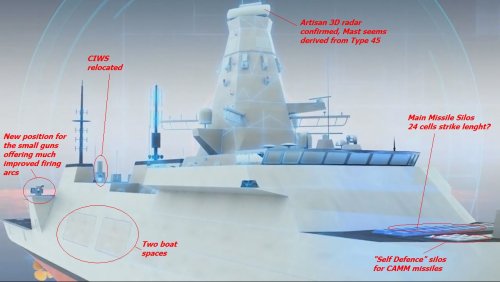

This CGI is from BAE website, the notes are mine (sorry, in spanish...). In the same site ('Media' or something like that) you can find other high resolution renders.
This other was posted some time ago in Warship1 forum:
Regards
No problem ;)
Cañón de 127 mm = 127 mm gun
Silos para missiles crucero = cruise missile silos
¿lanzatorpedos? = torpedo tubes?
lanzaseñuelos = decoy launchers
hangar principal = main hanger
hangar auxiliar (varios UAV) = auxiliary hanger (several UAV)

Two interesting features in these renders, to my eye:
1) The platforms sticking out at the aft end of the hangar are apparently there to give wider arcs of fire for the 30mm guns, which can shoot directly forward now. They could not do so in more conventional midships installations.
2) The anchors are not recessed or concealed, making them rather large RCS reflectors. That seems odd given all the covered openings and surface alignment seen in the superstructure.

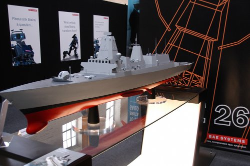

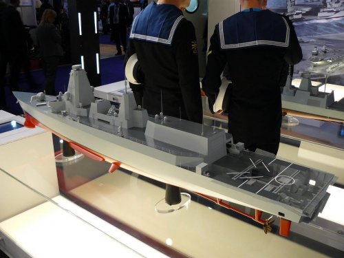

Model of BAE Systems Modular Sensor Suite for Global Combat Ship (Type 26) on display at Euronaval 2012.
http://www.cloob.com/club/post/show/clubname/TjHIzaT_NezaMI/topicid/2424272
The gun's changed again - it seems to be a Mk45, rather than the Oto-Melara weapon. The revised CIWS position makes more sense for some operational reasons, and they've fixed those turbulence generating sponsons aft. Interestingly, the mission bay has been rearranged and now, I suspect, wraps around the hangar, with the ship's boat to port rather than starboard. As an aside, I *think* that the old mission bay layout was actually published in Warship Tech. recently as an unspecified example, but I'm not involved with the project so it's a bit of speculation on my part. I could post here later.

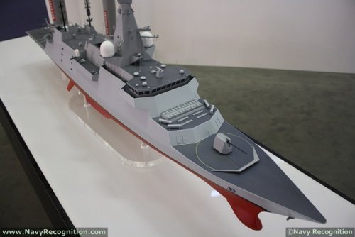

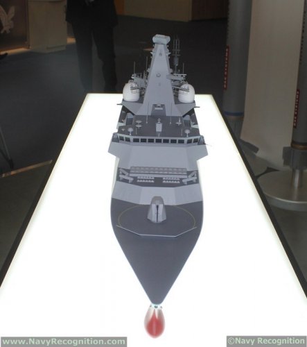

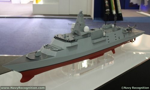

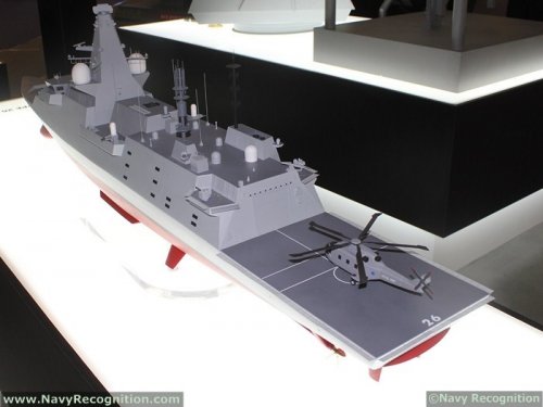

Model of BAE Systems Type 26 Frigate design on display at Euronaval 2012.
http://www.navyrecognition.com/index.php/home/naval-exhibitions-pictures/euronaval-2012.html?AG_MK=0&AG_form_paginInitPages_653=1&AG_form_albumInitFolders_653=west_europe/france/exhibition/euronaval_2012/pictures/Scale%20models&AG_form_scrollTop=966&AG_form_scrollLeft=0&AG_MK=0

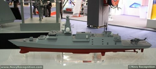

You may be right, by comparison to the EH 101 the Type 26 would have a length of
around 170 m. I would guess, they just used an "off-the-shelf" model of the Merlin,not
exactly to scale to the ship model ... ::)
