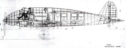

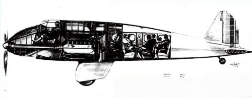

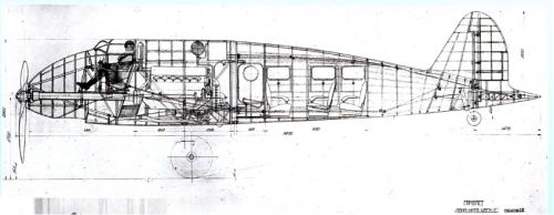

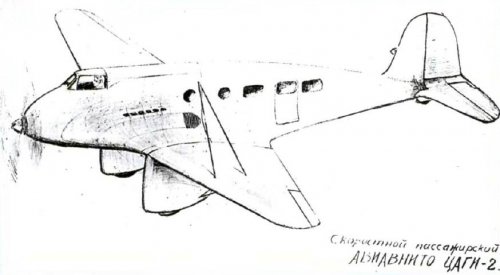

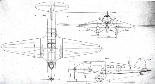

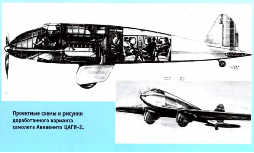

There definitely is confusion.
RG-1 was light aircraft aviette (1929)

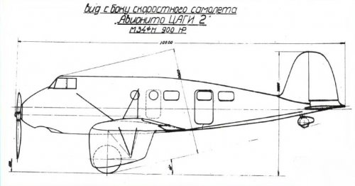

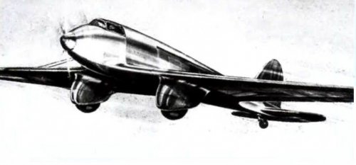

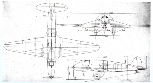

In this case, the description fits (with a probability of 98%) under the project high-speed passenger aircraft by Romeiko-Gurko with Kamenomostskiy and Nikolaenko submitted to the contest Aviavnito.
Aviavnito TsAGI-2 data:
engine: 1 - M-34FN 900hp.
span: 15m
lenght: 10,5 m
height: 3,2 m
ar.wing: 32m2
Courtesy of M. Maslov

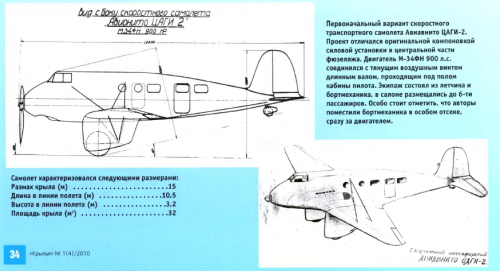

Thank you my dear Borovik very very much,
and for Aviavnito,I think it was a for Kharkov.
The same views with text and one drawing add,from Kryl'ya 2010.
