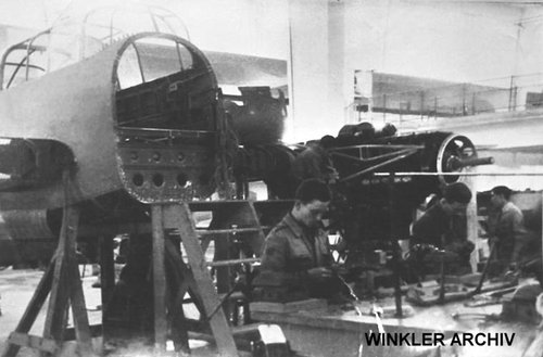

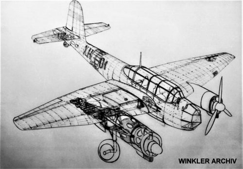

The Varga RMI-1 X/H illustration on Balaton-Modell is not correct for the re-engine version (with the DB605) because in the illustration the engine cowlings are for a radial, air-cooled engine, when the DB605 was a water-cooled V type engine. This would have had exhausts going in a row down each side of the engine, as in the photographs of the workshop.
zanenobbs said:
The Varga RMI-1 X/H illustration on Balaton-Modell is not correct for the re-engine version...
Correct. The Balaton-Modell image appears to illustrate the RMI-1 X/H prototype as originally fitted with the Jendrassik Cs-1 turbines.
Thank you, however, with the turbine shouldn't there be an exhaust at the rear? My understanding is that the Jendrassik Cs-1 turboprop had a rear exhaust similar in appearance to that of the Campini-Caproni CC.2 engine or the Junkers Jumo 004s and BMW003s. Is this not correct?
Quite right, and well spotted. Obviously that image was a botched attempt at representing the DB605 conversion ???
I've eliminated that link.

This is the International Resin Modellers Association fourth kit. You can find the history here: Articles 13 Varga RMI-1 X/H ( ), the build here: Articles 14 Building the 1/72 IRMA Kit No. 4 Varga RMI-1 X/H ( ), and pricing at the IRMA On-Line Store ( ). From my research, it looks like the Varga RMI-1 X/H was actually never re-engined with a DB 605. None of the existing photos display the DB 605 exhausts and in the wreckage photos, there is no sign of the DB 605 with the RMI-1 X/H. The DB 605 is present in the Varga RIM-2 X/G wreckage.
From the Winkler Archiv photo, found online and also in the book A Magyar Királyi Honvédeség Fegyverzete on page 437 (lower right), the aircraft in the Varga Workshop is NOT the RMI-1 X/H, rather it is the RMI-2 X/G. Notice in the photograph that the horizontal windowpanes line up across the canopy, yet in the drawings and illustrations for the RMI-1 X/H, the horizontal windowpanes do not line up, instead they form a pattern of -_-_--- while those of the RMI-2 X/G are -------. The airframes for the X/H and X/G were nearly identical, save for differences to accommodate the engine types and landing gear.

With all due respect, the drawing in A Magyar Királyi Honvédeség Fegyverzete on page 436, is not the Varga RMI-1 X/H, although it is labeled as such. The RMI-1's landing gear retracted inward, while the RMI-2 X/G's retracted into the engine nacelles. I'm finding this book and the Winkler Archiv to be increasingly questionable.
