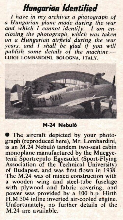

BL-8 was also two-seat biplane trainer airplane,looks like BL-7,or developed in parallel with it.
M-23 was a glider as I think.
EM-31 Kotlós was a four-seat twin engined tourist airplane,never completed.
EM-32 Kóbor was a two-seat twin engined tourist airplane,also never completed.

From Hungarian magazine.

I have you add the new discovered to the list.

Have done hesham. I also took the opportunity to re-format (for clarity) and add a few more details and links.
I can't make much headway with your clippings in Google Translate. I suppose we must wait for a willing Hungarian reader in order to glean more details.
