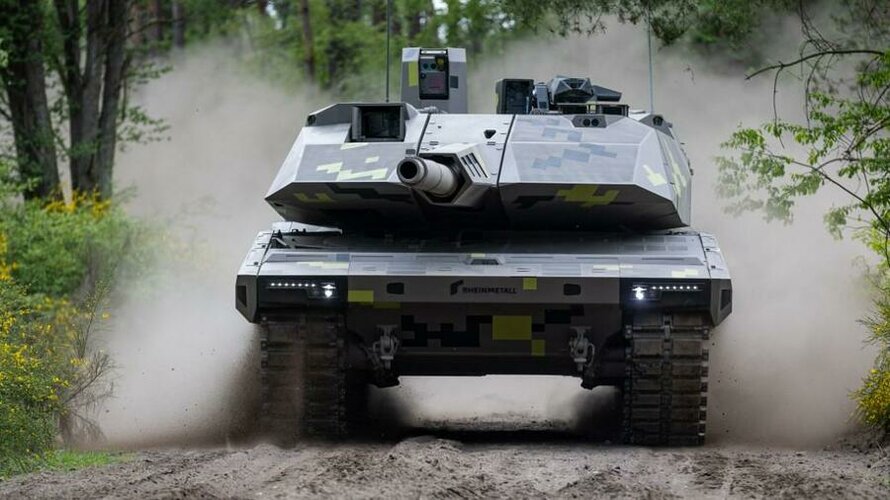

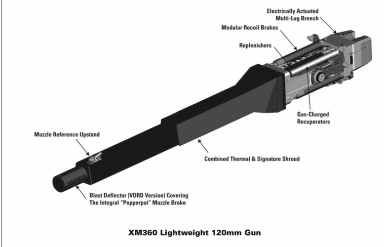

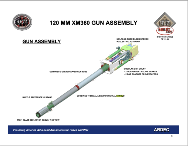

Can someone please tell me what the partial 'shroud' around the main armament barrel is and what it does?
It could be for blocking the hotter part of the main gun barrel from both the tank own and enemy thermal vision systems
No doubt similar reasons to the XM360, thermal management and environmental protection of the barrel.

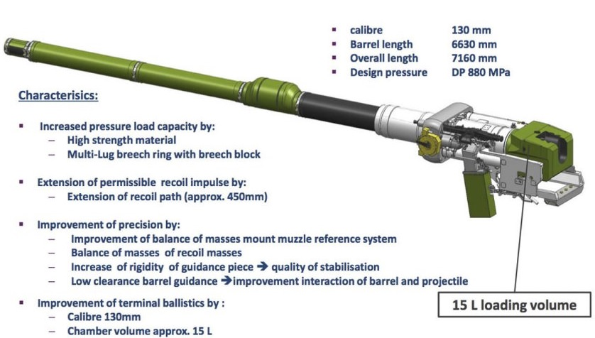

The diagram is correct. This was the gun as shown in Eurosatory 2016.
https://rheinmetall-defence.com/en/...ons/news/archiv/archive2016/index~1_10496.php
For the KF-51 Panther, Rheinmetall must have decided to make it a bit longer.

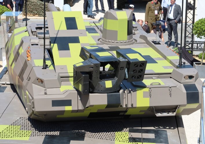

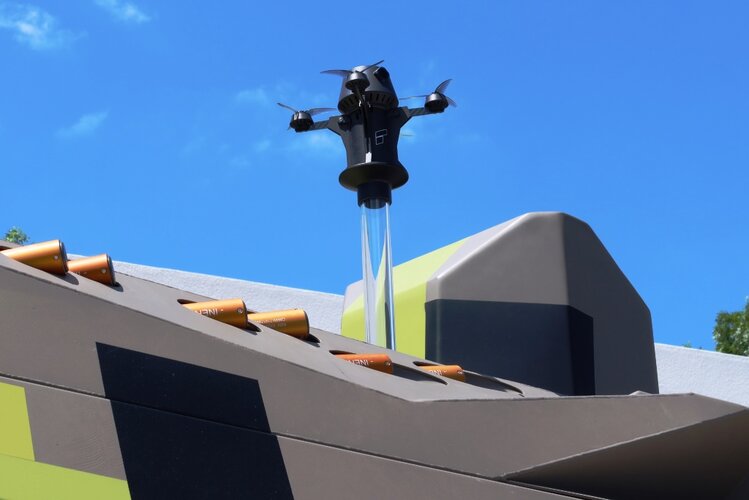

The KF-51 has an integral short-range air reconnaissance capability, two small UAVs with a few kilometers operational range and 30 min endurance. They are housed on each side of the turret and launched at will to recon the area ahead of the MBT.
Also interesting is the modularity of the 2 magazines each housing 10 rounds. For Eurosatory 2022 one was replaced by one with four UVision HERO 120 loitering munitions which are apparently being fired by the main 130 mm gun.

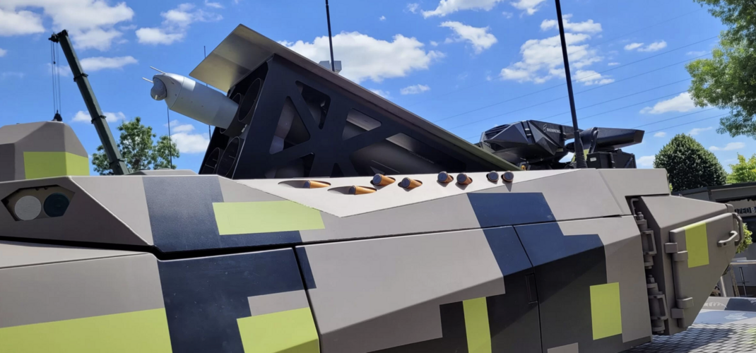

The model clearly shows tip-up launchers for the Hero munitions.
