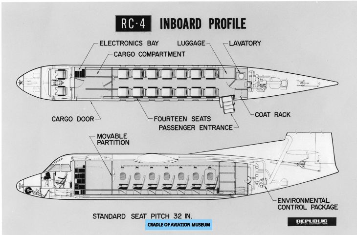

Two more puctures from
Cradle of Aviation Museum
That's first time I see project of this aircraft, another item in "RC" (Republic Commercial") line, incuding SeaBee RC-1 and RC-3
