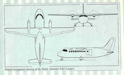

the Pacific Airmotive Corporation designed the PAC-1 a commuter
airliner aircraft Project,it could carry 28-seat and powered by two
680 hp P&W PT6A-27 turboprops.
http://www.flightglobal.com/PDFArchive/View/1969/1969%20-%200538.html

This is typically a three-view drawing from Air International.
