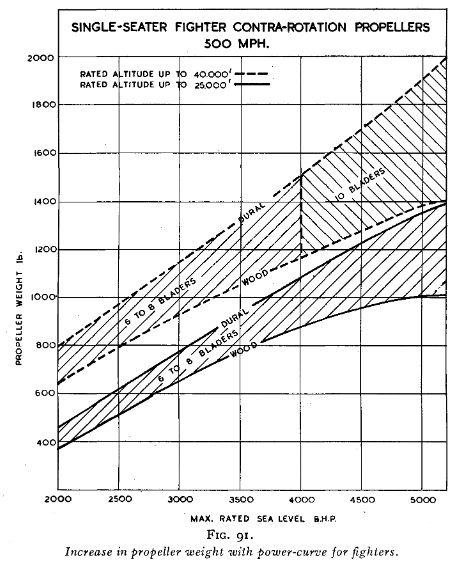

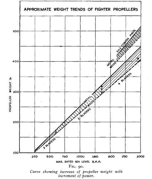

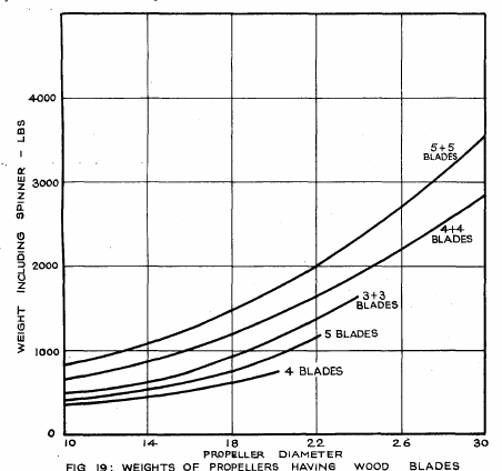

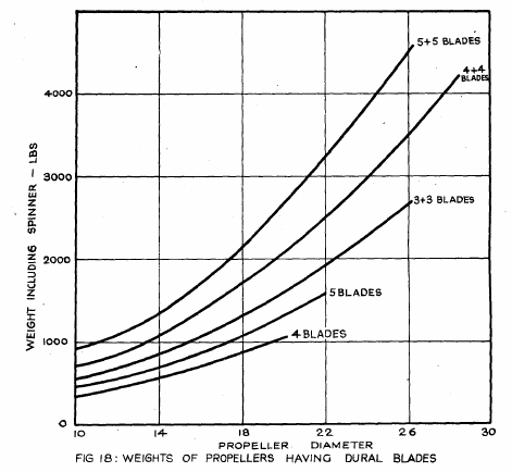

Is it worth the weight?
contra prop weight.png fighter prop weigth.png propeller dural weight future scope of props fairhurst 45.png
Keep in mind that a contra-prop is adding side area ahead of the CG which leads to reduced yaw stability, ie an increase in vertical area or arm will be required.... which means a further increase in weight.
Consensus during the 40s seems to be that for sub-3000 hp contra-props aren't worth it.
Is going from a 4 blade to a 3+3 blade worth an extra ~100lbs on the 13-14000lb Jug? It may very well have been if the additional thrust was great enough but we may never know. Although yaw stability is a valid concern, overall yaw characteristics will be improved IMO. I know the bubble canopy P-47s ultimately led to the addition of a dorsal fillet to compensate for the lost yaw stability of the Razorback yet nobody is looking back on that decision
Thanks a lot for the interesting graphs!
I think yaw stability is actually an important point. Somewhat ironically, contraprops also help to improve yaw control as the effect of power and speed changes are much less pronounced due to the reduced overall rotational inertia of the main slipstream.
That adds qualitative benefits to the potential quantitative performance benefit of the contraprops: Low speed handling characteristics are much improved, making operations safer, and when we're talking about a fighter aircraft, it might also be easier for the pilot to keep the aircraft from yawing while firing at a target, which makes the aircraft more effective as a weapon.
How much properly coordinated flight improves gunnery is evident from the priorities of the late-WW2 Luftwaffe - they intended to fit a lead-computing gunsight on every fighter - and a yaw-damping system. (Not contraprops, but the goal was the same.) Here's more on the background: https://www.secretprojects.co.uk/threads/messerschmitt-me-p-1101.15737/page-2#post-611161

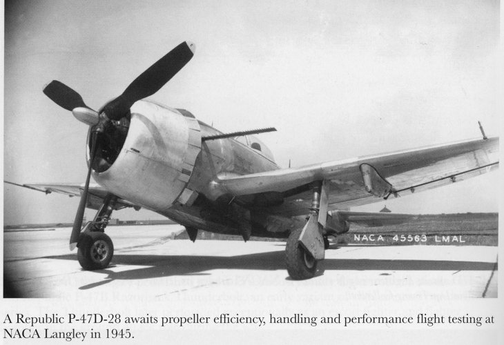

something I forgot to add, the P-47 at 72" of MAP was good for 2800hp, but there is evidence that they ran more power than this in combat. At minimum the P-47Ms got juiced up to a documented 76" (to their apparent detriment) and I've heard more than one tale of Jugs running 90-100 inches of mercury in the direst conditions. the R-2800 is easily past 3000hp at such a setting. Republic tested the R-2800 on an engine stand at 3600hp for some 250 hours straight
Given that the toothpick prop P-47 was some 20mph faster than the paddle prop version, and the contra-rotating "double twister" was ever so slightly faster still with I would assume a dramatically improved climb, I do wonder how fast the Jug might have sprinted and climbed running those mega horsepower numbers through twin props

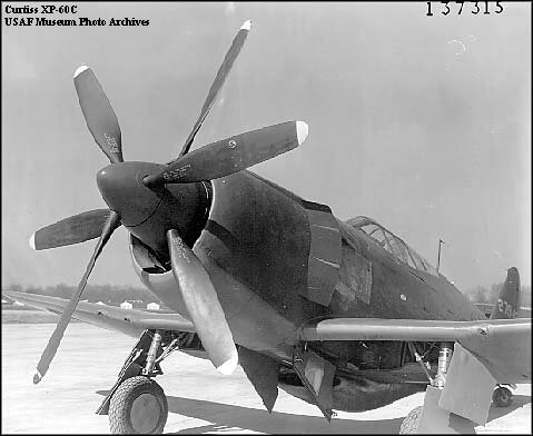

Regarding the contra-props for the P-47-
the Curtiss XP-60C from Jan '43 with its R-2800 and twin contra-rotating propellers
conv
I wonder what was the story with this engine and propeller combination in this plane or another
I doubt that the combination was especially successful. The succeeding P-60E used a conventional propellor with the R-2800. If a simpler. lighter, cheaper, more readily available four-bladed standard propellor could handle the R-2800's power, the contrarotating type would not seem to offer any advantages.,

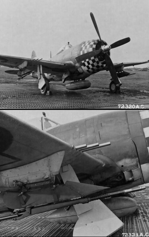

Probably a P-47 could have carried at least 6 but it would have required a redesign of the wing internals and I don't think it was ever a priority.
6 fifties of the new M3 variant had the firepower of 8 of the old M2 guns. That would make the P-47 lighter and maybe increase its roll rate since the outer 4th gun and its ammo would be deleted. The XP-72 was to carry 6 M3 guns or 4 37mm cannons.
Maybe, but in practice P-47 pilots always elected to carry 8 guns, even when allegedly some P-47Ns received the M3 in the final days of the war. There's no such thing as overkill!

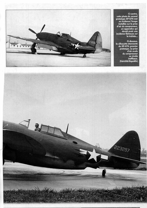

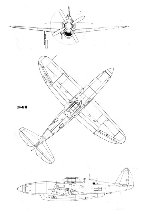

https://planehistoria.com/was-it-any-good-the-xp-47h-an-experimental-p-47/

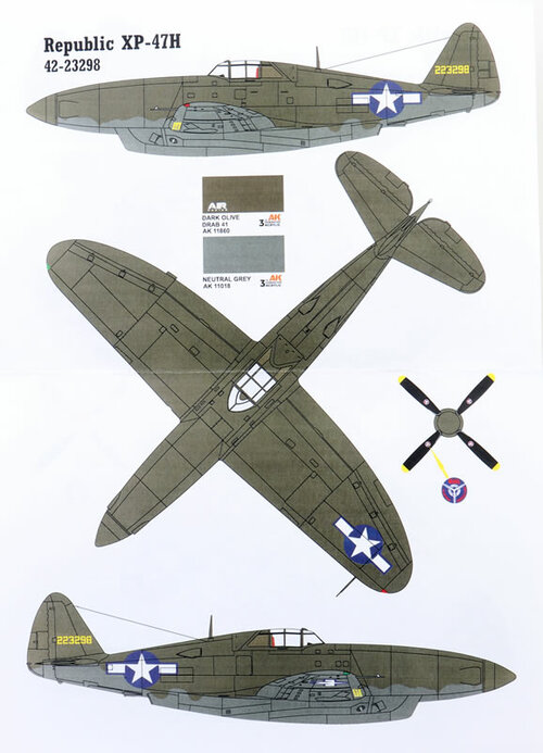

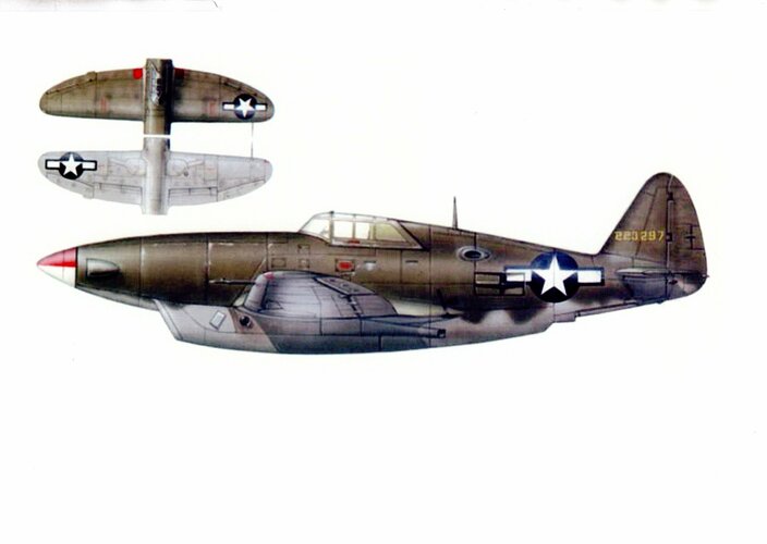

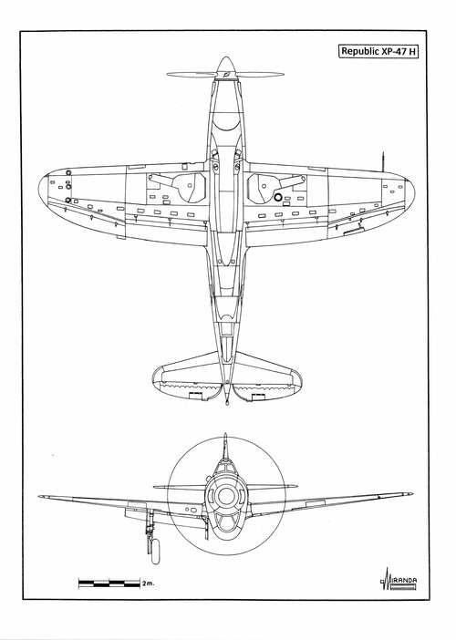

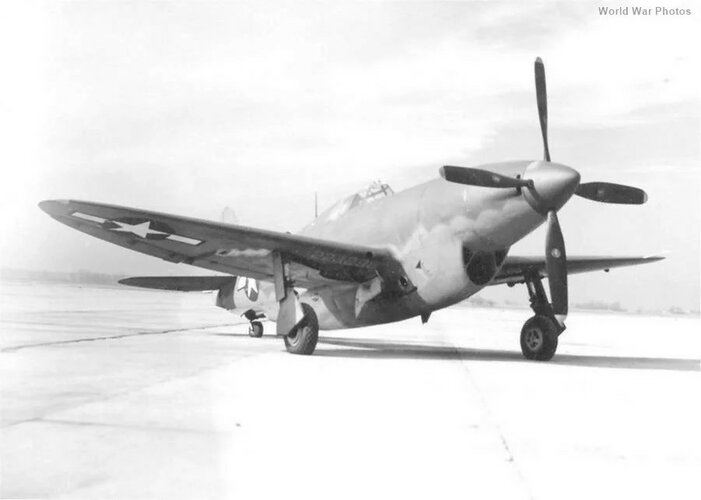

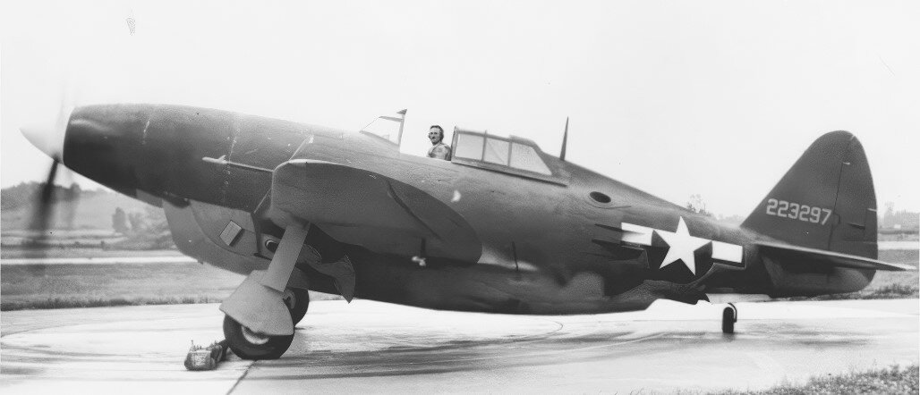

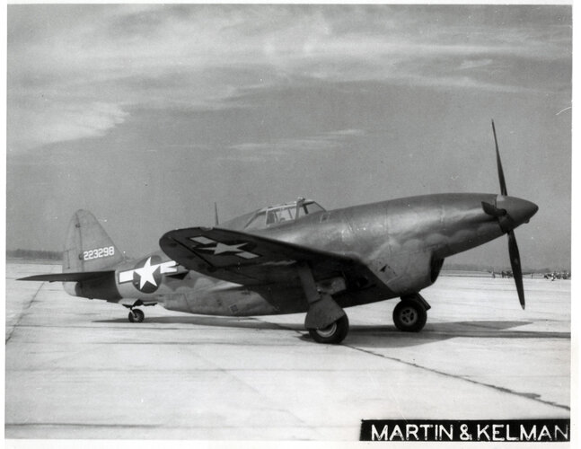

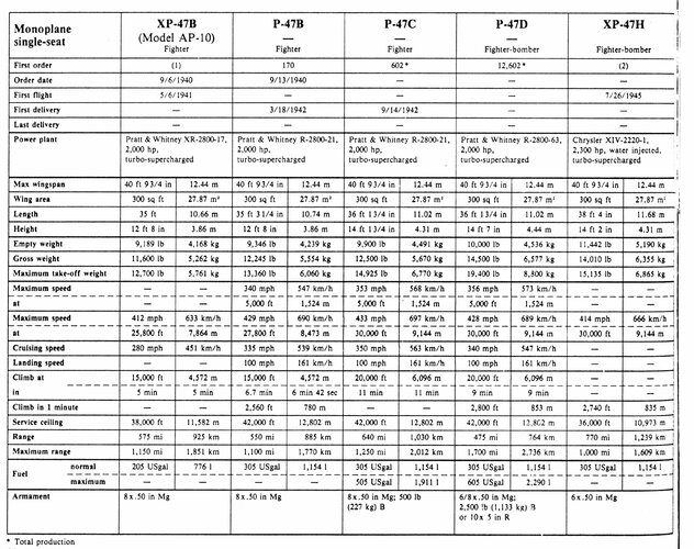

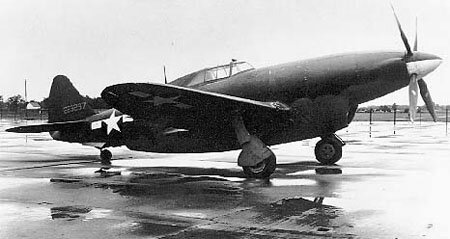

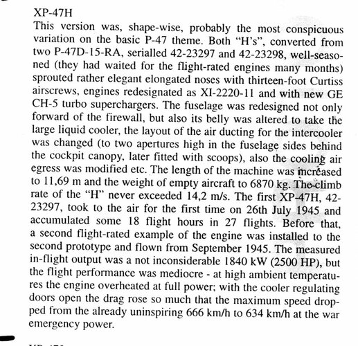

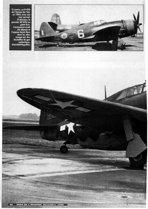

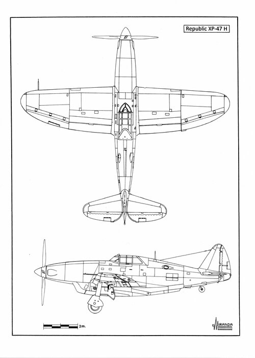

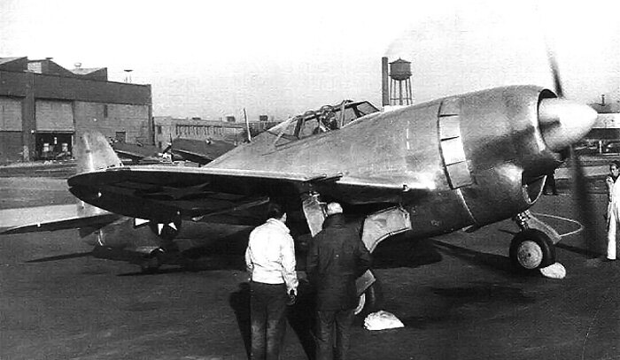

”The Republic XP-47H​
The Republic XP-47H was another experimental variant of the P-47 Thunderbolt, designed by Republic Aviation to explore the performance limits of piston-engine fighters during World War II.
The XP-47H, much like the XP-47J, was developed with the intention of achieving higher speeds and improved overall performance compared to the standard P-47 Thunderbolt models.

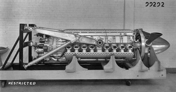

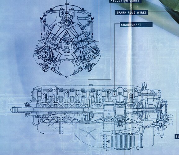

That Engine​
In the early stages of 1940, observing the unfolding air combats over Europe, Chrysler anticipated the imminent demand for more potent power plants and embarked on the development of a substantial new liquid-cooled engine, subsequently named the Chrysler XIV-2220.
The engine, which was envisaged to meet the burgeoning needs of the time, promised a remarkable output of 2,500hp, a feat quite impressive for the 1940s.
In a bid to theoretically simplify the intricate process of constructing such a formidable engine, Chrysler opted to merge two V-8s together inline, crafting an inverted sixteen-cylinder engine spanning ten feet in length.
Big Exceptions – Poor Results​
Optimism permeated the expectations for the XP-47H, as despite the substantial size and weight of the XIV-2220 and its accompanying intricate and hefty turbo-supercharger, predictions suggested the aircraft could achieve speeds exceeding 490 mph (approximately 790 km/h).
Performance Shortfall: It recorded a maximum speed of 414 miles per hour(approximately 667.5 km/h) during testing, far short of the expected performance gains.
Consequently, the aircraft, powered by the Chrysler engine, didn’t experience its inaugural flight until late July 1945. In a succinct testing program spanning a few months, the XP-47H demonstrated that extensive refinements and developments were still needed before it could evolve into a dependable service aircraft."

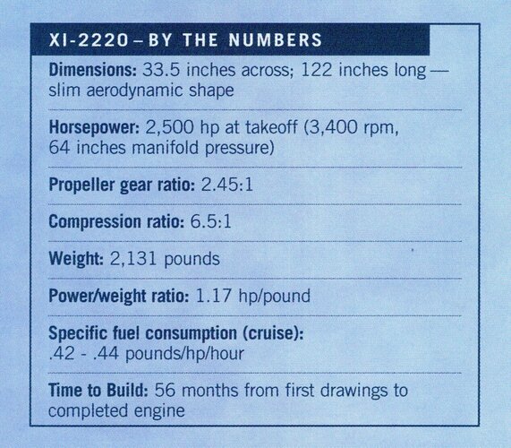

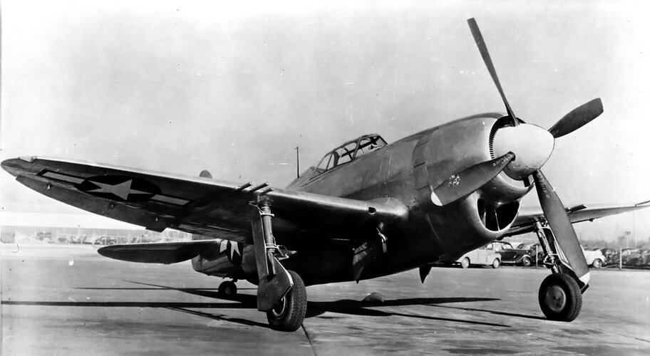

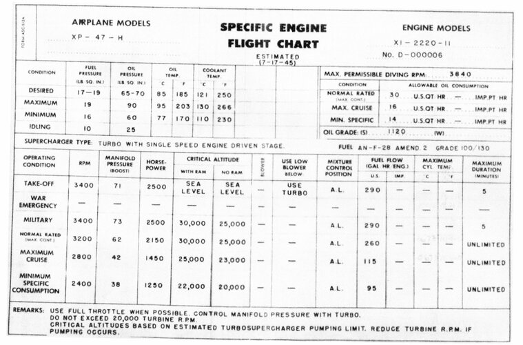

In late 1943, two P-47D-15-RA fighters were fitted experimentally with the Chrysler XIV-2220-11, liquid-cooled, 16-cylinder, inverted Vee engine.
This 2,500 hp. power plant, with 122 in length and 2,131 lbs weight, drove a four bladed Curtiss Electric C-542 S-A propeller with 3.96 m of diameter.
A single speed GE CH-5 turbo-supercharger was placed aft the cockpit.
The prototype XP-47H (42-23297) was flown on 26 July, 1945 showing poorer performance than the P-47 D standard.
Chrysler engine failed to reach production and work on the XP-47H ended.
Republic XP-47H technical data
Wingspan: 12.44 m (40 ft-10 inch), length: 11.68 m (38 ft-4 in), height: 4.31 m (14 ft-2 in), wing area: 27.87 sq. m. (300 sq. ft), max weight: 6,355 kg (14,010 lbs), max speed: 666 kph (414 mph), ceiling: 10,973 m (36,000 ft), range: 1,239 km (770 mls).

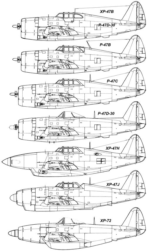

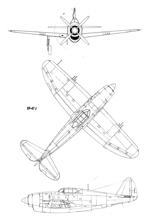

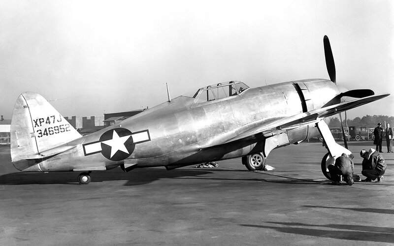

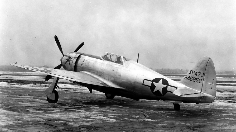

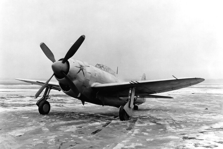

Hi! XP-47J.
https://oldmachinepress.com/2013/12/17/republic-xp-47j-superbolt/
「In mid-1942, Republic Aviation Corporation initiated a design study to lighten their P-47 Thunderbolt fighter for improved performance.
Republic officially proposed a light-P-47 to the Army Air Force (AAF) on 22 November 1942. On 1 April 1943, the AAF gave Republic a letter of intent to purchase two light-weight P-47s, and the contract was officially approved on 18 June 1943. This new aircraft was designated the XP-47J.
Originally, the AAF wanted the XP-47J to have contra-rotating propellers and a bubble canopy, like a late P-47D. To expedite the XP-47J, the decision was made for the first prototype to be a razorback version and the second prototype would include a bubble canopy. The six-blade contra-rotating propeller was test-flown on a P-47B but showed no increase in performance. This, combined with delays at P&W on the R-2800-61 engine with a contra-rotating gear reduction, resulted in the substitution of a R-2800-57 engine with a standard gear reduction. Both the -57 and -61 engines were rated at 2,100 hp (1,566 kW) and had a War Emergency Power (WEP) rating of 2,800 hp (2,088 kW). The -61 engine would be supplied later, when it was available.
On 31 July 1943, Republic issued a report comparing the estimated performance of the XP-47J with the P&W R-4360-powered XP-72 that was under development. The report concluded that the Republic XP-72 had more potential and recommended resources be focused on that aircraft. In addition, 70% of the P-47 production line needed to be re-tooled in order to produce the P-47J. Republic called for the cancellation of the second XP-47J prototype but encouraged the completion and testing of the first prototype. The AAF approved Republic’s plan and cancelled the second XP-47J.
The sole XP-47J prototype (serial number 43-46952) was completed in mid-November 1943 and made its first flight on the 26th of that month.
On 11 July 1944 and equipped with a General Electric CH-3 turbosupercharger, the XP-47J achieved 493 mph (793 km/h) at 33,350 feet (10,165 m). Although the engine was producing 2,800 hp (2,088 kW), Republic believed the aircraft had more potential. At its own expense, Republic installed a CH-5 turbosupercharger and a larger 13 ft (3.96 m) Curtiss propeller. The propeller was an experimental unit with 2 in (51 mm) added to its trailing edge to increase its width. With the changes, the engine producing 2,730 hp (2,036 kW), and 400 lb (1.78 kN) of jet thrust from the exhaust, Mike Ritchie flew the XP-47J over a calibrated course at 34,450 (10,500 m) feet on 4 August 1944* and achieved 505 mph (813 km/h). This is the highest speed recorded in level flight by any propeller-driven aircraft during World War II.
The Official Performance Summary report states the XP-47J had a max speed of 507 mph (816 km/h) and a 4,900 fpm (24.9 m/s) initial rate of climb. Republic’s Test Report No. 51 (27 January 1945) lists the max speed as 502 mph (808 km/h).」
You can see forced cooling fan located front of the engine in the first picture.
Surprisingly this fighter was faster than XP-72!
http://www.airwar.ru/enc/fww2/p47j.html

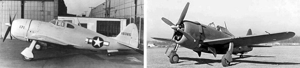

The XP-47J had a wingspan of 40 ft 10 in (12.4 m) and a length of 33 ft 3 in (10.1 m). The aircraft had an empty weight of 9,663 lb (4,383 kg) and a design gross weight of 12,400 lb (5,625kg). Its service ceiling was 45,000 feet (13,716 m). The XP-47J had a range of 765 mi (1,231 km) at a cruising speed of 400 mph (644 km/h) and a range of 1,070 mi (1,722 km) at optimum cruising speed. Fuel capacity was 287 US gal (1,086 L).
  • The pressurised XP-47E (left) and the XP-47F with its experimental laminar flow wing..jpg

The RAAF specified 2x20mm plus 2x50 cal in the NA-110 order. Changed to P-51D-5 with 6x50.
The Materiel Command was opposed to changing to another standard 20mm logistics imposition. The P-38 and P-400 were the only two - and the P-400 only because the Brits insisted.
NAA originally proposed 4x20mm for the X-73 but Army wouldn't release them until late 1941. The Mustang IA incorporated them per Brit request and they remained in the Mustang IA/P-51-NA when the AAF took over 58 of the 150 order.
The A-36 proposal had a variety of 20mm and 37mm combinations - AAF chose 50cal.
The XP-51F was contemplated as an Interceptor with 4x20mm Oldsmobile - AAF decided No.
I don't think the logistics of supplying more 20mm ammo or the necessary parts would have been a problem for the USAAF, but the fact is the American built 20mm Hispanos were having rather severe reliability issues. Tony Williams has written on this before but most if it seems to have been due to some minor dimensional changes made in manufacturing that caused a huge headache. The 20mm cannons also weren't being built to the same tolerances that smaller caliber MGs were because anything larger than .60 caliber (15.2mm) had different standards. That threshold being decided upon in a seemingly arbitrary manner. The mass-produced 20mm Oerlikon didn't have a problem here since it was a somewhat simpler and more robust design, but the lighter and faster firing 20mm Hispano needed very precise workmanship to function well.
The USAAF was also more interested in their project for a very high velocity .60 caliber MG than they were in 20mm autocannons. But despite trying to adapt both the Hispano and a reverse-engineered MG151 to that caliber they couldn't seem to get it to work well enough.
The USN had a greater interest and put a lot of effort into getting the 20mm Hispano functioning more reliably. Batches of F4U Corsairs had 4x20mm cannons and many prototypes also used it as a preferred armament. Post-war such an armament became their standard.
Generally speaking, American design of light autocannons was in a bad place in the pre-war and WWII years. The one notable exception was the 37mm Browning autocannons.
With regard to the .50" machine guns vs. the 20 mm cannon, Tony Williams found an interesting quote from the report on the Joint Fighter conference, which I re-quoted here: https://www.secretprojects.co.uk/threads/usaaf-0-60-caliber-machine-gun.14481/page-2#post-613158
With regard to the .60"machine gun, my impression is that the USAAF had unrealistically high expectations and was overly ambitious in its requirements. I guess the difficulties in developing the 0.60" machine gun simply were related to level of desired kinetic energy ... the 15 mm MG151 had around 27 kJ kinetic muzzle energy, the 20 mm MG151/20 around 30 kJ, but the 15.2 mm 0.60" machine gun generated 47 kJ. These difficulties could be and were overcome, but only years after the war had ended. And somewhat ironically, by that time the USAAF had reconsidered their approach, and the 0.60" cartridge was developed into a (very successful) 20 mm cartridge.
At least, they seem to have worked well enough :) I'm not sure they were anything special with regard to firepower per weight or per volume, but they certainly were important to USAAF planning, and were one of the cannon types used in the post-war ballistic trials, indicating that USAAF interest in the weapon was still high, which I'd count as a vote of confidence in the value of the weapon, including its usefulness for the future. The 37 mm shells turned out to be a bit more destructive against "hard" aircraft components than the German 30 mm mine shells that were also trialed, and less destructive against the "soft" aircraft components. (Which probably was just what one would have suspected anyway, but they proved it to a good level of statistical significance.)
Personally, I'd consider the failure of the USAAF to arm the P-47 (and the P-51) with 20 mm cannon a missed opportunity, but with the initial difficulties the US had with their version of the Hispano cannon, it was probably a reasonable decision by the USAAF to minimize risk and stay with the 0.50" machine gun that demonstrably worked reliably.
The logistics issue pointed out by Drgondog might well have been the final nail in the coffin, but I'd speculate that Material Command probably applied Army thinking to an air force context, in which complex technology and the likewise complex supporting logistics were the norm, and in which another calibre in my opinion wouldn't have made much of a difference.
Regards,
Henning (HoHun)
In my opinion, the armament of the Thunderbolt was excessive to combat the German fighters and insufficient to combat the German heavy bombers that were never manufactured. To shoot down a Bf 109 it would have been enough to have two heavy machine guns and to use the free space inside the wings to carry fuel.
