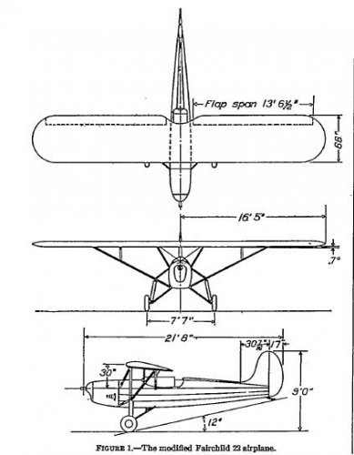

Hesham,
I think that the "Fairchild 23" is a typo (which reoccurs in NACA papers on the F.22 for some reason).
There was an F-23, but that was a postwar ag aircraft (a M-62/PT-19 rebuild/conversion with metal wings). D. D. Funk Aviation created one prototype F-23 (Warner Super Scarab?), 11 F-23As (Continental W-670-M), and 3 F-23Bs (Jacobs R-755B). Some F-23As were converted to 'B standard. A few ended up with Ford auto engines. The F-23 design later evolved into the new-built Weatherly.
BTW, the "Fairchild 23" listed as belonging to the Maharaja of Faridkot Trust is actually a F.24W
Hesham,
I think that the "Fairchild 23" is a typo (which is reoccurs in NACA papers on the F.22 for some reason).

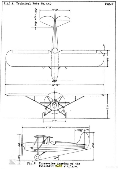

The drawing uploaded by @hesham also appears in a NACA document dated December 1932, and the caption for that drawing merely reads "Three-view drawing of the Fairchild F-22 airplane", in which case the caption for the drawing that @hesham posted mentions "Fairchild Model 22", not Model 23.
