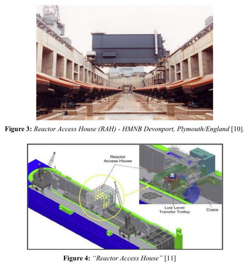

* The infrastructure for refueling is a Reactor Access House on rails that runs over the dock and is used to extract the spent fuel rods in a contained environment. The rods are then moved to a temporary storage pool, from where they can be shipped to France or other countries for reprocessing (as this is low enriched uranium, not military grade HEU). There is also additional safety infrastructure (eg. to handle reactor cooling) but this will need to be put in place whether or not the SSNs need to be refueled. IMG_3829.jpeg

Right, but you still absolutely need that refueling infrastructure, no matter how relatively easy the French design makes it.
If Oz doesn't have it, the boats gotta go back to France to have it done. So now you're without the boat getting refueled for an extra 6 months or so for it to go around. (~3months there and another ~3months back).
Agree. Having that infrastructure is extremely useful as it makes construction easier and safer. The fueling of the reactor can be done separately from the sub's reactor compartment construction and testing, and the fuel rod configuration can be tested in a completely separate purpose built facility prior to its installation in the sub.
The SSN-AUKUS approach, by comparison, would see a completed, 'sealed' reactor compartment, already fueled with 93%+ enriched uranium, delivered from the UK and integrated 'live' as it were, into the vessel under construction.
A fully-fueled reactor that would be delivered, via ship one imagines, having been craned into the hold of a specially chartered cargo vessel and probably escorted by RN or RAN warships, around the Cape of Good Hope (if the Houthis are still harassing cargo) and across the Indian Ocean to Adelaide.
I mean, you can see why the existing AUKUS plan is considered very high risk.
