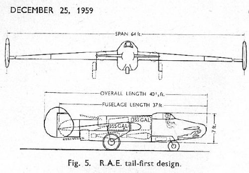

Maybe it was the basis for this.
http://www.secretprojects.co.uk/forum/index.php/topic,545.0/
The quote from Goulding and Moyes does not suggest that these RAE designs were of unconventional layout so it seems a little doubtful that they formed the basis for the later canard design study. However there are many similarities between this and Miles' patented Libellula configurations.
