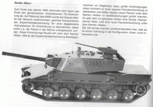

I'd just posted that last post and turned to look for Leopard 1A6. I didn't find it, but Waffensystem Leopard 1 und Leopard 2 by W.J. Spielberger has quite a bit on Keiler and Eber, including photos of drawings and a wooden mockup.
It is a Leoprd IIFK on Spielbergers picture. Also not EBER, not Keiler.

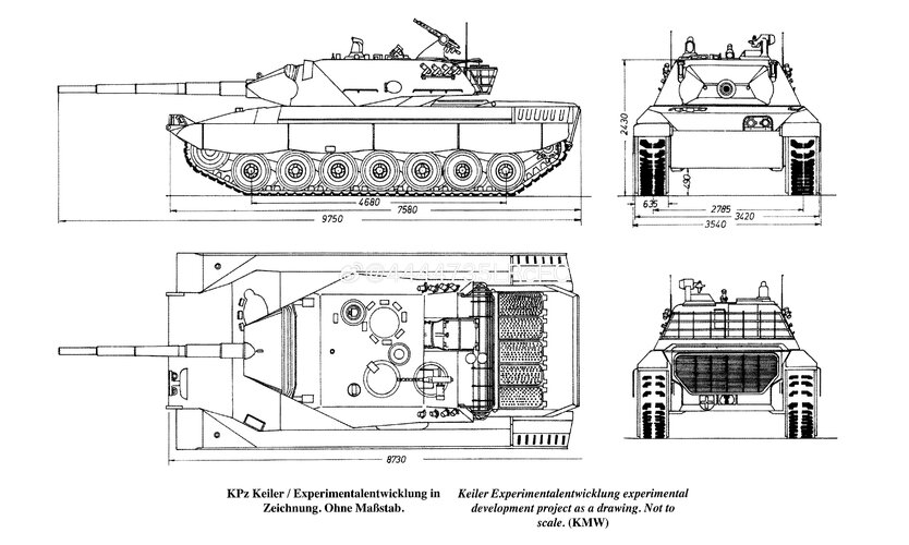

I found some more pics on a discord server, and I thought I’d share them. Here they are:
