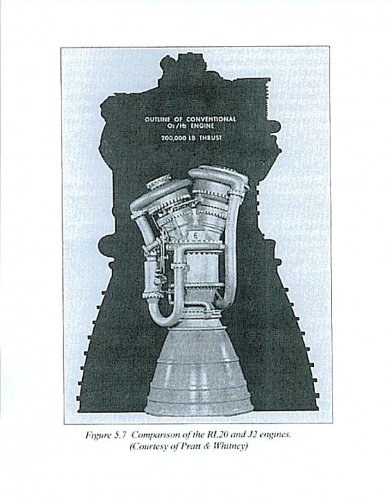

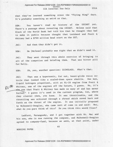

James A. Cunningham, of IDEALIST fame, mentioned that the vehicle was supposed to be an RL-20 engine (cited in the reference below). Pratt was conducting research on an evolutionary engine at the time, known as the RL-20 P-3. Many of the technologies in the RL-20 end up in the revolutionary XLR-129 (as per Mulready). Just wondering if Cunningham, who admits to having left before ISINGLASS got rolling, was involved in intial talks where the RL-20 may have been the initial proposed engine? Food for thought. Dick Mulready's book mentions that the engine was in development in 1963 and that it was shown to many high level government and DoD executives. It was also in the same thrust class as a J-2 (which was the proposed engine for the NASA hypersonic research model for a manned vehicle found earlier in this thread).
Also, can anybody cite the references for RHEINBERRY? The only two I know are the CIA document from the U-2 and OXCART histories, and the Bill Rose Military Space Technologies book. Are there any others?
Wait, what really is the RL-20? It's amazing that something completely new like that pops up. This is an awesome forum.
Expander engines are a strangely little explored path - only really done in the USA and lately in Japan. And they are not limited to small thrust or low chamber pressures.
The RL-10 had roughly 10 tonnes of thrust (100 kN). Hence naturally the RL-20 could be 20 tonnes (200 kN). The Saturn J-2 had 100 tonnes (1 MN). The XLR-129 was in the J-2 class.
I think there certainly exists a "hole" or "niche" for an RL-20. Though the use of dual RL-10 Centaurs later speaks against it being developed...

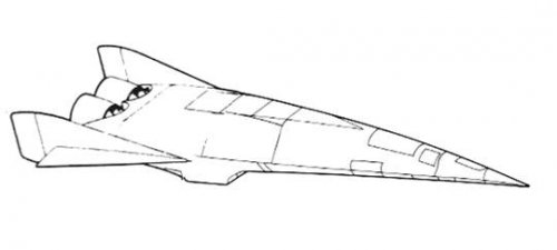

Go down to reply #51 from Mark. Notice how that last piece of artwork is reminiscent of the NASA J-2 powered aircraft referenced by Dyno earlier.
http://www.secretprojects.co.uk/forum/index.php/topic,2867.45.html
However, in reply #57, Prof. Czsyz describes it as "a XLR-129 powered hypersonic glider with a 25,000 nautical mile glide range circa 1958"

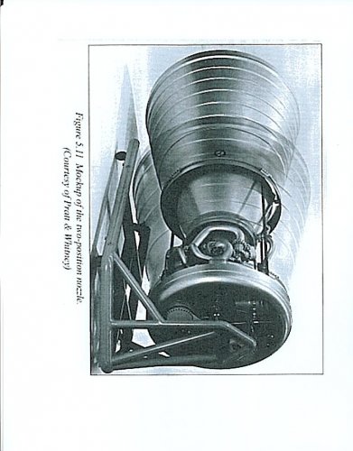

For MZ...RL20 with deployable skirt.

One question about Isinglass still puzzles me: The engine seems huge for an air-launched vehicle. Mulready's book gives a loaded weight of 132,000 pounds, but that seems pretty massive even for a B-52, particularly asymmetrically carried, and still won't allow a lot of burn time on a 250K engine. And if you're launching at altitude, why do you need the two-position nozzle?
Is it possible that an early version of Isinglass was smaller and air-launched, but that it was ground-launched by the time the development work was under way?
The NB-52 dropped the SRB-DTV, which was 48,000 pounds. That should be the heaviest thing it's carried on the pylon, and is right up to the aircraft's limits. The X-51 vehicle is pushing the 52H right up to the limits of its performance envelope as is.
So 132k does sound pretty big.
Might they have considered an "Internal launch"? The C-17 is quoted as "170 K Lb Internal Carriage" and "1000lb+ to LEO" for an "internal launch" (air dropped from its cargo hold) - see slide 11 of the "Responsive Air Launch" presentation by folks from Orbital Sciences, DARPA & Schafer http://www.responsivespace.com/Papers/RS2%5CSESSION%20PAPERS%5CSESSION%208%5CHORAIS%5C8003C.ppt (PPT)
The C-5 had its first flight in 1968, and would have been capable of carrying a 160,000 lb craft in its cargo hold. The heaviest single item dropped from a C-5 weighs in at 60,000 pound, though: http://www.theaviationzone.com/factsheets/c5.asp
An NRO memo to DRNO from Brig. Gen. Jack Ledford, USAF, as of 1965, indicates that the proposed propulsion system for ISINGLASS is the "RL-20 A-1." He also wrote that "P&W has also indicated a growth potential for this engine of about 10 seconds in Isp beyond the values attainable at the time of the Qualification Test (Q.T.)."
This may have grown into the XLR-129. The memos I have been going over looks like the CIA initiated the program with one sole source contractor, MAC, for the design and development work, went to the NRO, who had greater funds than the CIA for recce asset development. Was turned down by the NRO (Dir. McMillian) after a period of threat, technical, and cost analysis, and then directed towards the USAF. A later memo states that the NRO offers a liason for transfering information on ISINGLASS to the USAF in 1967.
Other memos indicate the CIA continues to fund ISINGLASS into 1968. Will provide more info with some scanned documentation.
Here is the document.
  • 65' NRO ISINGLASS.pdf
