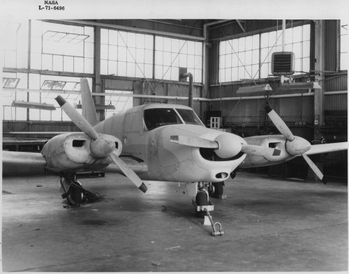

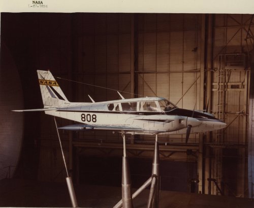

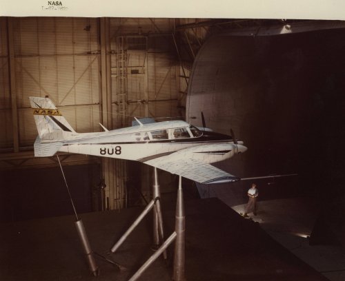

Though not unknown, strictly speaking, a rare model anyway: the Piper PA-30 Twin Comanche under evaluation at NASA in 1967:
Mole said:
Woo hoo, great find on the trimotor Cherokee Six, thanks!
You're welcome! Actually, PA-30 was a Twin Comanche... (should have been "Tri-Comanche" here, but anyway... ;D )

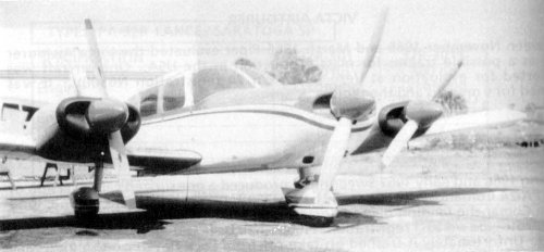

But there was a 3 engined Cherokee Six that led to the Seneca, IIRC it had to 180 hp Lycomings on the wings.
Stargazer2006 said:
If you have any picture and/or info on this, please share it!
I'll see if I can find it. It's mentioned on Wikipedia under both entries for the PA-32 & PA-34 & was the Cherokee Six - 3M, IIRC.
From 'Piper Aircraft and their Forerunners', page 226 :-
cheers,
Robin.
