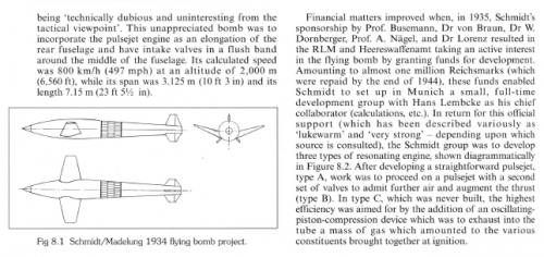

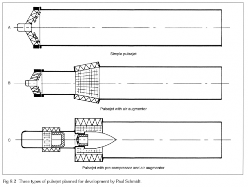

Hi guys,
reading once again my copy of "German Jet Engine and Gas Turbine Development 1930-1945", page 239, authored by Antony Kay, I was struck to know that Paul Schmidt, pioneer of the pulsejet technology, worked out aircraft projects, trying to mate it`s "resonating tube" to more militarily natures. A quick research on german patents led to nill, but finally I got here:
http://www.google.com/patents/about?id=1W15AAAAEBAJ&dq=paul+schmidt+aircraft
There it was, it`s idea of a VTOL aircraft, back in 1931.
On a more scientific way he worked with a aerodynamicist ( Prof. Madelung, Kay says G. Madelung, but probably it was Erwin Madelung ) on a flying bomb and, the "piéce de resistance", an interceptor fighter and a light bomber.
I ask: does anyone knows more about this projects?

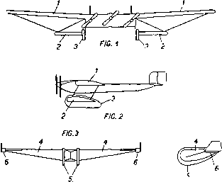

Thank you , I know the site , but I browsed the 1932 year twice without finding the Schmidt's patent ...
It's on page 120.
An careful, please !

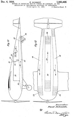

From what I read in the patent description, only the drawing shown below
belongs to the patent filed by Paul Schmidt, the other drawings are about
a patent filed by Bartolomiej Jan Poplawski and describes a caterpillar landing
gear, that has nothing to do with Paul Schmidt !
