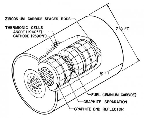

Vehicle Would Use Ion Propulsion in Space
Lockheed Missiles and Space Division has proposed a space vehicle (left) to be propelled by a low-thrust ion rocket after vehicle and nuclear reactor are boosted into space by a chemical rocket. Spacecraft would be separated from reactor by a mile-long coaxial cable for radiation protection. Reactor is at 2,100C and "boils” electrons off thermionic cells (right) placed around outer shell of reactor, thereby directly producing electrical energy which is transmitted through cable to power ionic propulsion system. Total power yield of 34-ton unit would be 1,000 kw.

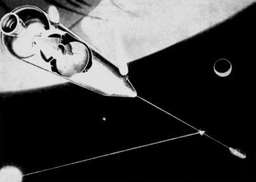

Scientists at the Lockheed Missiles and Space Division have proposed a relatively simple "cocoon" system for a manned flight to Mars. The new design — seen here in an artist’s impression—differs from other proposed Mars systems by using two huge chemical booster-rockets (top left and bottom right) as part of the Mars ship itself. In the impression the glowing, trailing object (bottom left) is a nuclear reactor to provide power for air supplies and other important life-support systems. Inside the cut-away section of the nearest chemical rocket-booster (top left) can be seen a return-to-Earth vehicle, with, at the other end of the cable (bottom right) a chemical rocket-booster containing equipment for a Martian landing.
