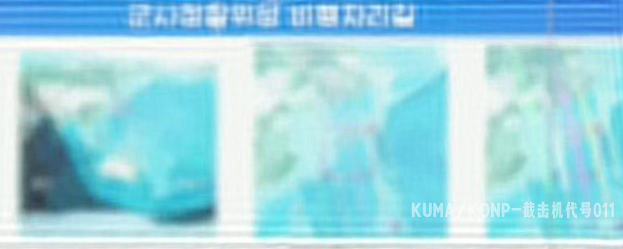

In March 10, 2022, Kim Jong Un inspected the National Aerospace Development Administration (NADA), and in the report photos, we got these images:
P1:
P2:
Although these photos are blurred, we can make them as clear as possible through deconvolution. by this way, we can get more information than the original images.

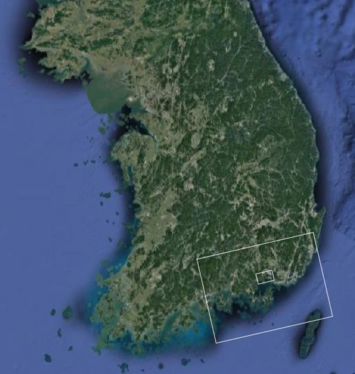

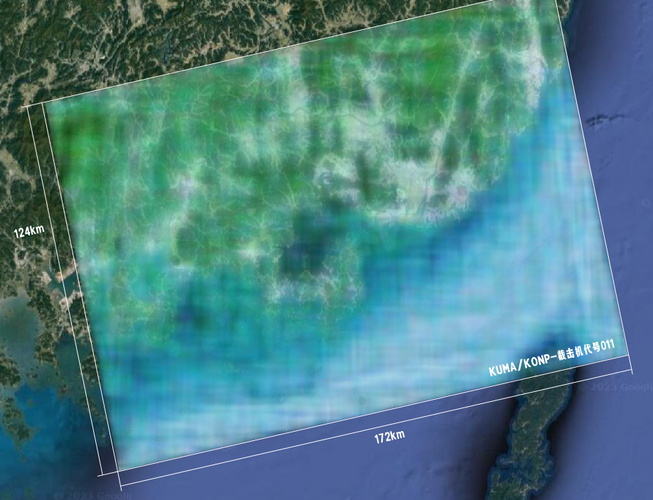

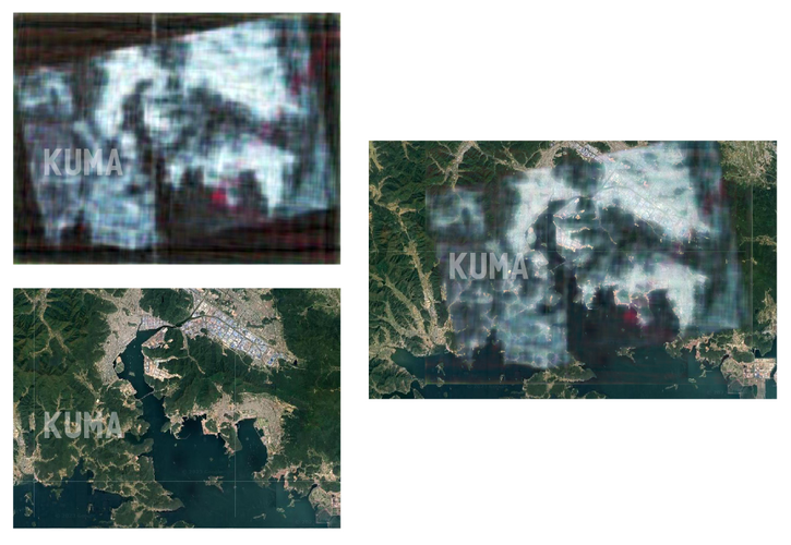

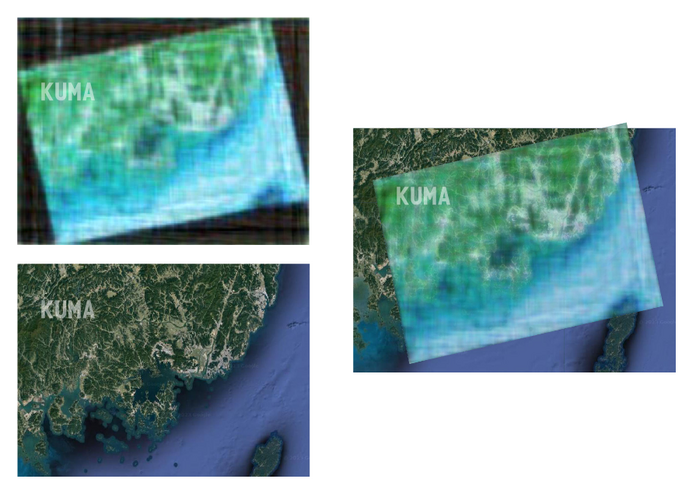

In P2, we can determine the shooting time, shooting area, shooting method, camera height when shooting, and possible resolution:
Photographic mode - vertical photographing
Shooting area - Pyongannam-do,Anju near by
Photographic height - 591km
resolution - Probably 2.0Xm (Panchromatic)
The values of resolution are ambiguous. How can we determine our conjecture? Let's look at the partially captured image shown in P1.
Combining my restored image with the three resolutions of the same area provided by 38N, it is easy to find that, despite being blurred, the resolution level is indeed close to the level of about 3m:

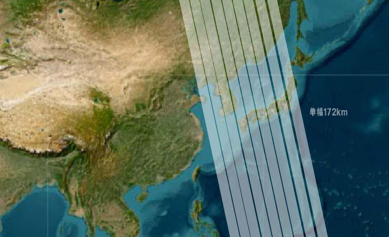

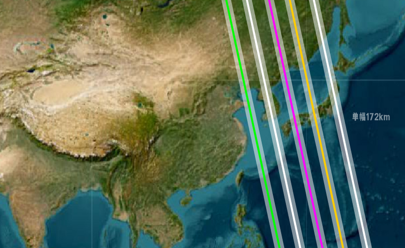

However, we still have one more information to analyze: The swath width.Through the overlay analysis of P2, we can get this data:

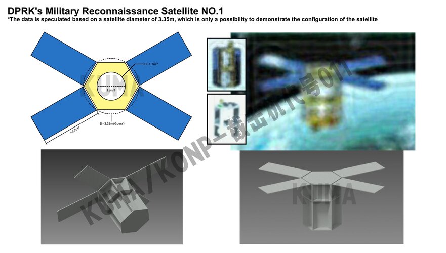

What this satellite may look like:
Kim Chaek University of Technology(KUT) showed a CGI in its own school news on the school website, which may show the future satellite's shape:
Interestingly, the shape is very similar to Kompsat-3/3A.
Now we can know the satellite details:
Working on ~600km SSO
Resolution ~2m
Swath width ~13km
Configuration may similar to Kompsat-3/3A

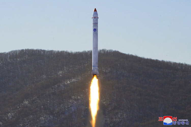

The latest satellite test
Pyongyang, December 19 (KCNA) -- The National Aerospace Development Administration (NADA) of the DPRK conducted an important final-stage test for the development of reconnaissance satellite at the Sohae Satellite Launching Ground on December 18.
A spokesperson for the NADA said that the test was mainly aimed to evaluate the capabilities of satellite photography and data transmission system and ground control system.
The test was conducted in the mode of evaluating the processing capability and stability of data transmission devices while verifying the reliability of ground control system including photography control command and attitude control command for various kinds of cameras in the optimum environment simulating space environment after high-angle launch of a test-piece satellite into the altitude of 500km with one panchromatic camera for 20m resolution test, two multispectral cameras, video transmitter and transmitters and receivers of various bands, control devices and batteries, he said.
The test confirmed the important technical indices including the technology of camera operation in space environment, data processing and transmission capability of communication devices and the tracking and controlling accuracy of ground control system. The NADA said this is an important success which has gone through the final gateway process of the launch of reconnaissance satellite.
The NADA announced that it would finish the preparations for the first military reconnaissance satellite by April 2023.
The results of the important test were immediately reported to the Central Military Commission of the Workers' Party of Korea. -0-

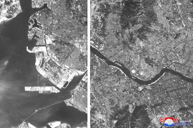

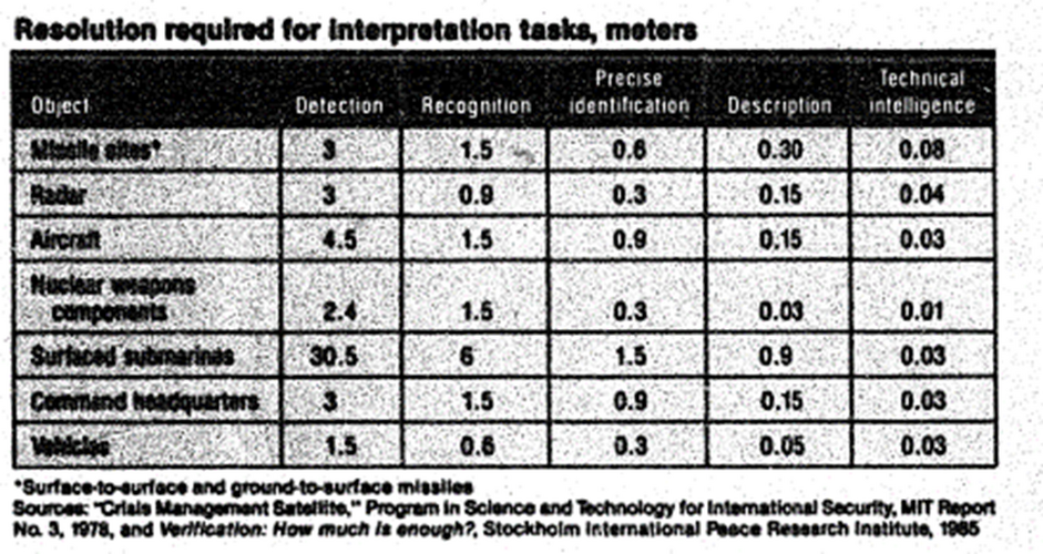

This experiment is said to be the "final stage", but it fills me with confusion:
In the group of satellite test photos I analyzed before, the resolution has obviously reached the level of meters(~2m?), but the resolution of the new test photos in this experiment has dropped by an order of magnitude(20m), and the experimental height is also lower.
Did it really reduce the resolution for technical reasons, or did it deliberately give an error message for confidentiality reasons?
It must be assumed that the use of the satellite will be military. They will not publish anything that might reveal the real capabilities and parameters. The media output from the last test only declares the ability to track a certain area. Therefore, the images aren't blurred. We will never know the exact parameters, but in recent years, the DPRK's military capabilities have been higher than the mainstream expects. We will certainly learn more in the first half of next year.
That 20 meter resolution really looks like an intention. As part of a political message.

Two vehicles were fired from, the first known to have tested whether the ground control station track and receive the signals sent by the transmitter and the second to conduct the relevant test which has been already opened to public.
I think there's no more question.
I am wondering what those, who are now so desperate to depreciate our technical ability, would say to slander us when our military satellite is in operation anytime soon.
And of course, they will have absolutely nothing to say except that an unidentified flying object has entered orbit but nothing has been confirmed to perform its action as a satellite.
Obviously, as I thought, the optical load of this experiment is not the final optical load.
It's just a test camera for the integration test of various systems.

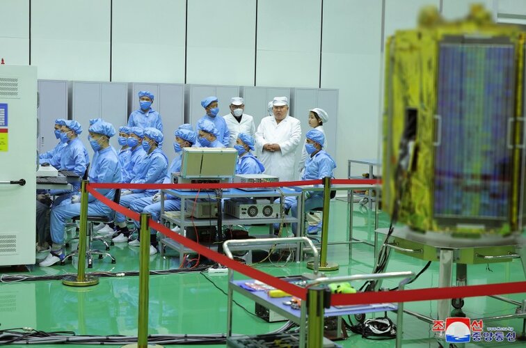

UPDATE: Photos from Kim Jong-un's visit to NADA have leaked more information on military satellites, including photos from previous tests.

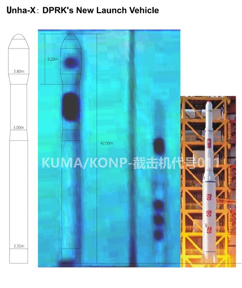

Brand new unknown launch vehicle:

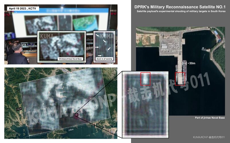

Photographs were taken of South Korean military targets during the 2.27 test

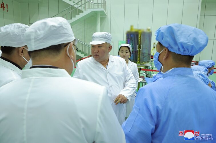

The shape of the satellite is finally revealed:

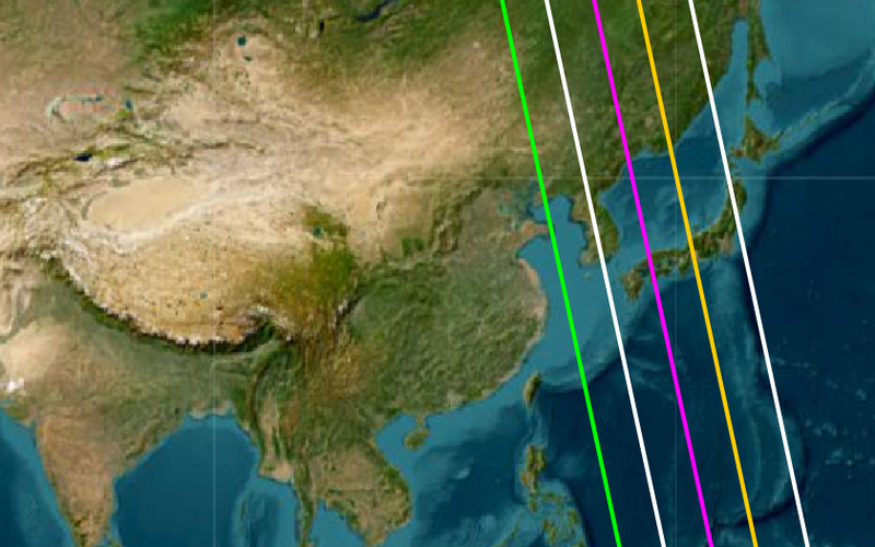

According to North Korea's satellite load configuration and orbit, the Korean Peninsula and Japan can be completely covered and imaged in about five days
Width based on previous satellite photo settings
(Titled "Military Reconnaissance Satellite Flight Path")
If first stage diameter is 3.3~3.4 meter then there could be using four RD-250 engines.
Then wouldn't be surprising for such being able to place around 3 ton satellite into SSO.

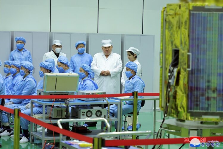

According to the photos of the satellite subsystem inspected by Kim Jong-un, it is speculated that the diameter of the No. 1 satellite is likely to be no more than 1.1m(Based on subsystem component size calculations), which means that the military satellite No.1 may still be launched using Unha-3, and the unknown launch vehicle should be prepared for a later project.
According to the analysis of the photos, the possible payloads on the satellite are:
1.Four optical cameras, two in one group, the apertures of the two groups of cameras may
different
2.A polyhedral laser reflector that may be used for ground positioning and ranging
3.There may be a propulsion compartment
different
4.Two star sensors
5.A single-sided driven conical horn antenna
6.The basic shape of the satellite is hexagonal
Just for the record. If that's a spy satellite with a mirror, then a diameter of 1.1 m would be a match for the old KH-7 GAMBIT & KH-8 GAMBIT-3: flown between 1963 and 1984.

Update:
different
4.Two star sensors

I base this speculation on two facts:
1. The overall diameter of the satellite is likely to be no more than 1.1m, meaning it may fit into the fairing of Unha-3 (1.25m)
2.The remodeling of the launch site is incomplete and does not appear to be happening so far(Of course, the possibility of unconventional launches cannot be ruled out)
But the above are guesses, let us just wait for the arrival of the launch news.;)

This is some figure of required resolution for a task. Resolution of some 50 cm seems adequate for most tasks. Higher than that would be great.
The absolute ground resolution limit is called the Fried limit, and is set at 2 inch: 5 cm. Not sure even present day advanced digital imaging can push that limit: probably not.
Interesting. I am working on a simple spreadsheet on calculating Optical spy satellite achievable resolution. Currently it's only taking account of diffraction limits, mirror specifications (particularly the Sagitta of the mirror), focal length and orbital. Glad to see i can put another factor into it.

I wonder what will they use as SLV.
2 stage Hwasong-17 or 3 stage Hwasong-18.
Since new launch pad was quickly built I guess latter.

Update: Launching soon!
North Korea notified Japan of launch debris landing area and time period.
According to the content of the notification, the launch will take place between the 31st of this month and the 11th of next month.
Image from NHK:
YONHAP NEWS:
N. Korea notifies IMO of 1st military spy satellite launch plan.
It is said that South Korea experts believes that the launch vehicle used by North Korea for this launch may be more powerful.(YONHAP NEWS)
전문가들은 북한이 공개한 로켓 낙하 예상지점과 2012년 장거리 로켓 은하 3호 및 2016년 광명성 4호 때의 낙하지점을 비교할 때 발사체 성능이 더 좋아질 것으로 분석했다. 위성체가 올라갈 궤도도 500㎞ 이상일 것으로 추정했다.
