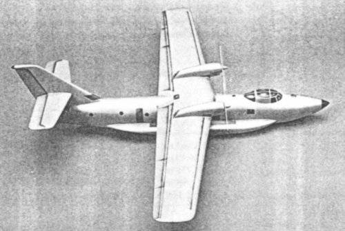

A competitor ro the Dassault Breguet Atlantic, very similar to it, is shown by Cuny, in
the 2nd volume, but without designation .

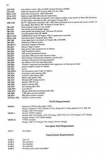

Stéphane: do you have a ref for a DHC entry? I am aware that Canadair put a lot of work into their CL-62 concept for NBMR.4. What was DHC working on?
Apophenia said:
NBMR.4 was, of course, for a V/STOL tactical transport aircraft.
:eek: :eek: :eek: I KNOW!!! I realize I typed "fighter" instead of "freighter"... How could I be so absent-minded?? ???
Actually I do. This is from an old listing published in a British aviation magazine (I believe it was Air Pictorial). I'm attaching a copy for reference.
Thanks Stéphane! Very intriguing, now we just need to figure out what DHC was proposing ;)
Stéphane, actually it was published in Aeromilitaria (The AIR BRITAIN Military Aviation Historical Quarterly) No. 1/1997.

hesham said:
And that makes the contenders for NMBR.4 as following;
Shorts PD.55,Agusta A.118 & A.119,BAC-224,SIAI S.201,Aerfer-2102,
AW.681,EE P.36,Fiat G-222 V/STOL,Avro-783,Bristol-208,DH-129
Dornier Do.31E and Breguet Br.941.
Also;
EE P.41 & P.44,Canadair CL-62,Breguet Br.943 to Br.947,LTV ? and DH Canada Caribou II.
Hi Mirage 4000,
can you tell us about what was that Sud Aviation proposal,info or drawing ?.
we can add Ryan and two Belgium companies to NBMR.3 contenders;
- Ryan M-209D (maybe)
- Avions Fairey ?
- SABCA S.?
- Hawker P.1150/3 & P.1154
- BAC/Vickers Type 583,584 & 585
- Armstrong Wgitworth AW.406
- Shorts PD.45,PD.49 & PD.56
- BAC/English Electric P.39
- Dassault Mirage IIIV
- Fokker-Republic D.24
- Fiat G95/4
- Breguet Br.122
- Nord N.4400
- EWR VJ.101
- Focke Wulf FW.1262
- Lockheed CL-704
for NBMR.4,the Focke Wulf submitted a proposal for V/STOL transport aircraft with twelve
RB.162s in two wingtip pods and Douglas also submitted a proposal but maybe in conjunction
with Piaggio.
Now we can say the the tenders were;
Shorts PD.55,Agusta A.118 & A.119,BAC-224,SIAI S.201,Aerfer-2102,AW.681,Fiat G-222 (V/STOL),EE P.36,P.41 & P.44,Bristol-208,Avro-783,DH-129,Dornier
Do.31E,Breguet Br.941,Br.943 to Br.947,Canadair CL-62,LTV V-?,Focke Wulf ?,Douglas D-? or Model-1xxx,DHC-4 Caribou II and Ryan,
for Ryan I suggest the designation was Model-2108,or as my dear Skyblazer suggest,it was Model-210B.
