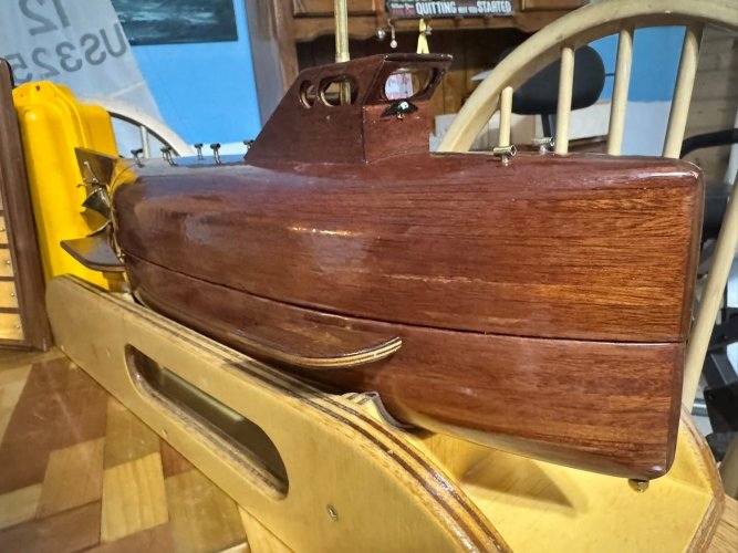

You're too kind my friend, a wonderful teacher and mentor you and Jake are for sure, truly a blessing. Time coming up short till our event, I hope to have this wonderful little boat ready for a shakedown on both drivers weekend after next. About 2 months from our event and looking forward to bringing Blueback to have fun with the rest of the pack! Also, will have "Luck" and, God willing, the Verne Nautilus. I've been working on a detail paint job with my newly acquired skills, though haven't started in on paint.

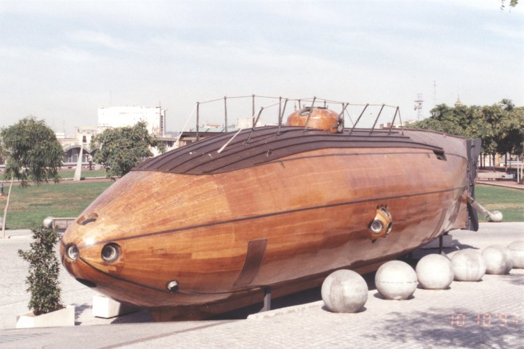

Here, have a 1997 photo of a full size replica of Ictineo II courtesy the website, https://it.wikipedia.org/wiki/File:Ictineo_II_replica_Barcelona_1997.jpg

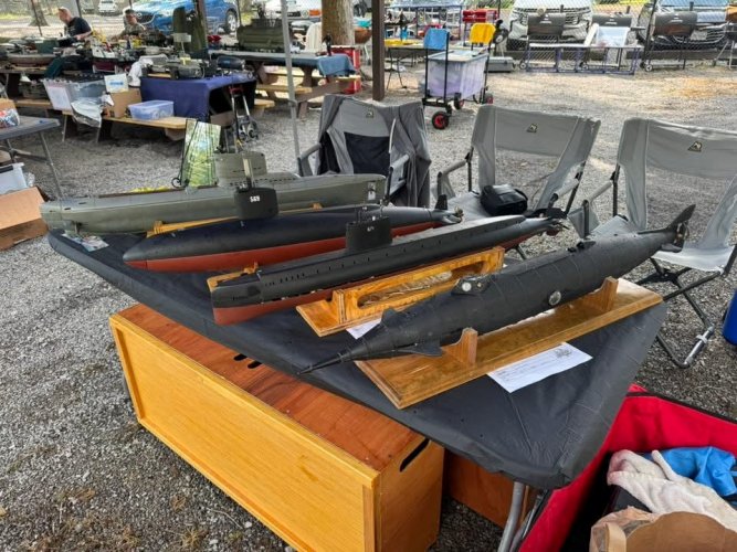

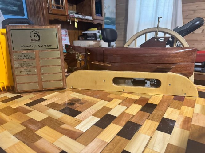

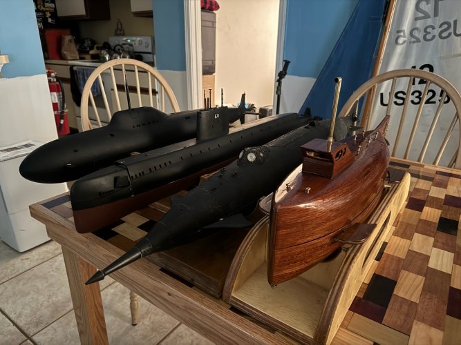

Here's a better picture of the Verne Nautilus. It sails ok, has a SWM driver, but the screw is not cool, so I'm making a new one, also the windows and such are in sore need of replacement. I've ripped the stern section apart and started re-work, but then a more important project came up in form of the Blueback. I'll try my damndest to get this one ready too though as it's alot of fun to play with too.

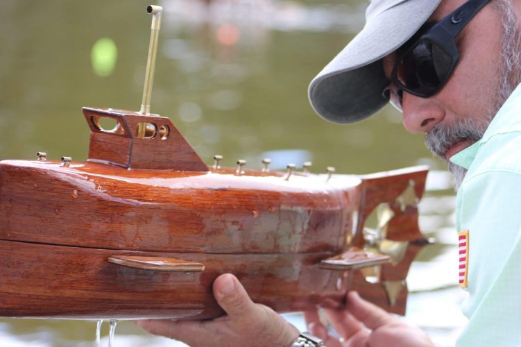

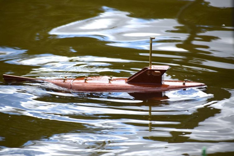

Here are 4 pictures of my little submersible tug "Luck". He was voted in as boat of the year by our club (surprised me), earned his eagle for multiple rescues at the ponds and a picture of me holding him during his maiden run, took him out just to make sure all was ok, then back in the water he went for about 4 hours.

The design I recognize from an illustration from a large format book, 'The Big Book of Submarines' I think. Later worked up as a model by a guy formerly associated with the model-shop at the David Taylor Model Ship Basin. Good choice!
Thank you sir, I like that it’s unique. Not exactly as Mr Verne wrote but very neat.

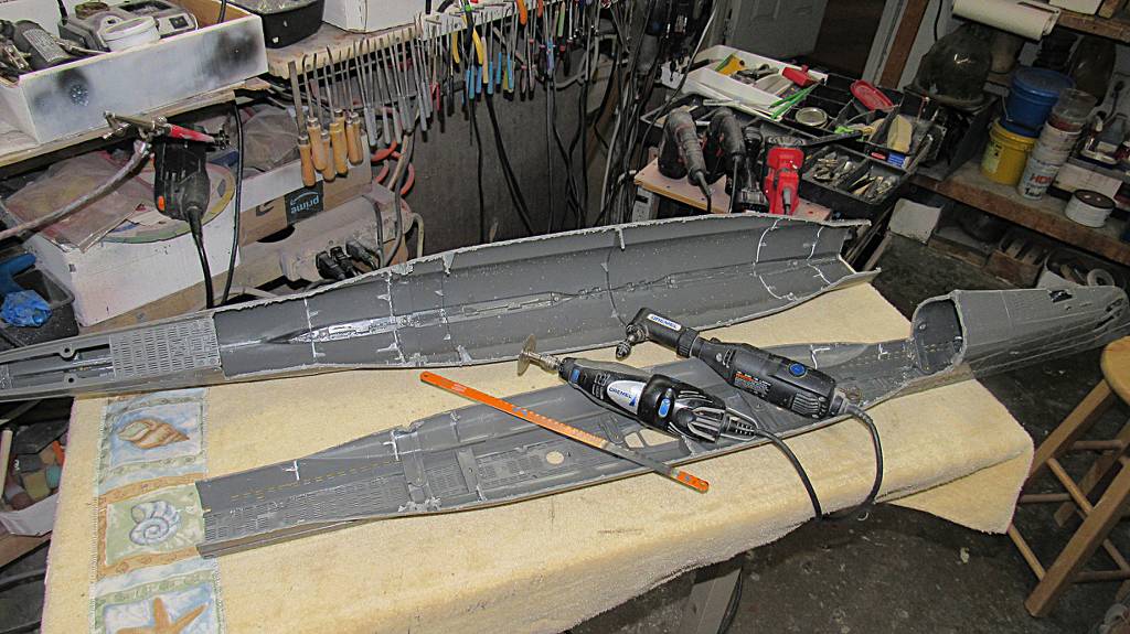

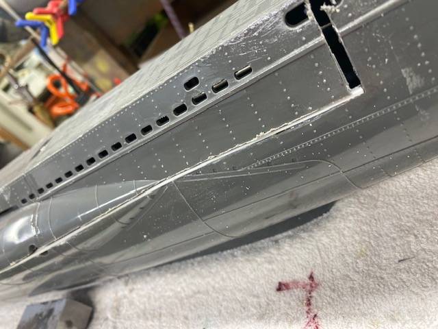

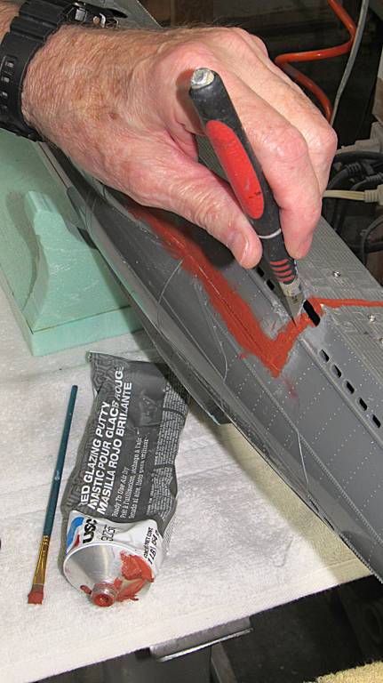

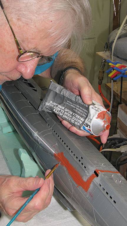

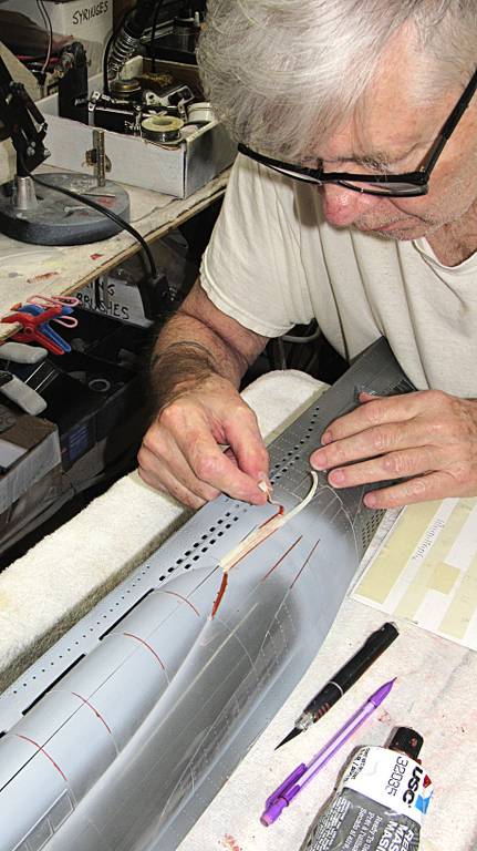

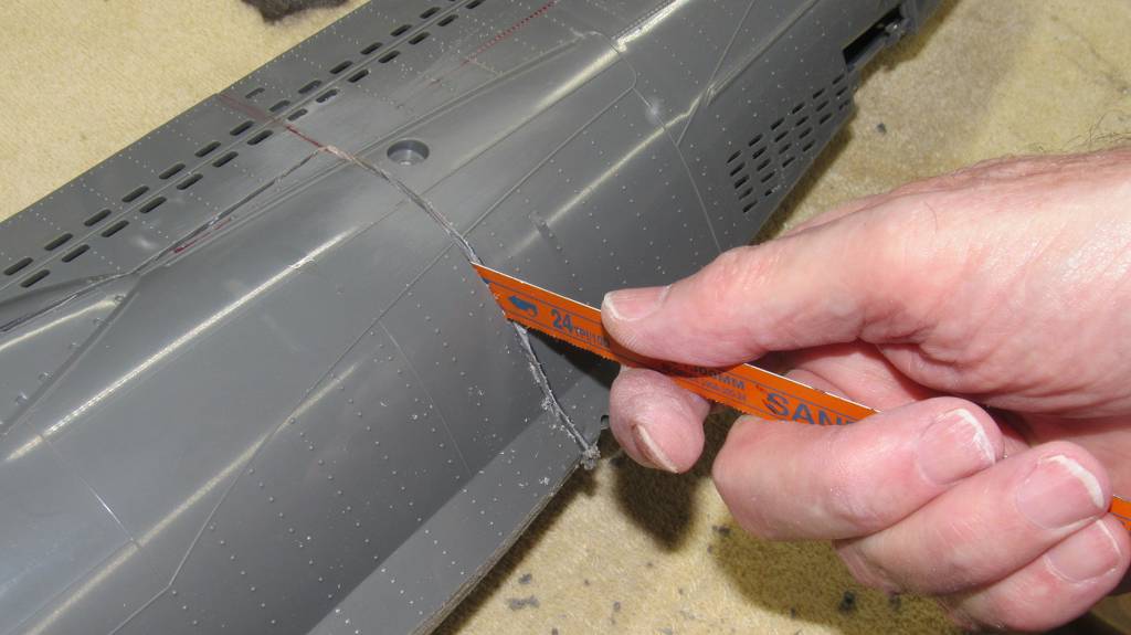

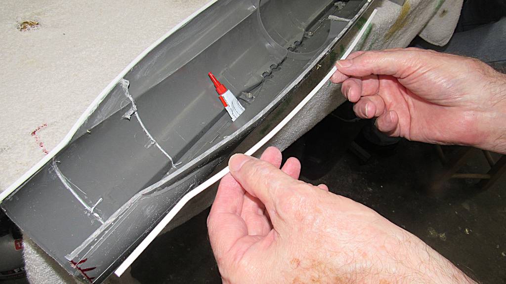

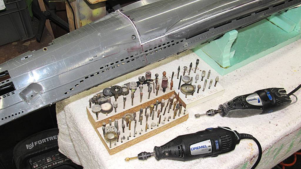

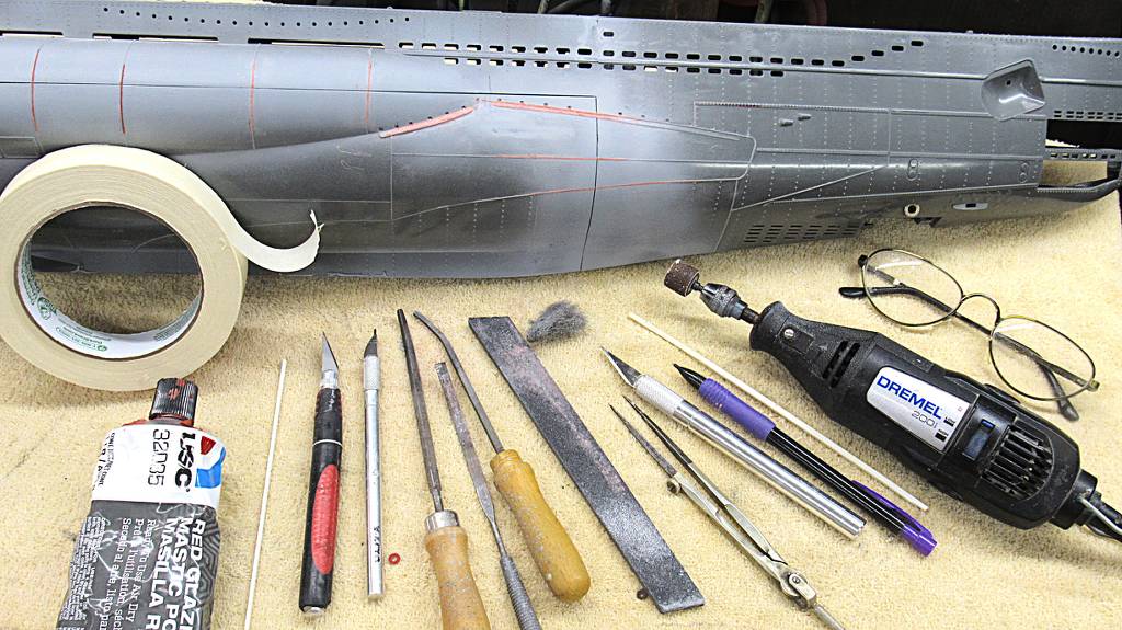

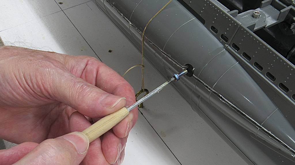

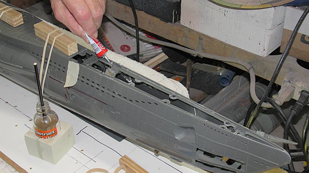

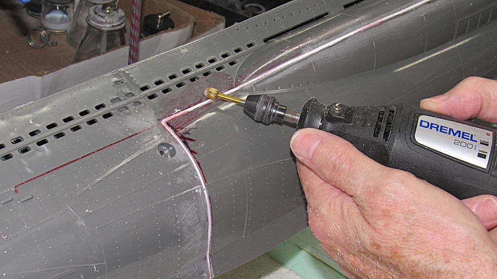

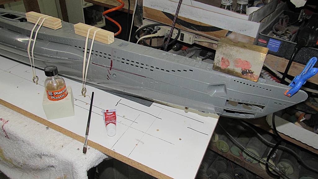

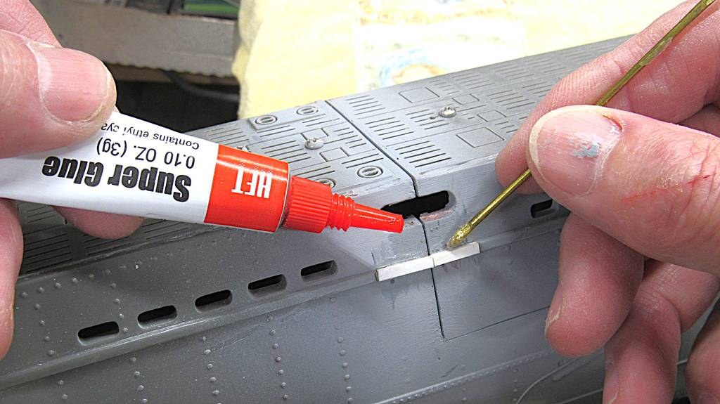

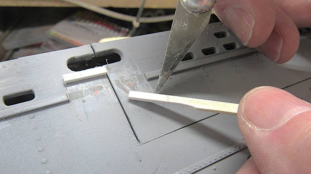

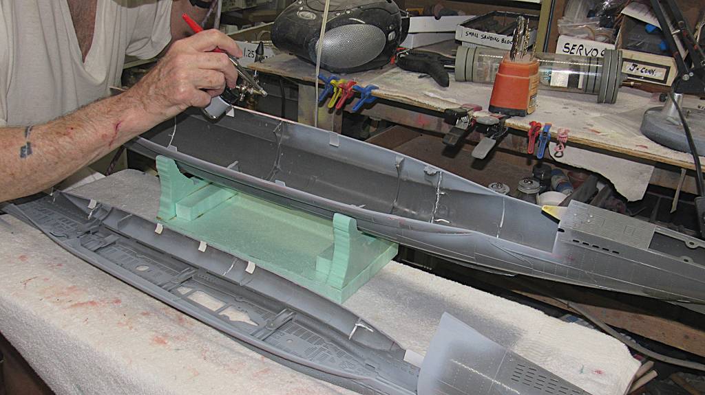

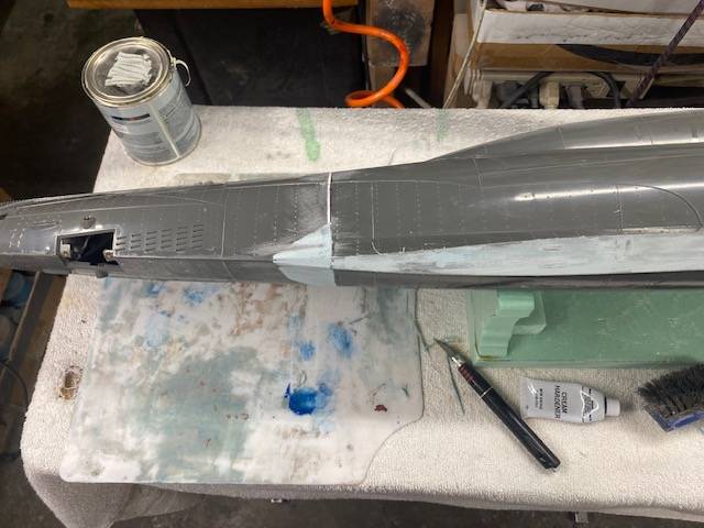

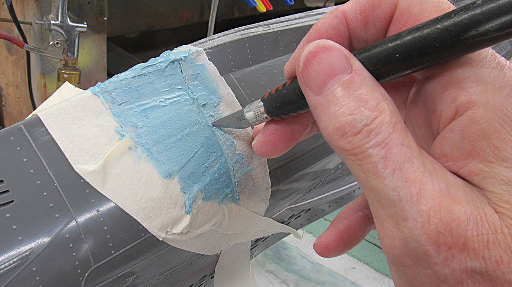

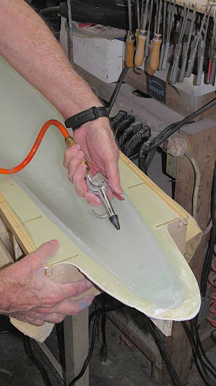

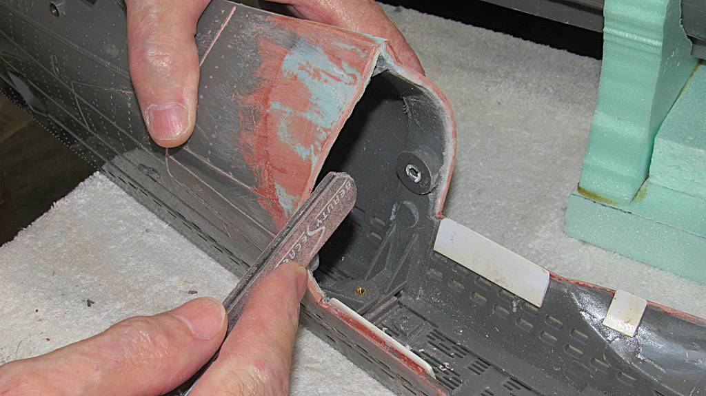

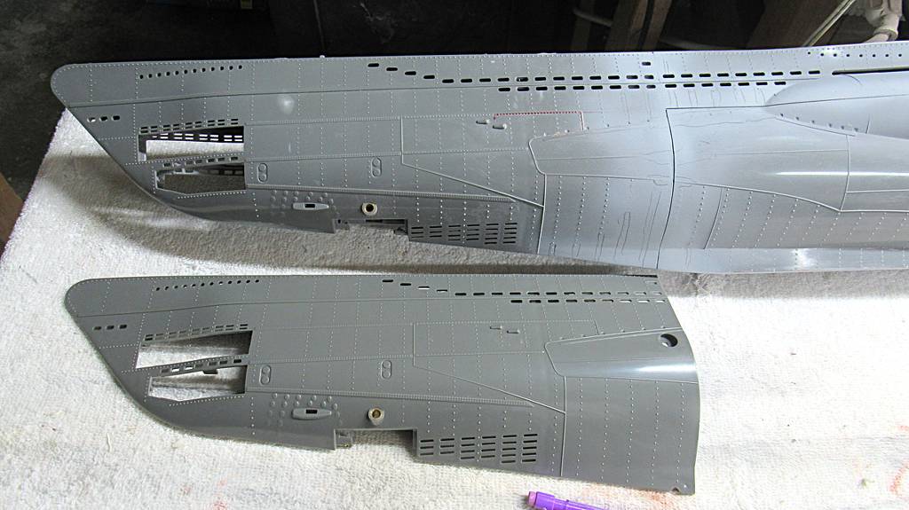

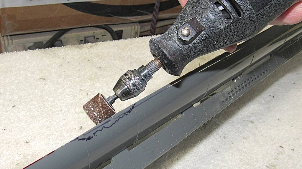

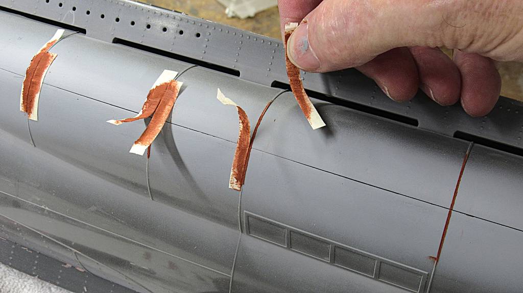

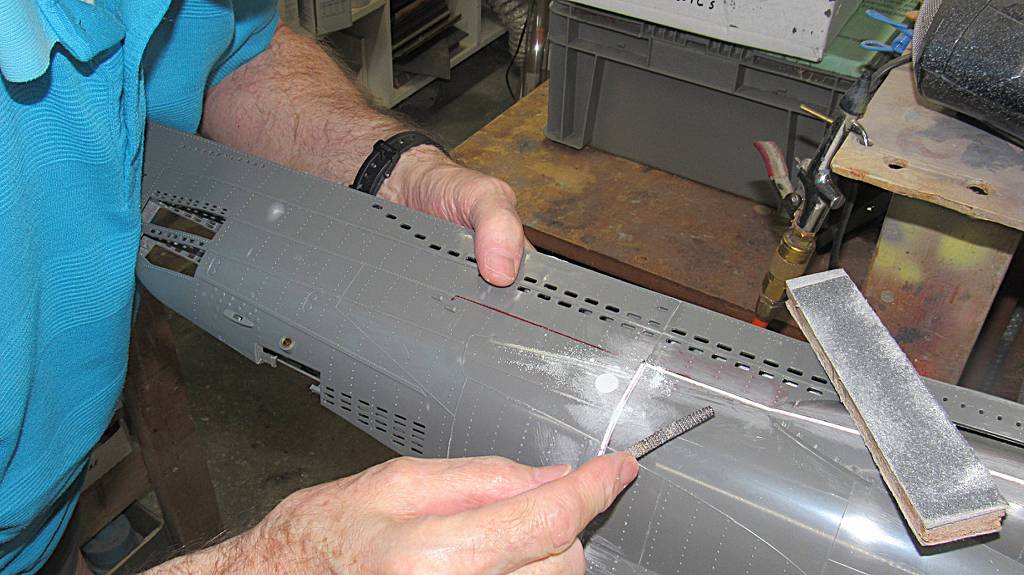

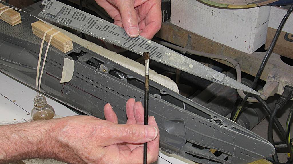

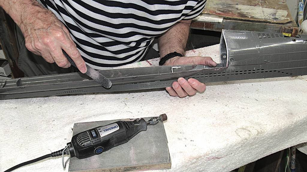

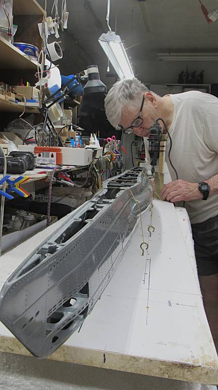

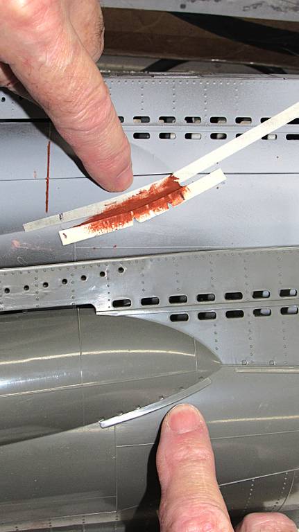

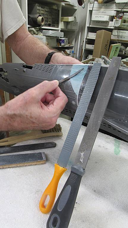

Cleaning up the over-strikes and poor quality engravings, I can assure everyone, is at least as mind-numbing a task as it is to read about it. But it's a task that's gotta be done if a quality product is to be the result!
So, strap yourself in and make what you will of the following procedural.

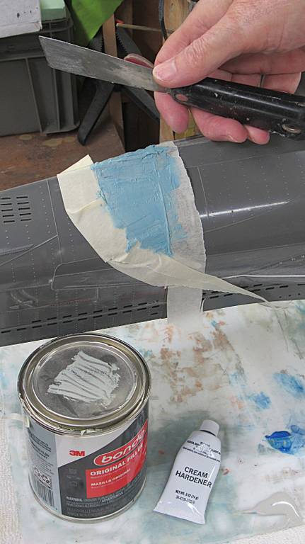

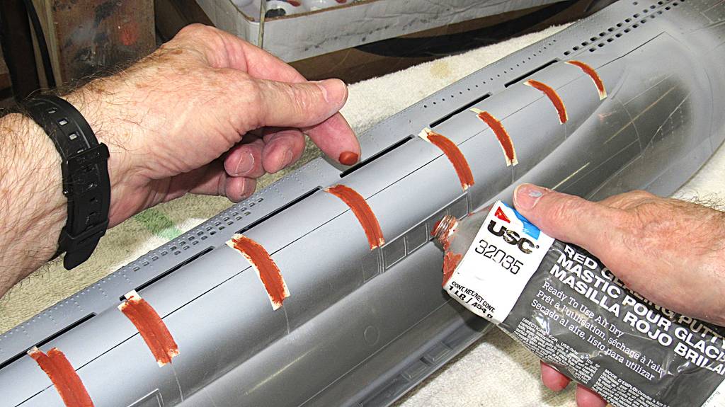

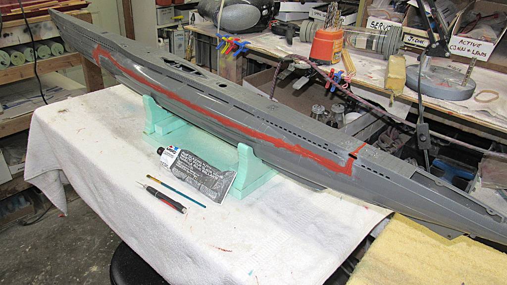

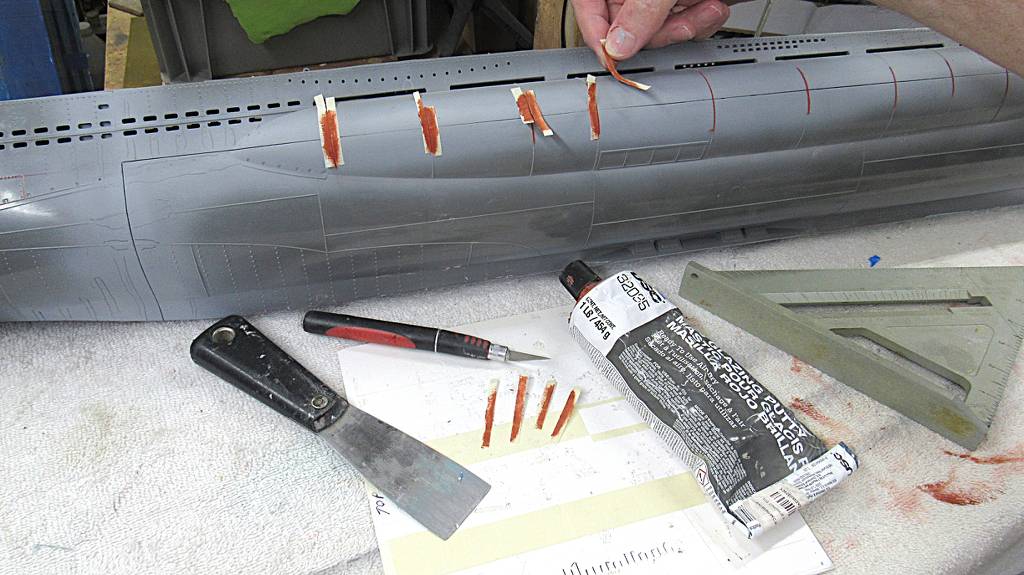

The initial scribing done forward I've applied some putty.

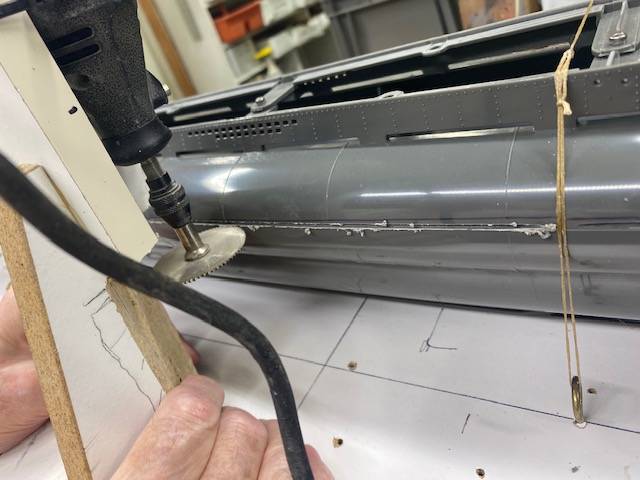

Here I'm deepening the straight running engravings with the modified razor-saw. While continuing aft along the model deck with scribing tool and saw, the putty, up forward, has plenty of time to dry.

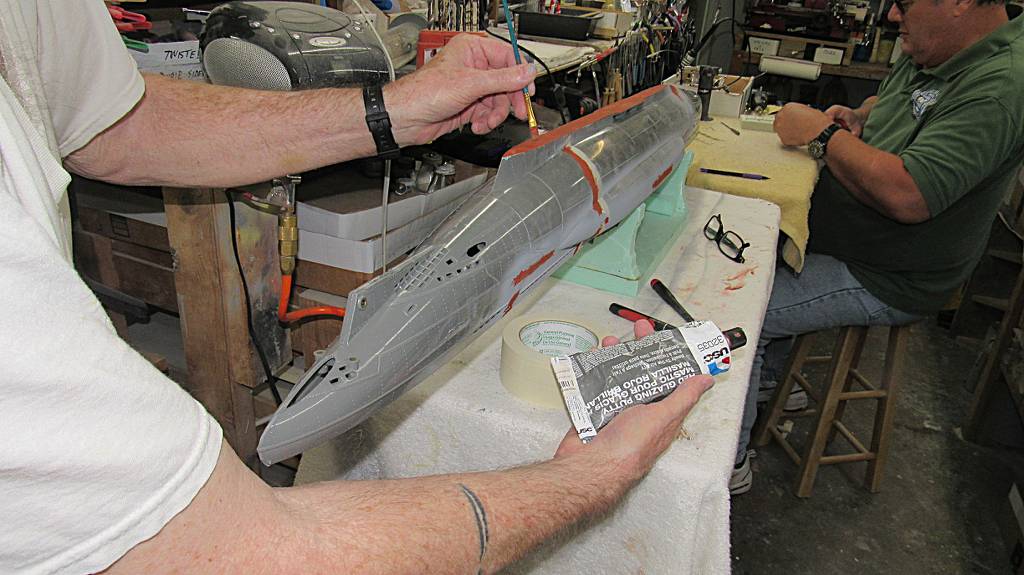

As soon as an engraving task was completed, I brushed on air-dry Nitro-Stan touch-up putty over that work, promptly chasing out any putty that gets into the engravings.
Air dry putty is never applied thick, its only to address shallow scratches and gaps. Since this putty polymerizes (changes state from liquid/paste to solid) through evaporation of its solvent – if put on too thick it takes forever for the buried solvents within the mass to be liberated to the air. The top surface will skin hard, but underneath that the putty is still soft. A killer later!
(Two-part fillers, on the other hand, change state quickly if put down thick as the polymerization process – how the filler changes state from liquid/paste to solid – is through an exothermic reaction between the resin base and catalyst. So, with a two-part filler, the denser the mass the greater the heat generated, the quicker the cure of the filler.)
The dried putty is wet-sanded with a small hard-rubber sanding-block backing up a piece of #400 grit sandpaper. Copious amounts of water are the order of the day.
The sanding done; a wet paper towel is used to remove the water suspended sanding dust.
Followed by a blow-down with low pressure air to chase out any water still hiding in the engravings.
And... just to be sure... some hot air to evaporate the last traces of water.
At this stage I'm chasing out sanding dust from the THIRD scribe-putty-sand cycle!
God!... will it never end????
Now that the engraved lines are deep enough to guide the tool there's no need for stencils or straight-edge, just push the tip of the tool into the work and gently guide it along. This pushes any stubborn dust clear of the work. Making things ready for another coat of gray primer which further fills scratches and at the same time renders an easier to examine models surface.
To check for any missed over-strikes, misshapen engravings or other flaws, a coat of primer to fill and identify the problem children.
… and the process repeated until perfection (who am I kidding?!...) is achieved.

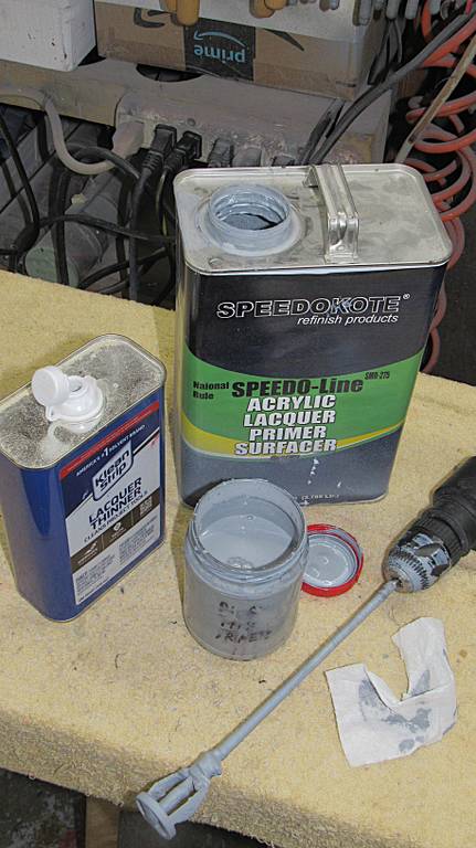

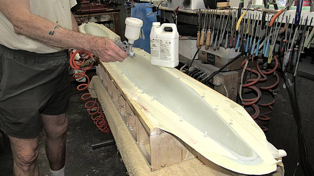

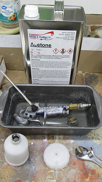

Screw that sprayer... I'll use any damned solvent I want, and it will just have to lump what it does to the rubber parts! (though your point, Scott, is well taken).
Spraying 2-part epoxies was always a "clean up with MEK" thing for me when I was working planes. Even after the state really cracked down on MEK usage, the painters were still allowed to use it for cleaning. The rest of us got stuck with Methy Propyl Ketone, which was not as good at cleaning up what we needed it to so we used about twice as much.
Plus, MEK gave me a contact allergy to latex. And I was lucky, we had one dude in the other hangar develop full blown anaphylaxis to latex.
