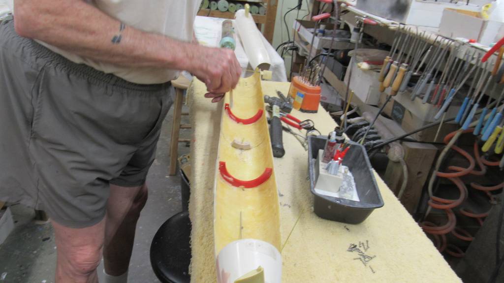

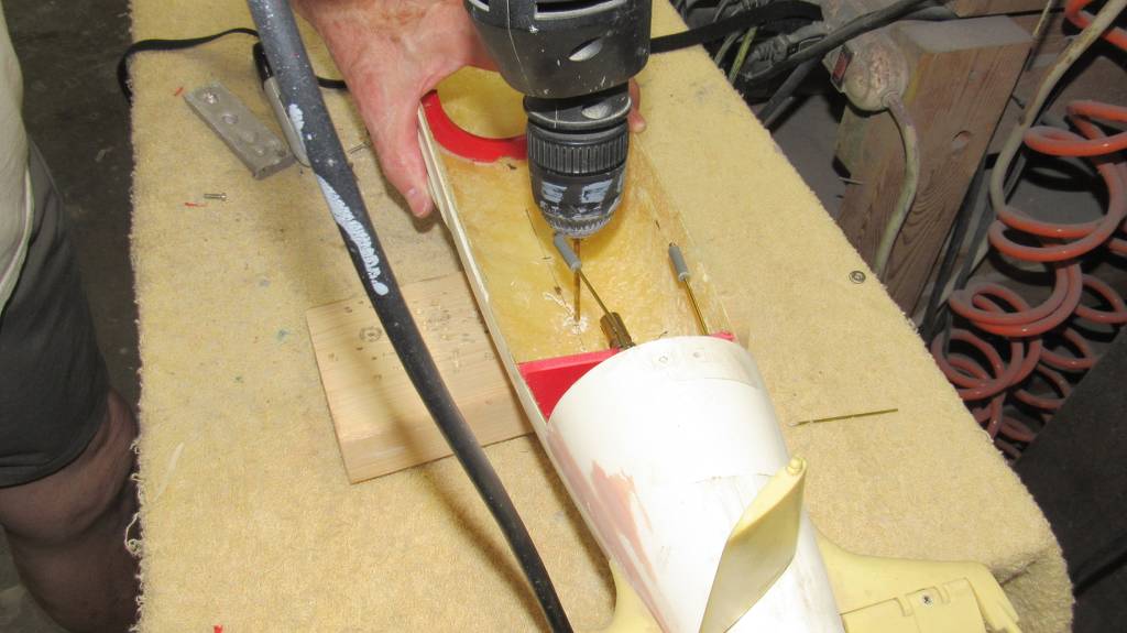

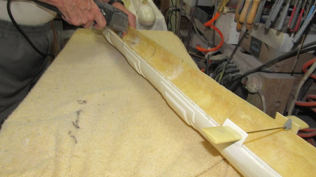

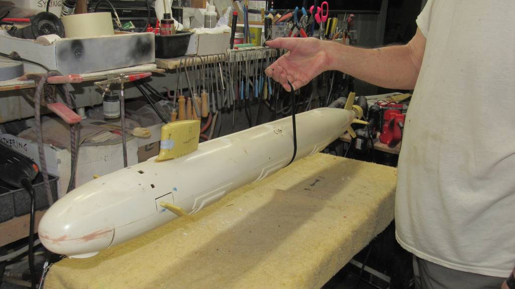

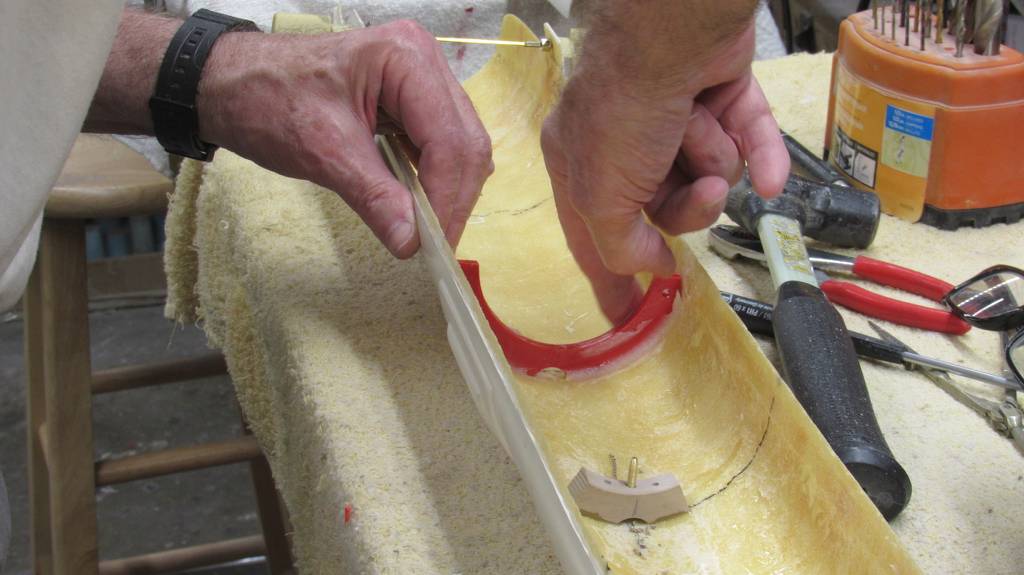

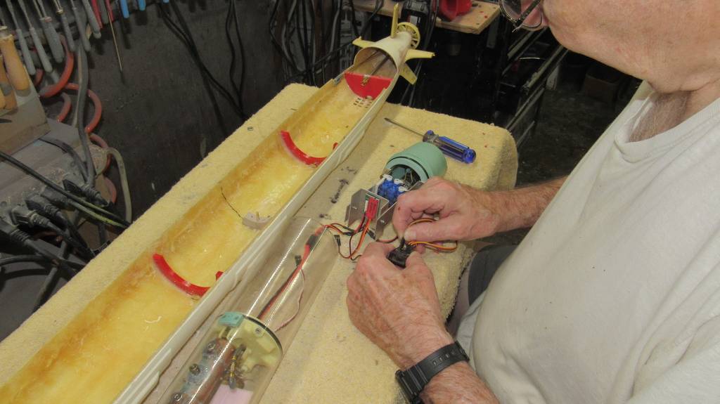

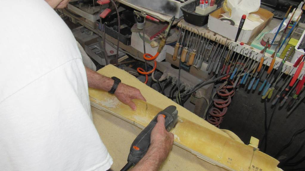

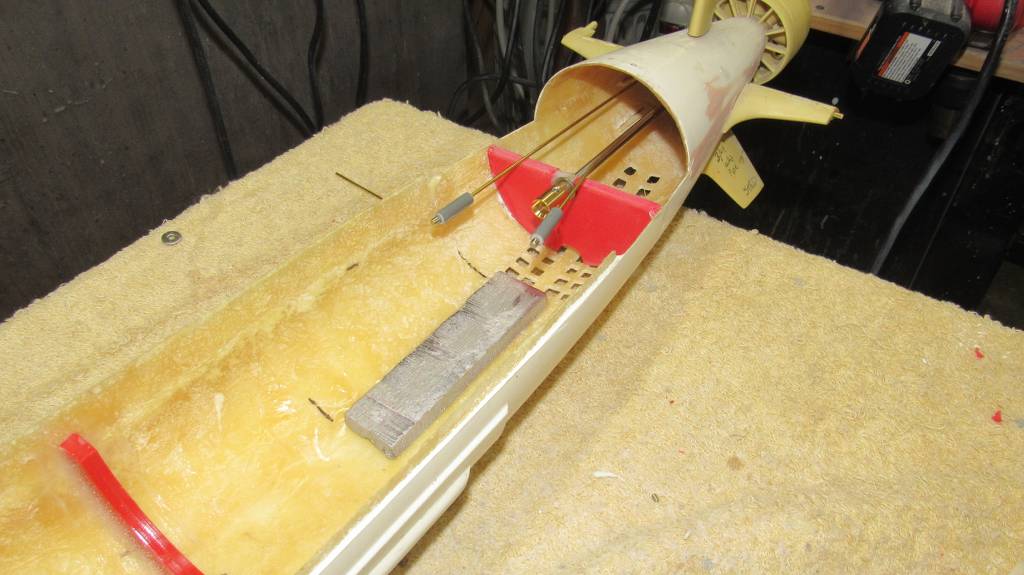

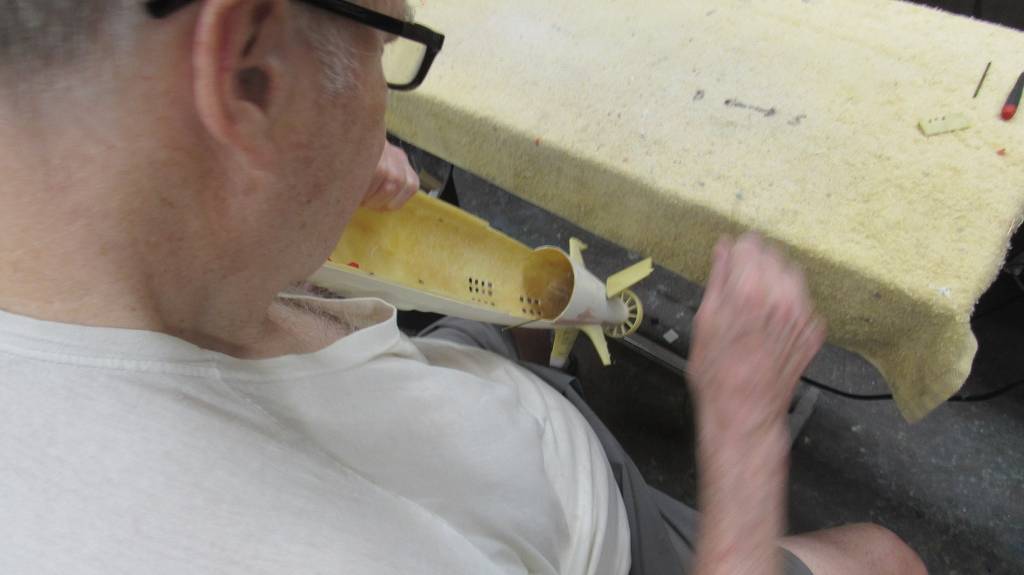

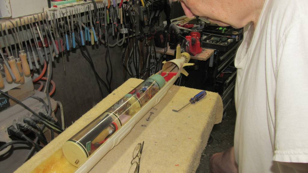

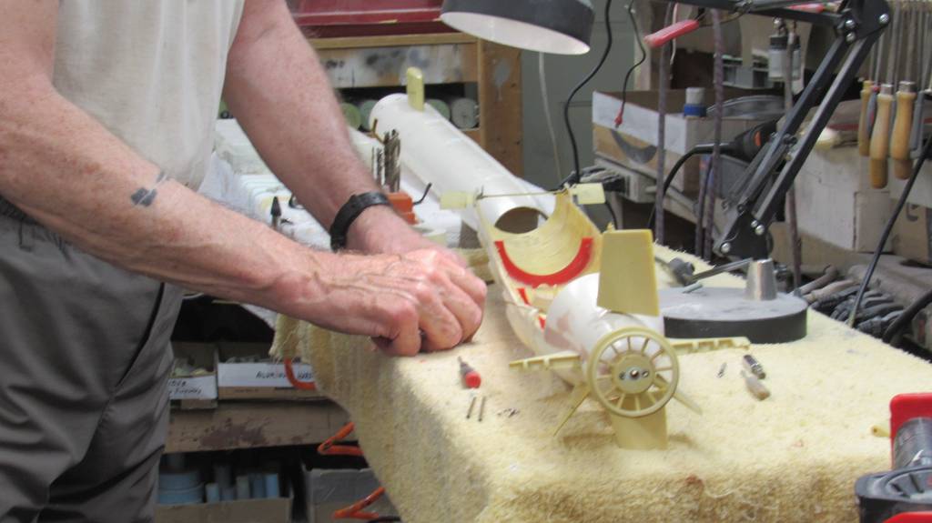

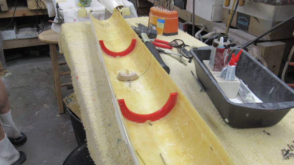

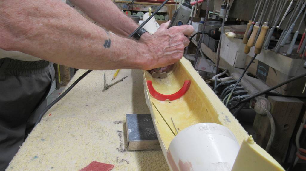

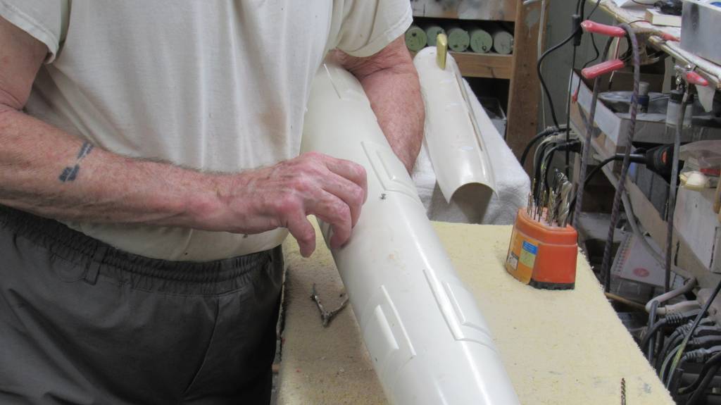

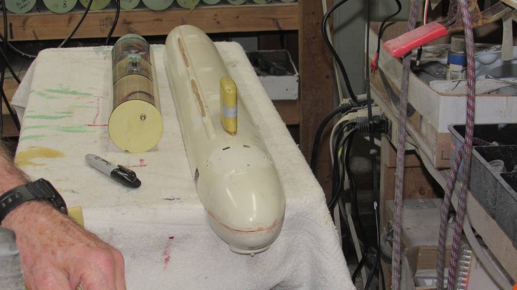

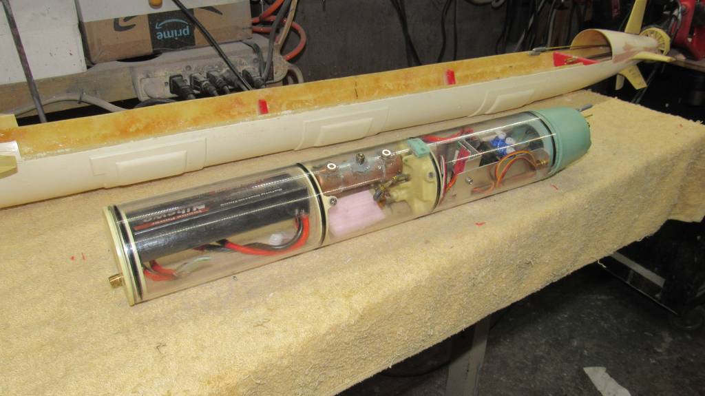

Hey, bossman, are you using regular-cut fiberglass cloth for the hulls, or bias-cut cloth?
Pictures make it look like regular cut, with some threads running the entire length of the piece of fabric instead of the threads running at 45deg to the length of the hull.
I'm asking because bias cut cloth does a much better job wrapping around shapes. Bias cut is somewhat more wasteful of materials, since each bolt of cloth ends up with a couple good-sized triangles on each end that aren't as long as the main strips.
