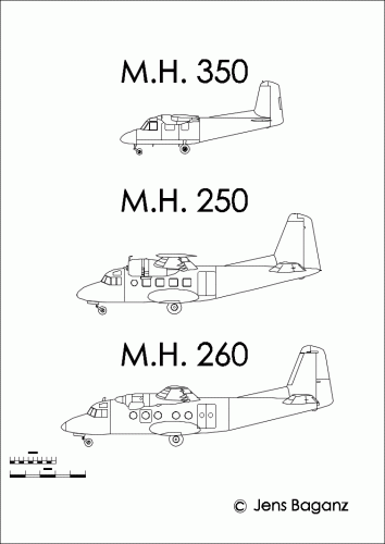

I think, it once was on http://www.mapica.org/, that I've found the following
picture, that, apart from the well known types Broussard and Super Broussard
shows a drawing of an a/c (in the red ring), which seems to be smaller than the
Super Broussard and slightly bigger than the MH 350 light transport. Obviously
fitted with a rear loading ramp, it could have carried a car, but so far I couldn't
find any information. Anybody who knows more about this version,
which, that's for certain, strictly remained a project ?

Cool idea, but looking at the fin, I'm afraid not, because a twin-boom probably
would have twin fins of smaller size. Honestly, the longer I look at this picture,
I think I was wrong, saying this aircraft would have been smaller than the MH.250
Super Broussard. Perhaps it is a transport version of the MH.250 with a loading
ramp ?

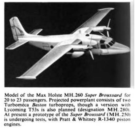

The Max Holste MH-280 was a project to alternative powerplanet
to the Bastan as Lycoming T53 fitted with MH-260.

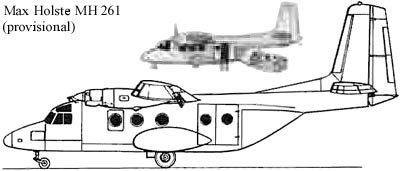

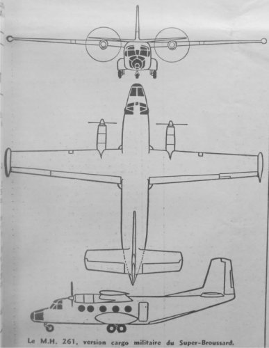

Sorry for reviving this old thread, but browsing through the Cuny book,
it just came to my mind, that the aircraft I asked for more than a year ago,
may be the MH.261, mentioned as contender for the "Avions de coopèration"
contest.
Beg your pardon for the lousy quality of the picture, it's just a blow-up from
the one posted below.
And as we now have a lot of members more, than at the end of 2006, maybe
one of them can shed new light on this theme ... ;)

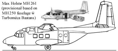

Apophenia
Jul 25, 2007
2,766
1,258
I think you're on to something there, Jens.
The drawing is hard to read but looks a lot like an MH 260 with a ramp.
From what I can make out, I'm guessing clamshell rear doors and a slightly shorter front fuselage to balance weight of the doors/ramp. The boom section of the rear fuselage has obviously been raised and the tail fin/fillet looks different as well.
Jemiba
ACCESS: Above Top Secret
Mar 11, 2006
8,302
1,312
Thank you, what puzzled me, was the impression, that it is shorter, than
the MH.260, but you may have found an explanation. I'll try to find other
examples for such a conversion.
Apophenia
Jul 25, 2007
2,766
1,258
In your image, the nose cone looks shorter as well. I've assumed that was from foreshortening. But perhaps the nose profile was more like the MH 350 than the MH 260?

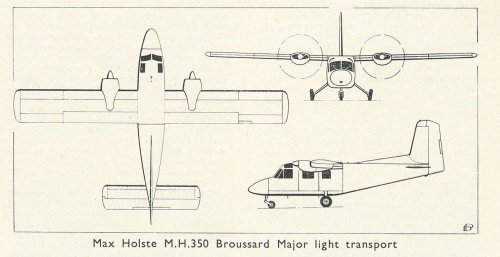

I was thinking about the MH.350, too, but I think, this type would
have been too small for carrying a jeep. But you're right, the nose
really seems to be shorter, than that of the MH.260. Maybe the MH.250 ?

Apophenia
Jul 25, 2007
2,766
1,258
Jens, the MH 350 nose looks right but now I'm wondering about an MH 250 base. Based on your side views, the MH 250 nose looks less pointed (as compared with the MH 261). But the MH 250 fuselage length (fore and aft) and window type/positions (which were hard to 'read' on the original) look spot on.
So ... a revised drawing which basically puts the raised tail/clamshell doors onto an MN 350 fuselage but with Bastans instead of R-1340s. The vertical tail is a bit of a mishmash (the MH 350 tailcone is a better fit but the overall shape of the MH 260 tailfin looks closer).
Of course, it is also possible that I am mistaken on the engines altogether. They looked 'pointy' to me and I read that as turboprops. A simpler answer than my MH 250/'260 mélange is the engines are still radials (perhaps with spinners?).

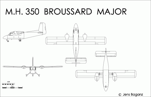

I think, we can rule out the MH.350 as the base for the shown aircraft, as long
as the vehicle, which is unloaded isn't just a motor bike. Fuselage width would
have been under 2 meters.

"Your type seems to be more related to the Broussard-Major "
Well, I had the same thoughts about this type, too, but some measurement
on the 3-view of the MH.350 shows, that the fuselage width would have been
about 1.5 m (about 5 ft ;) ), so loading a jeep probably wasn't realistic, only
loading a motorbike ...

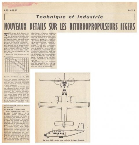

From Les Ailes April 1960, the Max Holste contender for the
"programme d'avion STOL de coopération", the military version
of the MH.260:
Caravellarella
Nov 30, 2007
1,039
234

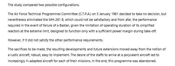

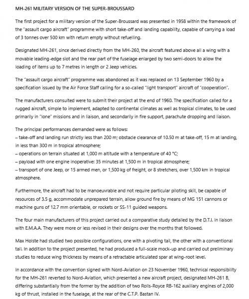

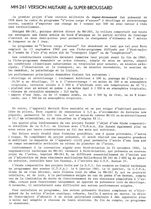

Dear Boys and Girls, here is part of an article in French about the Max Holste MH-261 Super-Broussard twin-engine STOL light military transport "project" which was a mililtary utility version of the MH-260 Super-Broussard light airliner. The MH-261 Super-Broussard remained a "project"......
This is part of a larger article about the contenders for a 1960 Armée de l'Air competition for an army co-operation light transport and the other contenders were:-
Avions Marcel Dassault MD-415 Communauté (prototype).
Max Holste MH-260 Super Broussard (prototype).
Bréguet Br.945 (project).
The article comes from the 27th January 1961 issue of Les Ailes......
Terry (Caravellarella)
  • Max Holste MH-261 Super-Broussard project - Les Ailes - No. 1,810 - 27 Janvier 1961.......jpg

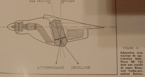

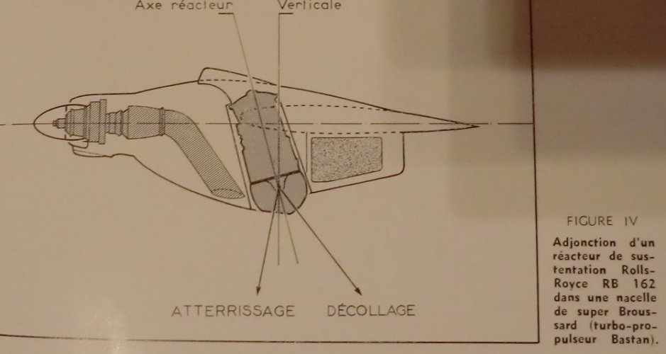

In "L'Air et l'espace", February 1962, I've found a proposal by Nord Aviation to fit a RR RB 162 liftengine to each
nacelle for the Bastan engines, probably improving STOL performance dramatically, although no data was given
in the article.

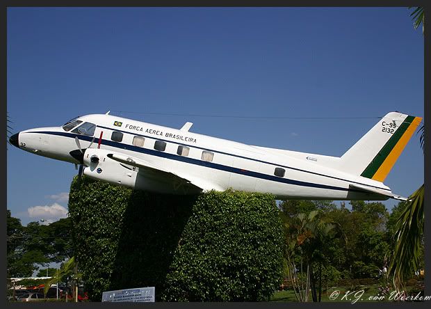

cluttonfred
Dec 31, 2008
1,402
142
cluttonfred.info

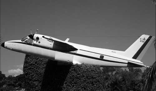

If you detect any similarity between this design and the early Embraer Banderainte, there is a logical reason. Consulting engineer on the project was...Frenchman Max Holste! Here is Banderainte prototype no. 4:
of the MH.260:
Jemiba
Mar 11, 2006
8,302
1,312
Good clue, thank you Mole !
Becames more obvious, if transforming the Bandeirante a little bit, sorry for the
rough, just quick work.

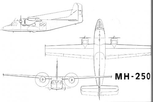

The MH.250 with PW R-1340 S3H1-G 600hp engines, one prototype was built.
A variant with more powerful Wright R-1300 800hp engines was considered.
The MH.260 was a derivative with turboprop engines. The single prototype had Turbomeca Bastan III and later Bastan IV.
Variants with other turboprop engines were planned: MH.270 with Bristol Siddeley P.182 and MH.280 with Lycoming T-53:
http://www.flightglobal.com/pdfarchive/view/1959/1959%20-%200880.html?search=MH.270

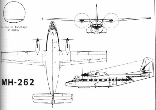

The MH.262 was a pressurized derivative. Its development was taken over by Nord Aviation, and it was built under a modified form as the N.262.
