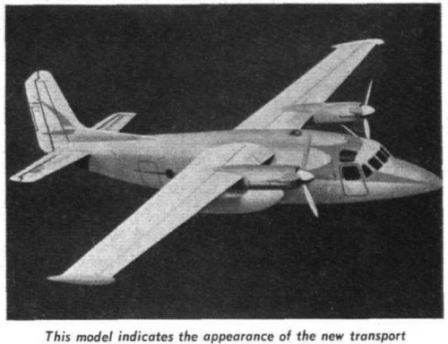

My dear C460,
the two projects are mentioned in Flightglobal,and may be that's a drawing
to one of them;
http://www.flightglobal.com/pdfarchive/view/1959/1959%20-%200880.html?search=MH.270
That article actually mentions the MH.270/280 as MH.260 derivatives, hesham is right.
Those designations just are somewhat out of the line of standard practice, I think, as
minor modificatons were usually marked by a change on the last digit only, or for Max
Holste aircraft, with an additional suffix. And engine changes are explicitly mentioned
as being minor modifications in that design only.
But nobody said, of course, that aircra´ft designations always are following logical rules !
