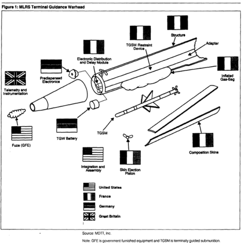

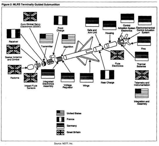

Anything more on the Terminally Guided Warhead? Looks like a kind of proto-BAT.
Some description here:
The MLRS TGW program is a multinational cooperative development effort begun under a 1983 Memorandum of Understanding (MOU) signed by the United States, France, Germany, and the United Kingdom. ... The program is to develop a target-sensing submunition and warhead for attacking armored targets at distances up to 30 kilometers or more.
MLRS is an all weather, indirect fire system with up to 12 rockets. The objective of the MLRS TGW program is to develop a target-sensing submunition for attacking armored targets at extended range. The submunition is to be an all-weather weapon that will use the standard MLRS rocket motor to propel a warhead to the target area where the warhead will dispense three terminally guided submunitions. Each submunition will contain a seeker that is to activate the submunition’s independent guidance and control functions and search for and engage the target.
Congress directed that MLRS TGW and two other target-sensing submunitions be reviewed and that a single option be selected. The Department of Defense selected another system in March 1991.
I'm fairly certain the shape used in the drawings is not exactly representative. Note that LTV's brochure is probably earlier than this report by several years (~1985?). I think the other two systems mentioned in the report are SADARM and BAT, with SADARM being selected for MLRS, then cancelled in FY94, along with TGW.
Development timelines are scattered through this page -- basically, it began around FY84 and was finally killed in FY94.
