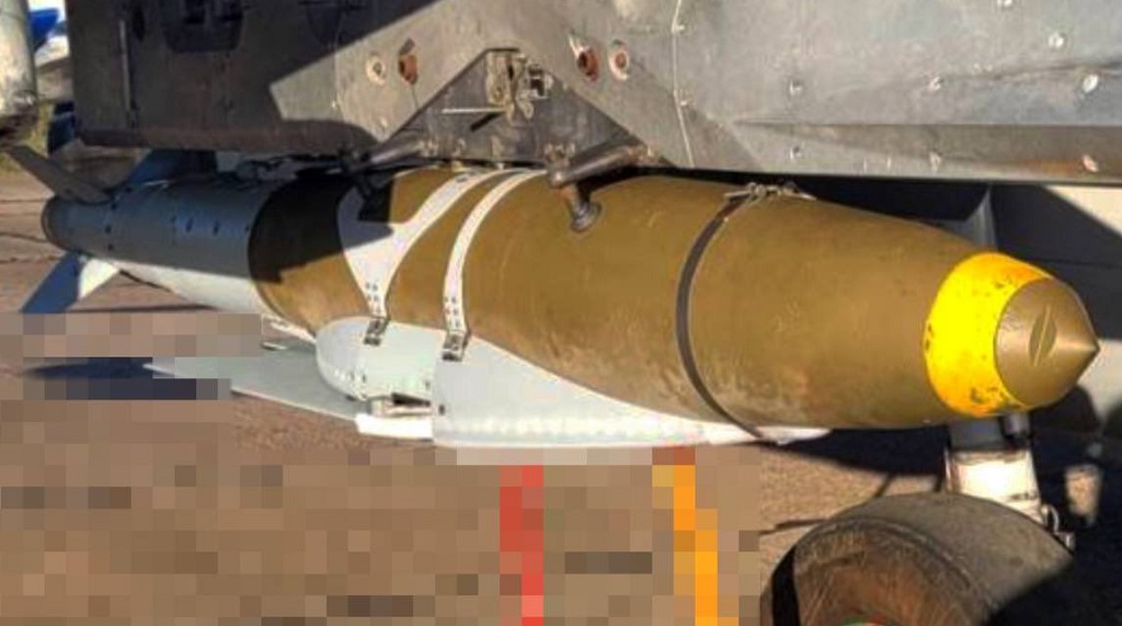

And IIRC there are mass-produced US GPS-jammer HOJ seekers that enable the likes of GMLRS and SDBI to home in on the anti-GPS jammers.
I'm pretty sure that that is still in the research phase as per an article from maybe a year ago? Something about the military funding a college to do the r & d, but I don't believe that anything is yet in production. Could be wrong, though.
In procurement for Ukrainian JDAM-ER (and presumably some US systems as well) last year. In that tread was also a demo from a few years ago using SDB-II. Seems likely to be a fielded capability at this point.

My mistake - it's a company as opposed to a college with the work being stated to be completed by October 1st of this year as per the contract &, as TomS posted with the link to that thread, I guess that it's been in development for a while, now, but I don't know if it's actually in service, at this point. Sorry about that.
