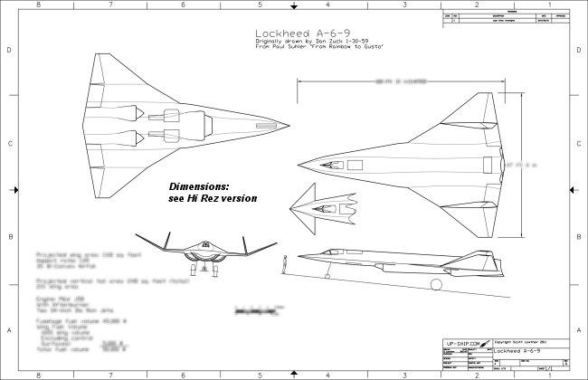

On this subject, the reviewer noticed a couple of drawings marked with the wrong scale, in particular on page 16 and page 108.
Ayup. The lower illustration on page 16 (B-36G/GEBO) is 1/350 scale, not 1/144. Curiously, the original diagram shows 1/350, not 1/144. So I don't know if that's an earlier incorrect version of the diagram, or if something got shuffled somewhere. Also: the top view has a dashed outline of the GEBO, but it barely shows up. Page 108: ayup, again. All are 1/100; that one *isn't* 1/65. That one is definitely on me.
Further, on page 100, the AF-112D drawing, there appears to be an error with the port chine, at the aircraft's nose.
It's not an error... or maybe it is. The original diagram indicates that the IR sensor was covered by a fairing that is either retractable or jettisonable. The intent behind the way the CAD diagram was drawn was to depict that, so it's not an error that it looks like that. But it might be an erroneous *approach* to how to depict that, since it is unclear.
Any other errors, let me know.
Thanks for the clarification on the diagram. Too late for this edition, but maybe a good idea for any future one, to note in the text, or diagram caption that there was to be a fairing over the IR sensor.
That's all I could find, apart from one or two typos, which aren't really worth bothering about (they don't disrupt or alter the text in any meaningful way ).
