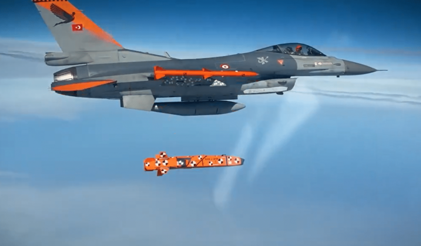

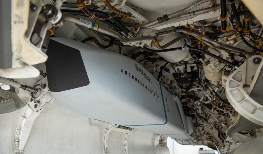

Who would be the potential users of AShMs carried by F-16s?
I suppose Korea and countries in SEA?
My first thought was actually PACAF, as the only other user of LRASM is Australia. With three wings of F-16s, PACAF can take advantage of existing warstock rather than having to wait for B-1s.

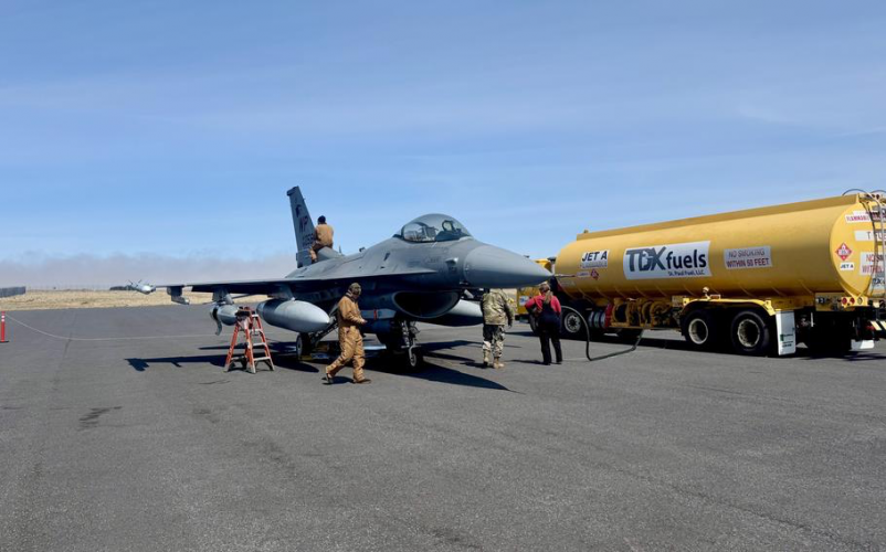

When reading this "Feel Good" story on Stripes, I noticed these F-16's were lacking their "Bird Slicer" IFF antennas on the nose - has APG-83 removed their need?
I don't think so. New Blk 70 aircraft have APG-83 and also still have the bird slicers unless that is a USAF only mod.

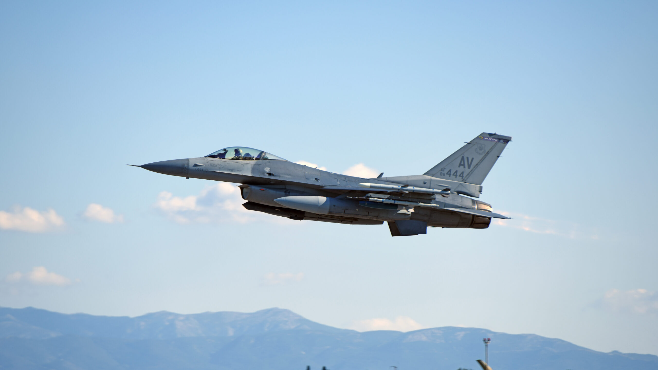

All active duty Block 40 don't have them it would seem... That is units in Korea and Aviano, Italy these days. Block 40 Vipers from Hill AFB also were without bird slicers, but have them now in ANG service.
And Block 42 equipped Oklahoma ANG also have bird slicers, these F-16s should have APG-83, so there is nothing that prevents a Block 40/42 with APG-83 from also having the IFF installed.
Bit late, but 'SEA' didn't cover the full potential set of users, which is anyone who has a maritime border. So: Ukraine, Poland, the Gulf States, Israel and Turkey, though Israel and the Turks will probably use something local.

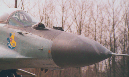

I hope I can ask this question without going completely Crazy Ivan on the thread but... how many fighter jets have the bird slicer IFF arrays in front of the windscreens like the F-16s do? I've seen them, I believe, on the IDF Chung Kuo light fighter out of Taiwan, but I don't think I've seen them anywhere else.
Mig-29. The "defected" ones.
