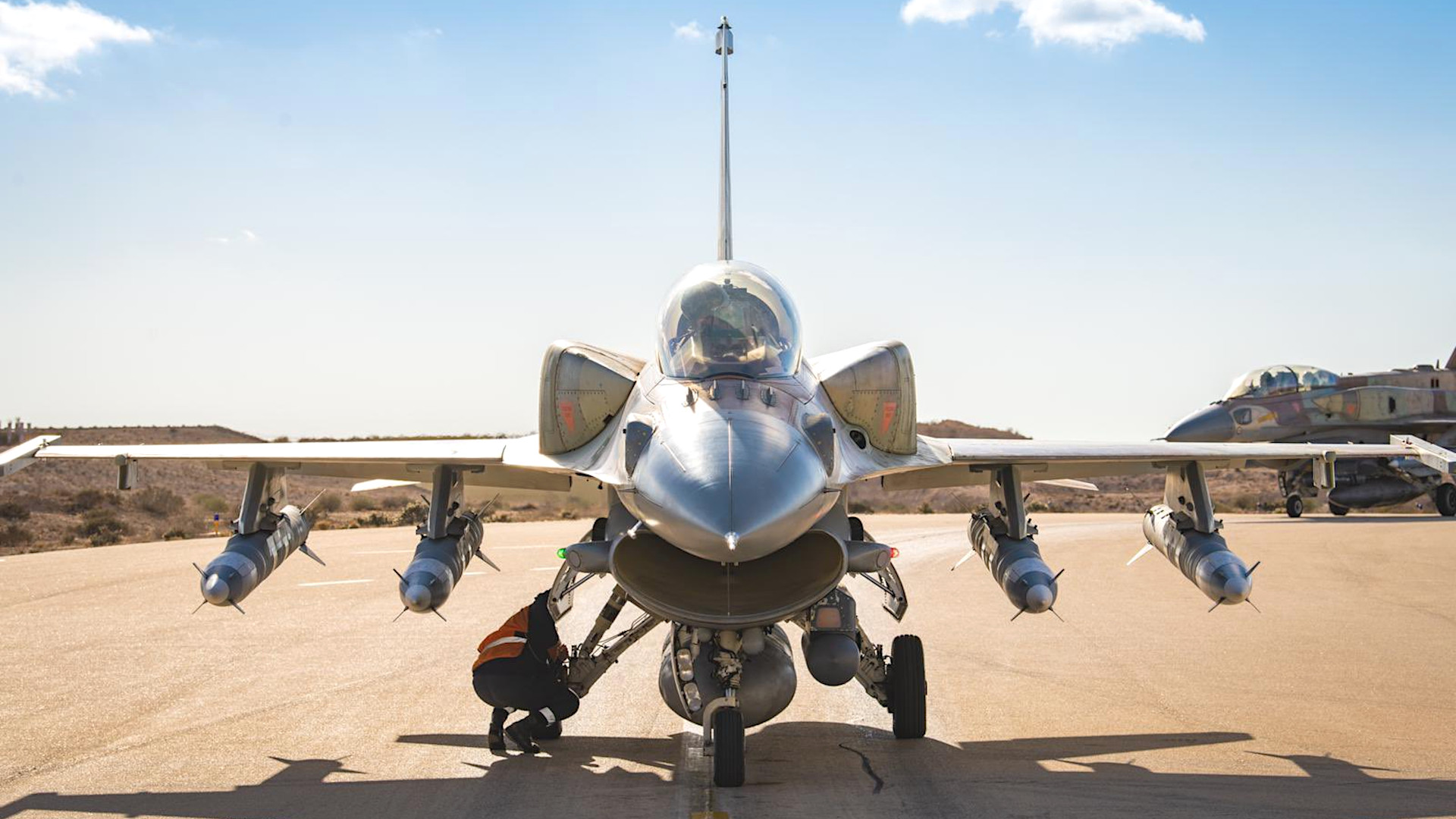

Does anyone know if it is possible for the F-16 to carry 8 total AGM-65s with the LAU-88 triple rack and a single Maverick each on stations 3 and 7?
AGM-65s go on stations 3/7 only. Maximum number is 6 using the triple rack for AGM-65 A, B and D models. The newer AGM-65G doesn't work with the LAU-88 rack so 2 is the maximum on LAU-117 launchers.
