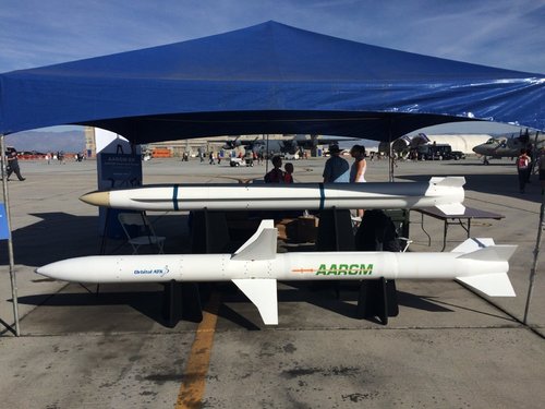

The article notes that the length is not to exceed 156 inches which is 14 inches longer than the AMRAAM at 144 inches.
Does anyone know what the AARGM-ER length is? Seems that is probably the longest one could go inside the F-35's bay. The HARM is around 164 inches in length. Visually, the AARGM-ER would seem close enough to 156 inches given how much bay space it occupies.

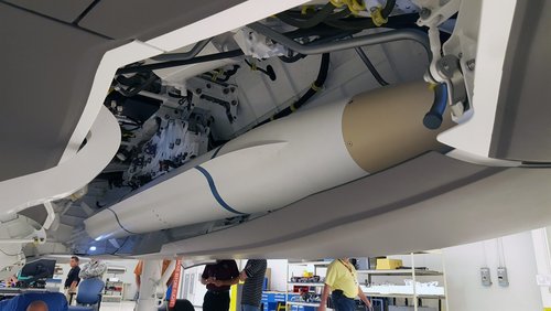

"For example, the USAF is interested in hearing about ideas for lifting body missile airframe designs. This is a radical departure from the tube-and-fins profile that have characterised air-to-air missiles for decades."
Lifting bodies and internal carriage don't mix.
Potential for "Have Dash III"
I'd say so. As long as the overall shape fits inside an AIM-120D "box" there's no reason you couldn't design a missile with a trapezoidal fuselage relying on body shaping for lift. Sounds like a way to get more usable volume in the same OML, at the expense of extra wetted surface and probably extra structural weight.

More usable volume is probably dependent on your propulsion system. A solid motor is always going to be cylindrical so anything outside that is going to be wasted space, more drag, more weight.
True. Thinking about advanced propellants like gels. That lets you play with throttling or even stopping and restarting motors as desired rather than according to a pre-specified schedule. There have been rumors about gels in AIM-120D already.
