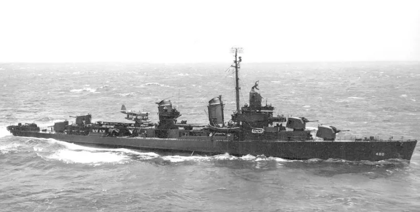

I doubt that it would have been a successful conversion. The Fletcher class weighs in at around 2000 tons. The ship is pretty lively for one handling aircraft of any sort. That would indicate that stabilizers would have to be fitted. That in turn means some rearrangement of the machinery spaces.
Then you need fuel and magazines along with at least some basic maintenance space to support the aircraft. Add in fueling pumps, start stations, and other equipment needed to handle the Harriers, and you are likely to find there simply isn't enough space on the hull to do everything and adding superstructure to house it would create additional instability.
The WW 2 Fletcher class could barely support a catapult and floatplane.
I'd add that the width and heigh above waterline of the flightdeck would be additional issues.
Then, going to all this effort to put Harriers aboard and not upgrading the various weapons and sensors (other than those needed for flight operations which would have to be installed in any case) would make the Harrier version kind of worthless.
I'd assume that helicopters could be an alternate on such a ship, and at that time that means ASW capacity needing the ship to get a much better sonar suite along with some NTDS capacity to make use of the helo's.
On the whole, this idea is too much upgrade to too little ship. Even the Gearing class couldn't handle a small ASW helicopter like the SH-2 Seasprite on about a thousand more tons of hull.

Considering Chakri Naruebet and even Garibaldi are considered by some to be too small to be effective operating Harriers how can anyone seriously contemplate a single Harrier on a WWII vintage destroyer?
