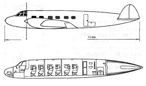

  • KhAI-AVIANIVTO-9 was a project for a twin-engine and twin-fin passenger aircraft of 1934, powered by 2 M-34 engines of each 750HP. Construction never began. Please find 2 sketches below.
    Project datas : Lengh 12.40m - Wing surface 77.5m² - Empty weigh 4,280kg - Taking off weigh 7,200kg

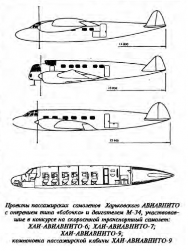

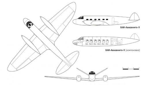

Three view's of KhAI-AVIANIVTO-9 and its predecessors (1934-1935) All with engines M-34.
drawings V.Egorov magazine "Крылья"

Aircraft KhAI "Aviavnito-6"; KhAI "Aviavnito-7", and KhAI "Aviavnito-9" were united by the common theme of "STS" - Skorostnoy Transportniy Samolet (High-Speed Transport Aircraft), and intended to contest for the modern, high-speed passenger plane, organized by the engineering society "Aviavnito".

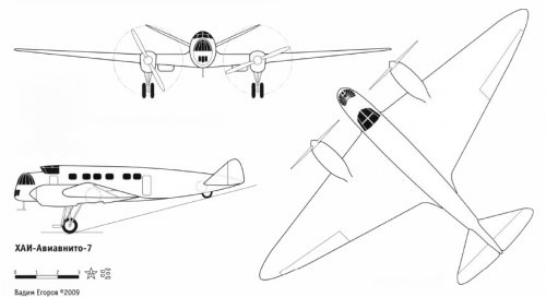

KhAI "Aviavnito-7" also elaborated upon and for possible military use as a bomber. Maybe if successful for him
designation was reserved KhAI-7, (yet unknown)

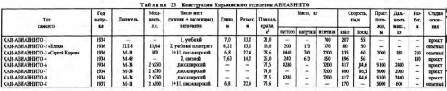

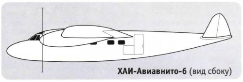

A bit more on Kharkov Aviation Institute Aviavnito projects from the V.S. Savin book called Aviation of Ukraine (Osnova Publishing 1995).
Here are the data tables in Russian for the various KhAI-Aviavnito projects as well as side views of the KhAI-Aviavnito-6 ,7 & 9 fast transport projects and a side view of the KhAI-Aviavnito-9 internal plan at the bottom.

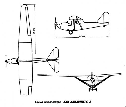

Here is the KhAI-Aviavnito-2 "Blokha" project, a tandem-seat open-cockpit lightplane, a kind of powered glider:

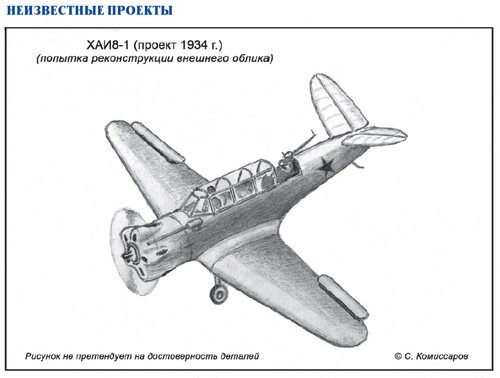

From Kryl'ya Rodine 11/12-2019,
and from a Russian book,I think the Aviavnito series was not always indicated to it by KhAI designation,here is a strange Info about KhAI-7,a dive attack bomber Project,but maybe they was wrong or misprint about the date,I think they meant 1935 (not 1955),also from this magazine,the KhAI-8 was appeared as
a Project for recce/observation low-wing airplane,with butterfly tail,and it was created in three variants,who can help us ?.

In this article the author pointed out that this figure is the fruit of his imagination. Therefore, this picture can not be taken for the original

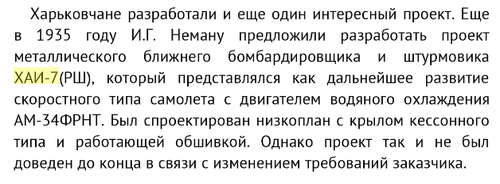

Very Strange,the translate;
Kharkov residents have developed another interesting project. Back in 1935, I.G. Neman was offered to develop a project for a metal short-range bomber and attack aircraft KhAI-7 (RSh), which was presented as a further development of a high-speed aircraft type with an AM-34FRNT water-cooled engine. A low-wing wing with a caisson type and a working skin was designed. However, the project was never completed due to changing customer requirements.
