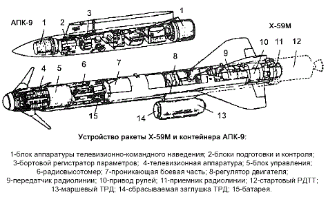

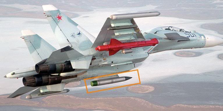

Could our experts explain please which datalink and/or targeting pod is used with the Kh-59 Ovod AGMs/ASMs?
Is the Kh-59M always used with the APK-9(E) made by Raduga and Tekon of Ukraine? Is the Kh-59ME used with newer APK-9ME pod?

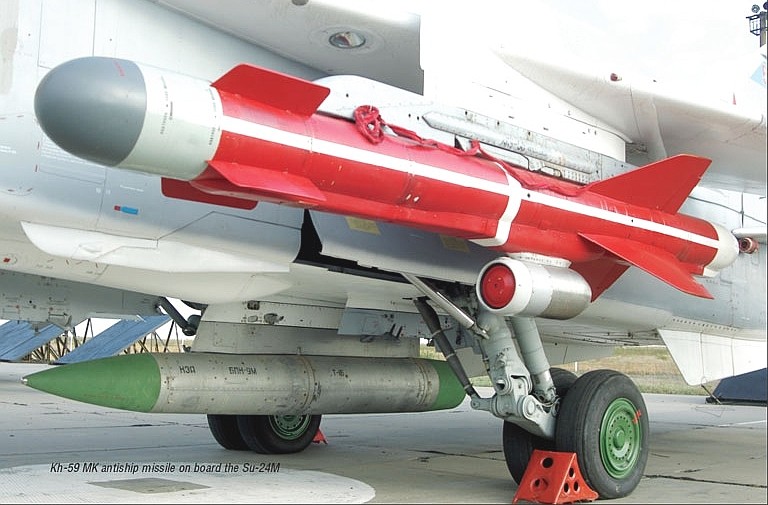

Is the Kh-59MK used with the BPN-9M as suggested at http://mail.ausairpower.net/APA-Rus-ASM.html

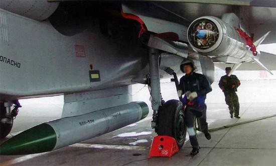

And what about the BPN-59M pods like the one fitted to the PLAAF (?) fighter below? Are these used to fire the Kh-59ME or the newer versions of the Kh-29?
Which a/c do not require an external datalink pod to fire the Kh-59s?
