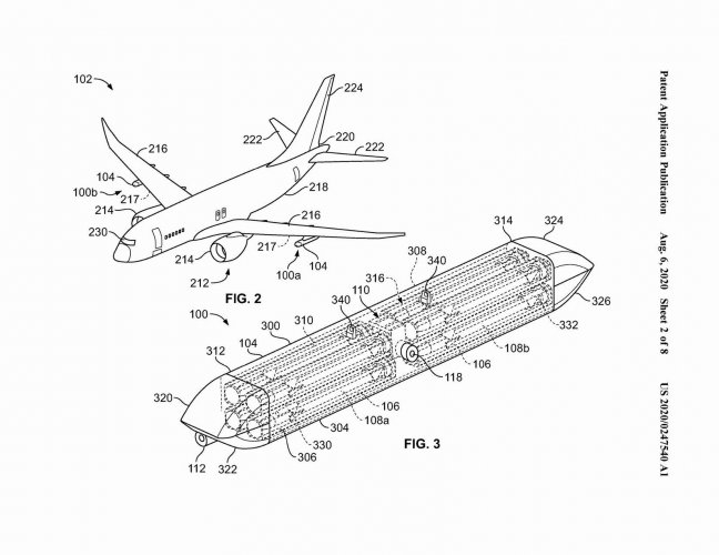

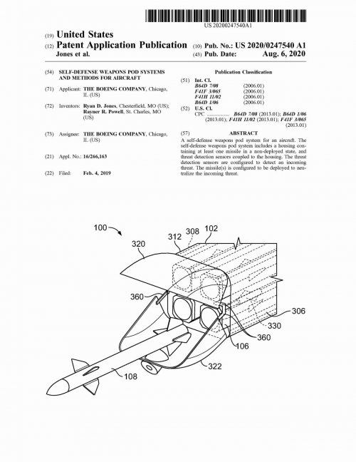

It's a tanker, give them some Sidewinder rails!
Don't be that cheap... a missile pod at least.It's a tanker, give them some Sidewinder rails!
So MDSM still lives...
Yes, a pod would be less drag.Don't be that cheap... a missile pod at least.
Only if they have a rear ramp.A little lateral thinking perhaps but, could they not also use a LO tanker as an 'Arsenal airframe"? Somewhat similar to the suggested us of heavy lift airframes.
Possibly even a 'palletised' system akin to 'Thunderbird 2'?
For tanker self protection...?Wouldn't a YAL-1 style laser be ultimately better than stuffing missiles on a tanker?
