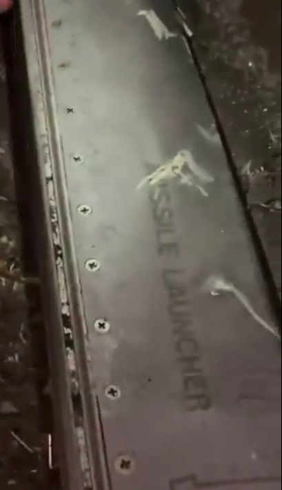

Looks nothing like SU-30 tails but I’m sure Pakistan will officially still make the claim. Could be landing gear from a drone. Both sides lie profusely about losses every time there are skirmishes, it’s to the point that it’s comical, it’s always eye witness, some grainy videos of puffs of smoke or clouds, or some other BS.
So far it looks like there is some wreckage of a Mirage with Mica missiles? And some unknown wreckage that both sides claim to have shot down. Pakistan says it’s a Mirage, India says it’s a JF-17, it’s hard to tell what it is and based on wreckage it can be either, lots of evidence points to it being a JF-17 but then lots of evidence goes the other way.

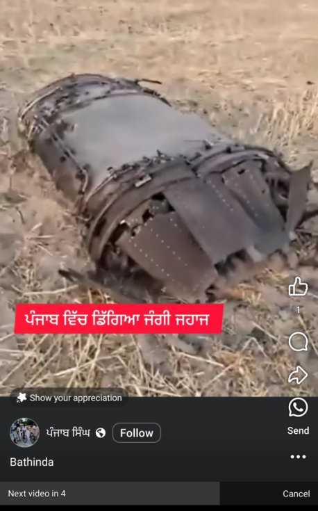

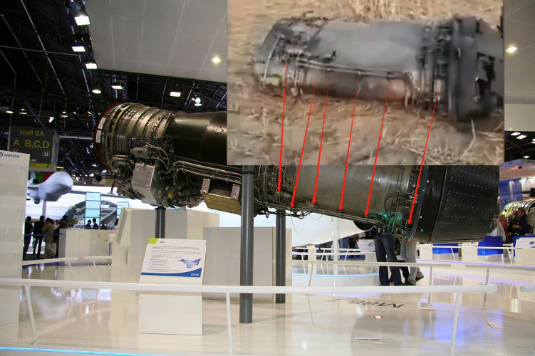

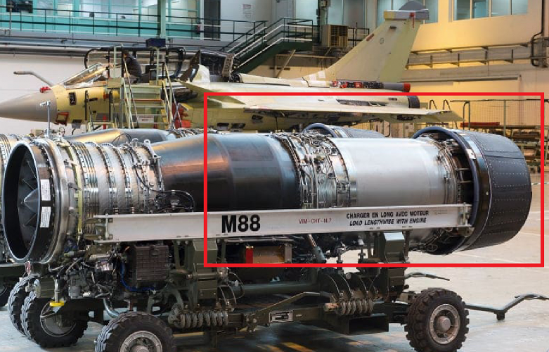

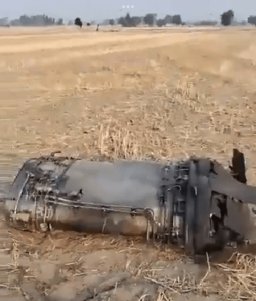

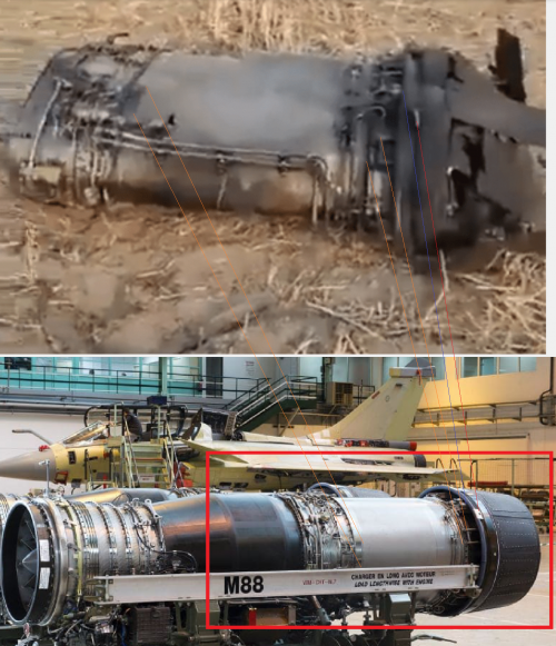

If I may quote my post from the Rafale thread, this seems to be the remnants of a m88 engine, which could further point towards the Rafale claim.
Can anyone more versed with French aviation help me out here? I think this is part of the back section of the M88 Engine, does that seem like correct speculation?

I'm almost sure this is part of an M88 the riveting on the feathers are of the same color, all the fuel lines match, and so do the hinges and rings.
It definitely looks like it’s from a Rafale. This further reinstates my suspicion that Indian military planers have the IQ of a door knob. This aircraft has the abilities to strike targets from hundreds of KMs away, their jammers and RCS is also reportedly impressive so how does this happen? Either Pakistan has world class aircraft and SAMs or Indians are using Rafales as dive bombers
