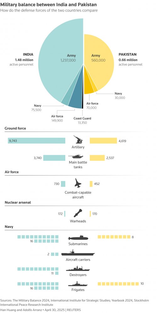

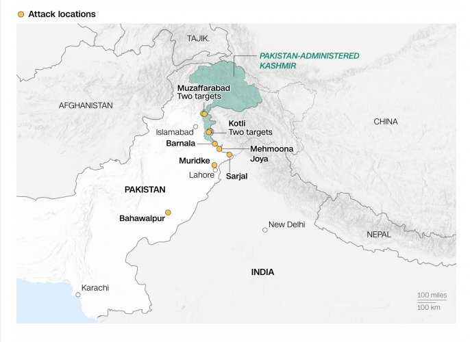

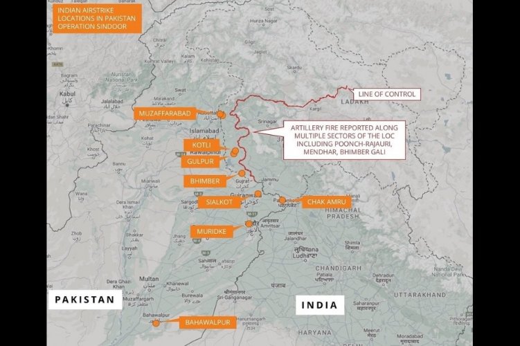

In the early hours of May 7, India launched a series of missile and air strikes — designated Operation Sindoor — against nine sites across Pakistan and Pakistan-administered Kashmir. The operation was presented as retaliation for the April 22 Pahalgam attack, which killed 26 civilians, most of them Indian tourists. According to Indian officials, the strikes targeted terrorist infrastructure linked to groups such as Jaish-e-Mohammed and Lashkar-e-Taiba.
While several targets inside Pakistan were reportedly hit, greater attention has focused on the apparent success of Pakistan’s Air Force in shooting down multiple Indian aircraft — including a Dassault Rafale F3R multirole fighter aircraft, the most advanced platforms in India’s inventory, introduced only in July 2020. This post summarizes the available information, and outlines some initial implications.
Weapon systems and casualties
According to Indian sources, Indian forces employed SCALP-EG land-attack cruise missiles and AASM HAMMER guided bombs during the strike. India likely operates the export variant of the SCALP-EG, which has a reduced range of approximately 250 kilometers. The HAMMER guided bombs have a maximum range of up to 70 kilometers, assuming release at optimal altitude and speed (i.e. high altitude/high velocity).
Following the attack, images surfaced on social media showing the booster section and nose cap of a BrahMos PJ-10 cruise missile recovered on Indian territory. Both components are jettisoned shortly after launch, indicating that the missile was used in the operation. The BrahMos is a supersonic cruise missile based on the Russian 3M55 Oniks and was developed by the Indo-Russian joint venture BrahMos Aerospace, and has a range of 300-500 kilometers (depending on the variant).
However, rather than focusing on the targets struck and ammunitions used, much of the attention shifted to Indian losses. Shortly after the operation, Indian news outlets reported that Pakistan had shot down several Indian fighter jets involved in the strike. These reports were later deleted, likely following pressure from government officials—a pattern not unfamiliar in the context of past India-Pakistan military engagements.
That said, some Indian casualties have since been confirmed, and the available evidence does not reflect well on India’s performance.
Imagery of wreckage suggests that India lost at least one Mirage 2000H, one MiG-29UPG or Su-30MKI (imagery shows the K-36DM ejection seat, which is used in both aircraft, leaving the identification uncertain), and one Dassault Rafale F3R. Among these, only the downing of the Rafale has been officially acknowledged—confirmed by a high-ranking French intelligence official, according to CNN.
Interestingly, all wreckage has been located inside Indian territory, in some cases as far as around 100 km behind the border, indicating that Indian aircraft likely did not attempt to penetrate Pakistani airspace, which aligns with the use of stand-off munitions.
To down the Indian multirole fighter jets, Pakistan reportedly used the PL-15E — a claim supported by recovered missile debris and components. The PL-15E is the export version of China’s PL-15 beyond-visual-range air-to-air missile (BVRAAM). It has a range of approximately 145 km, compared to the 200–300 km range of the domestic variant. The missile features a dual-pulse motor (providing burn-out speed in excess of Mach 5, then gradually slowing down), midcourse guidance via data link, and an active AESA radar seeker for terminal homing.
The PL-15E is integrated with Pakistan’s JF-17 Block III and J-10CE fighter aircraft. The J-10CE is equipped with a larger nose cone and a more powerful AESA radar, and can detect and track targets at distances exceeding the maximum range of the PL-15E. In contrast, the smaller AESA radar on the JF-17 Block III has a detection range of only 100–120 km, and is therefore unable to exploit the missile’s full range. Given that the downed Indian aircraft were located deep inside Indian territory, it stands to reason that J-10CE aircraft were used to launch the PL-15E missiles. However, this remains unconfirmed, and midcourse guidance could also have been provided by other assets — most notably Pakistan’s Saab 2000 Erieye AEW&C aircraft, of which it is known to operate nine.
