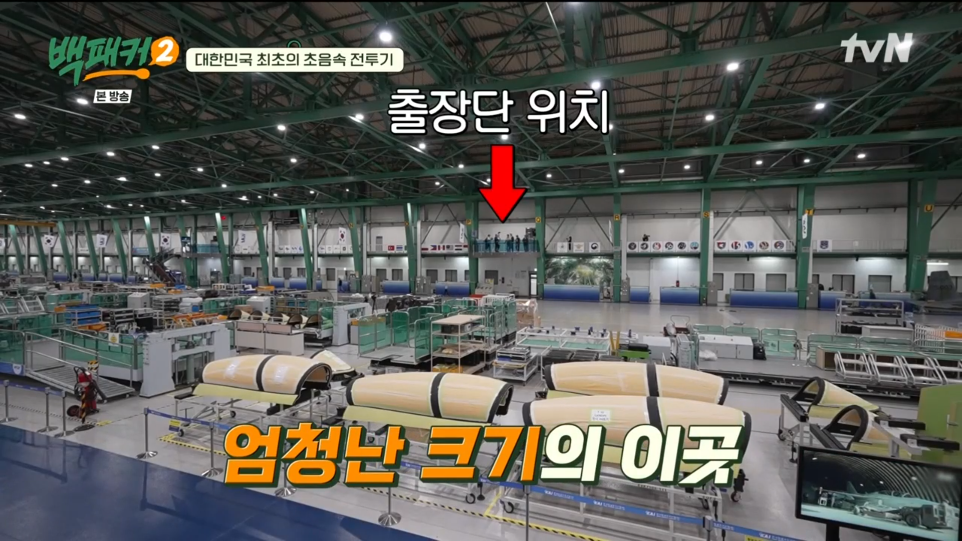

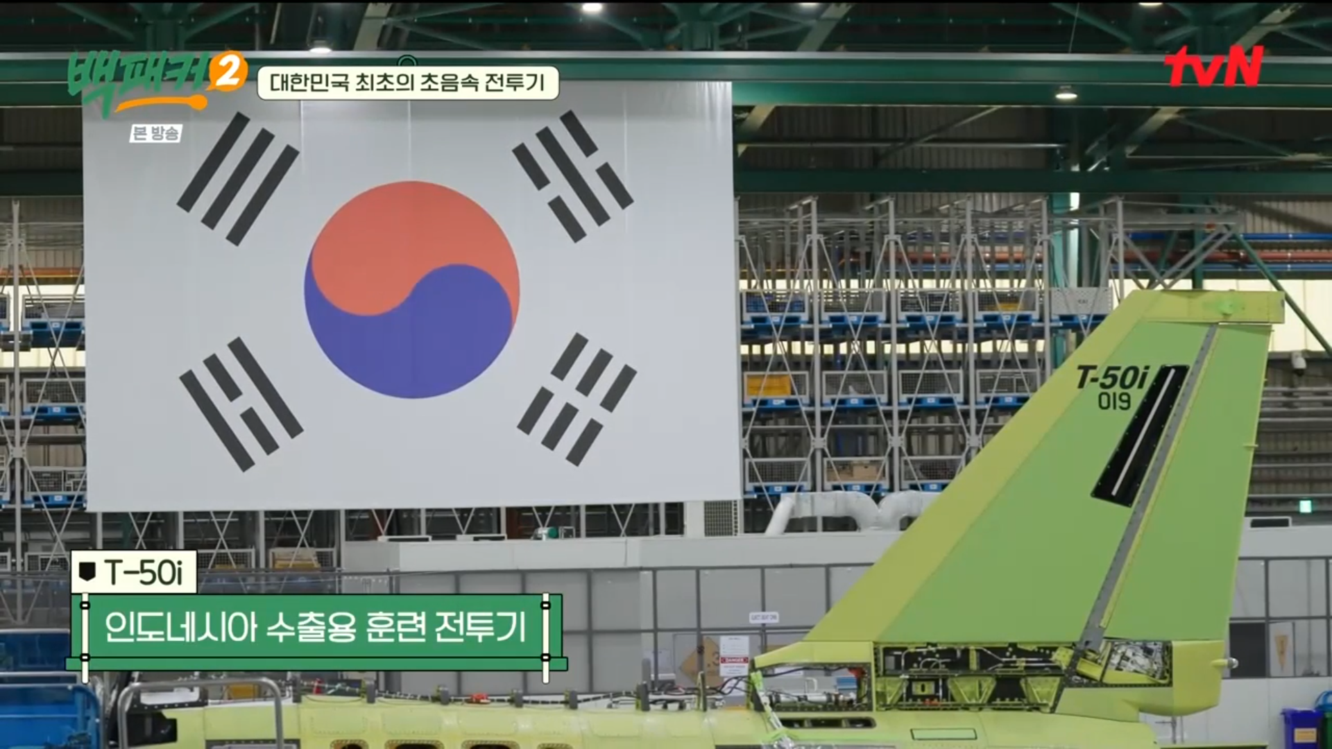

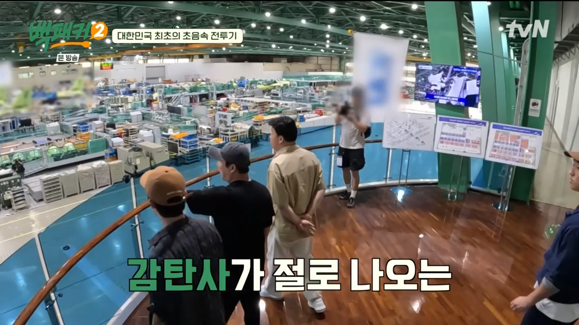

The KAI production line was shown in a Korean TV show. The T-50/FA-50 line is running non-stop, and it's been a while since we've seen news about the T-50i. I think it was filmed in August.
