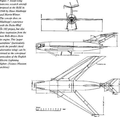

During your researches did you uncover anything more on the RAE. (Multhopp/Winter) Transonic Research Aircraft studies ? ... https://www.semanticscholar.org/pap...ahum/7687b66e87e0e97e1da40349c2bc3704b64a047f
https://www.secretprojects.co.uk/th...zAqGuPbXHa8duG92jA_aem_KplNeQhgAma23oXPJsPnDQ
Yes, the original design report from the RAE and his associated civil service records.
He states in the report it is based on his own Fw183 design from 1944-45 (he does not call it the Ta183).
That design is the start of the Lightning. In the picture you post you can even see the untapered wing platform eventually used, as the caption points out.
