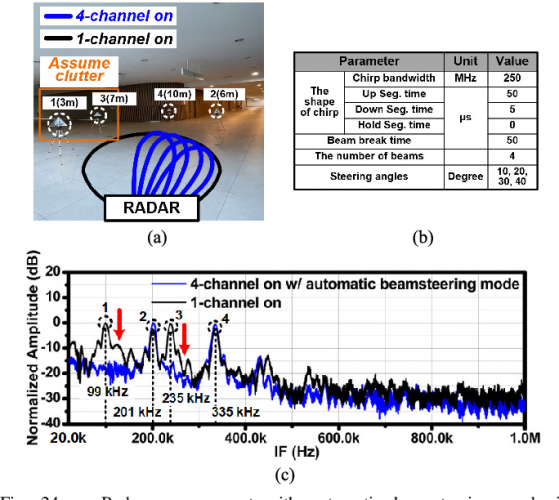

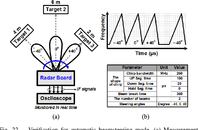

https://arxiv.org/pdf/2402.17607
Although this paper does not directly address your specific question, it outlines general concepts regarding various phased-array radar configurations.
The details provided in the explanation for Fig. 2—such as the radar beam illumination time of 10 ms—might be particularly useful to you.
You might find even better information by searching for the term "radar resource management." My area of expertise is MIMO communications rather than radar, so I am not deeply familiar with the field, but I hope this proves helpful.
