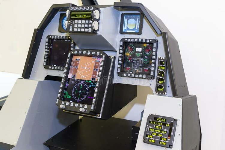

ENGINE INDICATOR DISPLAY:
Compact, platform-specific configurable and user-friendly design, EID unit; It meets user needs and platform requirements for displaying engine parameters, which are critical platform data. With its redundant and reliable design, it will make pilots feel safe even in difficult flight conditions.
FUEL HYDRAULIC DISPLAY:
Compact, platform-specific configurable and user-friendly design FHD unit; It meets user needs and platform requirements by providing an indication of the tank fuel amount, hydraulic pressure and fuel balance status, which are critical platform data, to the pilot. With its redundant and reliable design, it will make pilots feel safe even in difficult flight conditions.
INERTIAL NAVIGATION SYSTEM:
Inertial Navigation System - INS; These are the systems that can produce navigation information and navigation performance information on their own. These systems operate by expressing the response of the gyroscope and accelerometers to the movement with numerical values. Since there is no signal received from any ground station, it is closed to signal mixing sabotage. INS does not need continuous data retrieval after entering the required initial values.
SYSTEM INTERFACE UNIT:
The system interface unit reads many analog system parameters, converts them to numbers and makes them available to pilots. It produces analog driving signals in accordance with the commands of mission equipment. SIU meets all the tough environmental requirements of the combat aerial platform thanks to its reliable and robust design
• Internally Redundant
• Analog Interface with Aircraft Systems
• Digital Interface with Mission Systems
NATIONAL MISSION COMPUTER:
National Mission Computer (MCS) is a new generation mission computer that provides the management of integrated avionics systems from a single center and supports the pilot with improved processing and graphics capabilities during the mission. By using two MCS, double redundant tactical mission management architecture can be created.
Abilities:
• Avionic System Management
• Platform Interface Management
• Operator Interface Management
• Symbology Production and Multifunction Display Management
• Head Up Display Management
• Communication and Identification Management
• Navigation Management
• Tactical Reconnaissance Management
• Emergency Mode and Reset Management
• Task Planning, Task and Test Data Upload / Download Management
• Synthetic Image Creation (3D Terrain) and Digital Sliding Map Management

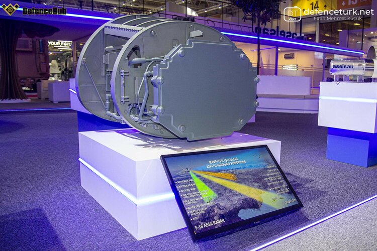

AESA RADAR
-GAN based
-1000+ T/R modules

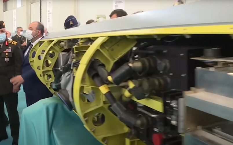

F-16 Block 30 which will receive 'Project Liberty' modernisation are having airframe life extensions, life extensions were done domestically without Lockheed Martin. Turkey has around 40 Block 30s.
“In the project, where engineering works are carried out for the renovation and revision of 1,200 to 1,500 structural parts per aircraft, repair, and replacement and fuselage reinforcement applications are carried out where necessary,” Demir explained. “We aim to increase the structural life of our F-16 aircraft, the main striking element of our air force, from 8,000 hours to 12,000 hours.”

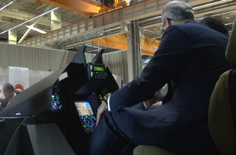

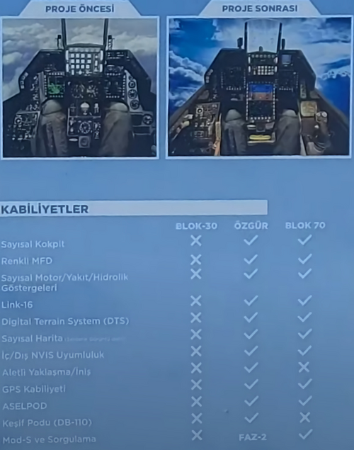

Left side is Block 30, right side is Ozgur Modernisation
in which case US gov may deny Block 70 upgrade, Turkish President has said Turkey will push forward with implementing Ozgur project on all blocks of Turkey's F-16s.

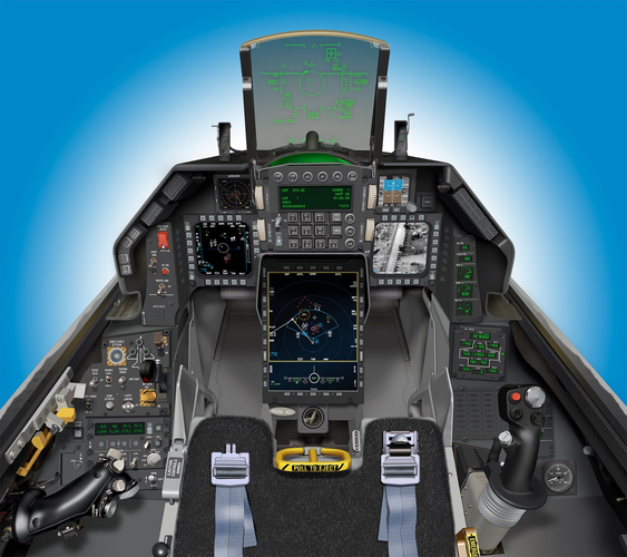

Block 70 cockpit for comparison

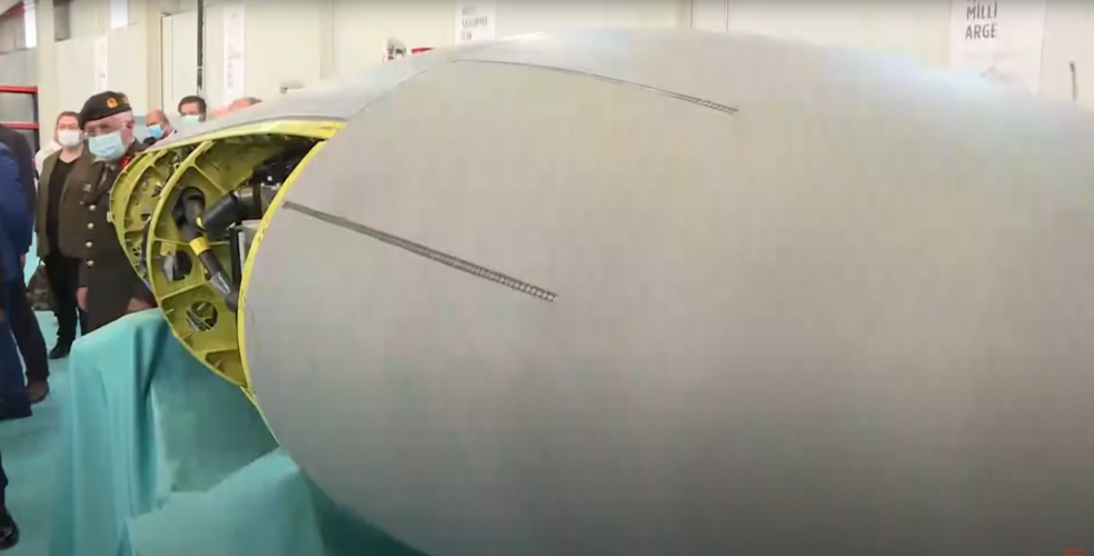

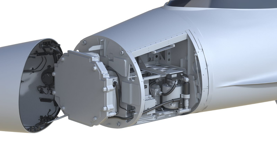

it might be quite heavy since a lot of internal volume and material are dedicated to structural bracing.
A report on the project can be found here; no mention of the weight, but does mention materials utilised for weight consideration.

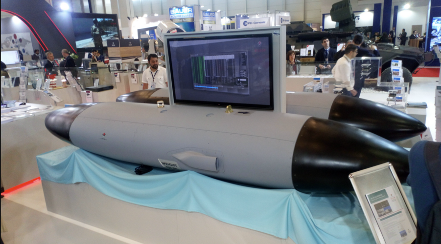

"The outer shell geometry of the 4-meter long EHPOD was designed as similar as possible to the external centerline fuel tank of 300 gallons (1.150 liters) of the F-16 Aircraft. Aluminum alloys and composite materials (for a light weight and resilient product) are utilized in the production of the pods. "

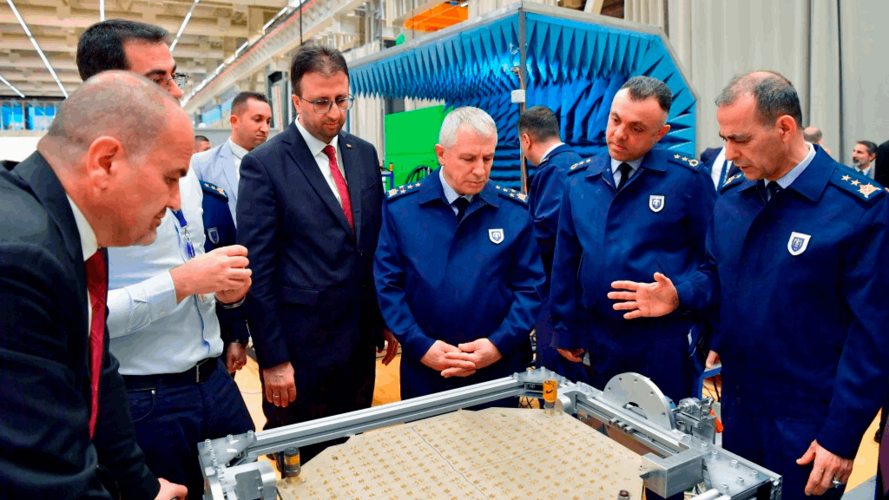

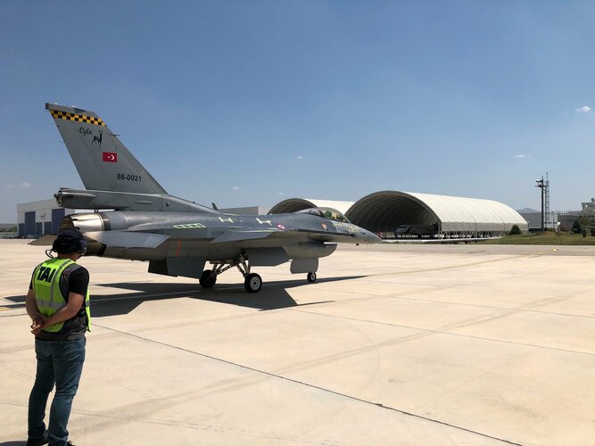

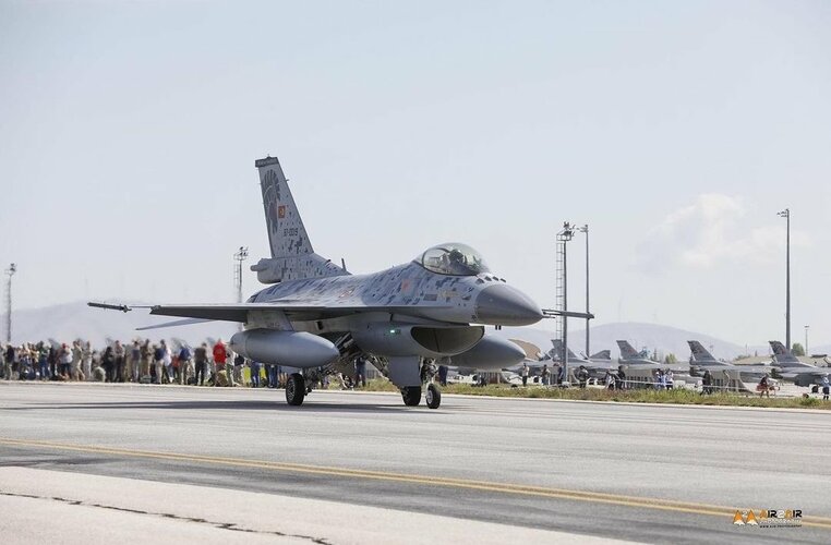

Not to be confused with the one in May last year. That aircraft was the prototype and was handed over for qualification. These 3 planes are delivered to operational squadrons. Before you ask, no, they don't have that "futuristic" digital camouflage :)

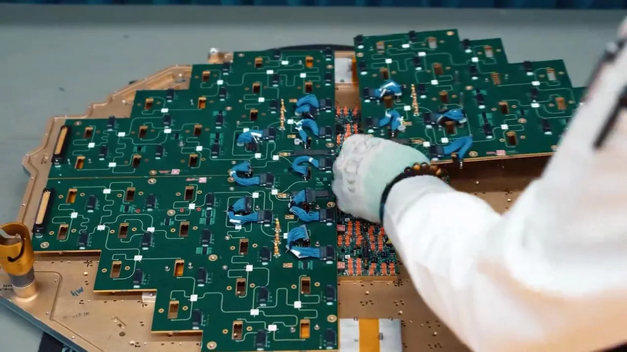

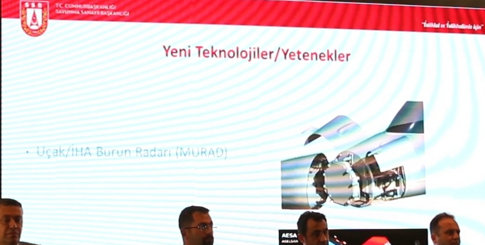

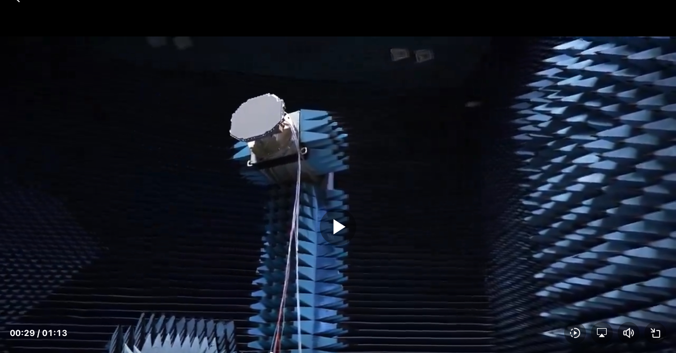

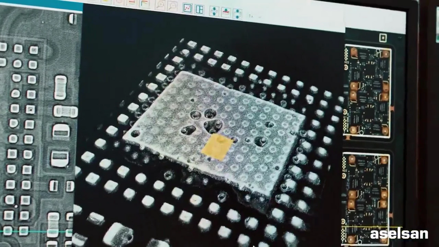

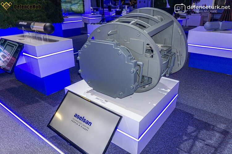

AESA radar developed of the F-16 likely to have over 1,100 T/R Modules
(Acc. to Defenceturkey magazine):
1152 GaN T/R Module
PAE(Power Added Efficiency) : Rumors start from %37 and reach as high as %54
20W nominal 30W peak output power per module (20kW power-30kW peak power for radar plus several kW for accessories like LRUs etc.)
Multilayer LTCC packaging (Low-Temperature Co-fired Ceramic)
SIGE (Silicon-Germanium) multifunction BICMOS IC/Core Chip (either on 130 or 150nm/0.13-0.15μm)
GaN MMIC (likely on 150nm 0.15μm)
Digital beamforming+cognitive radar algorithms.
Specially designed ethylene glycol+water liquid cooling system with microchannels.
Amazing piece of equipement. Also able to do wideband ESM and jamming. This radar puts the Ozgur into 4.5th gen category.
