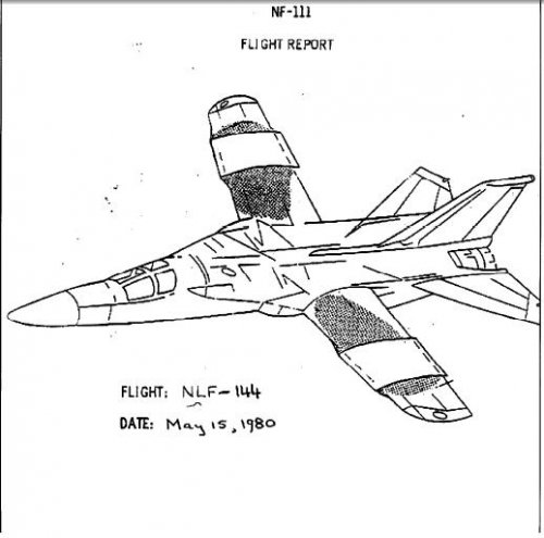

I can't understand what was this modifying in the wing ? page 72.
http://ntrs.nasa.gov/archive/nasa/casi.ntrs.nasa.gov/19990058717_1999088199.pdf
I believe they are wing gloves fitted in 1979 to try to achieve natural laminar flow without airflow modifying devices. Don't know what the results were but I doubt they were successful as any flaw or dirt on the wing would disturb the flow.
Actually the document you posted gives a good overview (pg 17-18). At least better than what I have

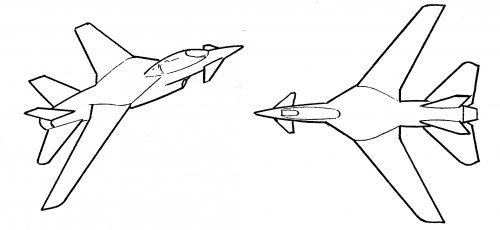

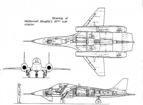

A bit more information on the Fairchild-Republic and McDonnell-Douglas AFTI submissions.
[Reference: Air Pictorial September 1974 (Volume 36 No 9) Page 328]

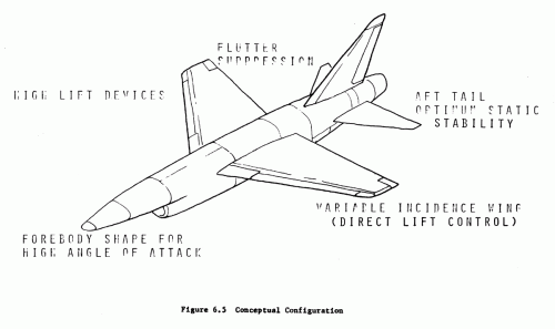

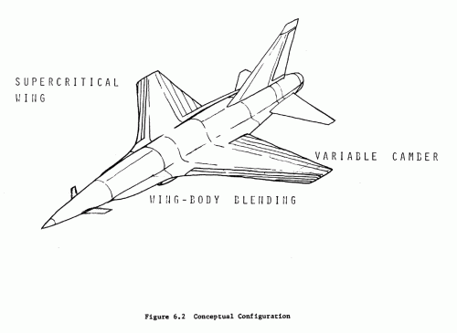

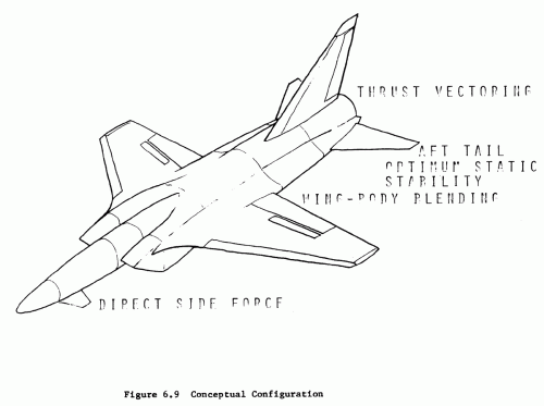

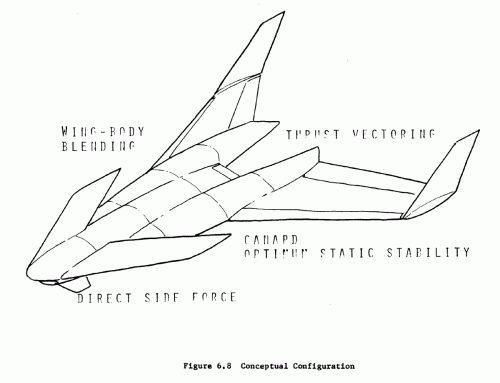

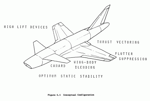

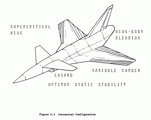

Greetings All -

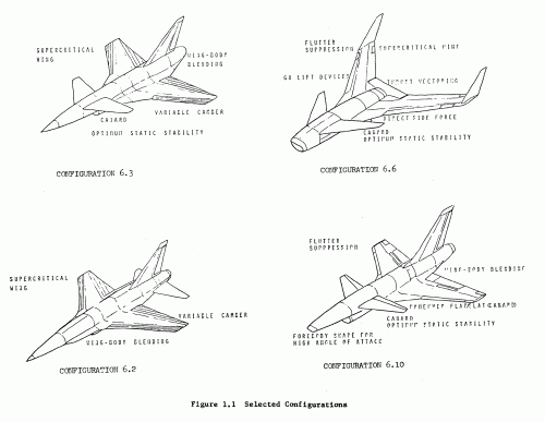

Vought also had designs for HiMat - here's a report and the design configurations noted in the report.
Enjoy the Day! Mark

...and a few more... Mark

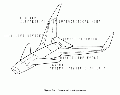

Figure 6.8 Hi-Mat looks like something you would see in one of those crazy anime movies. Thanks for sharing these though.

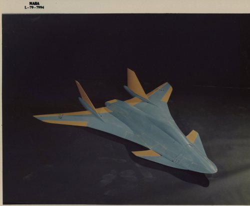

flateric said:
Horribly, horribly mutated HiMAT configuration from
NASA Technical Paper 1427
Aerodynamic Characteristics at Mach Numbers of 1.5, 1.8, and 2.0 of a Blended Wing-Body Configuration With and Without Integral Canards
SCIF-II
http://crgis.ndc.nasa.gov/historic/Additional_Photos_for_12-Foot_Low_Speed_Tunnel_2#SCIF-II_Model

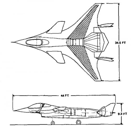

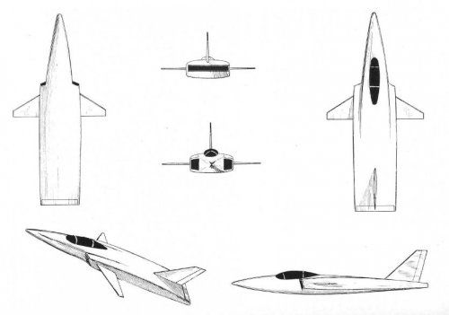

The Fairchild AFTI 3-view proposal.
