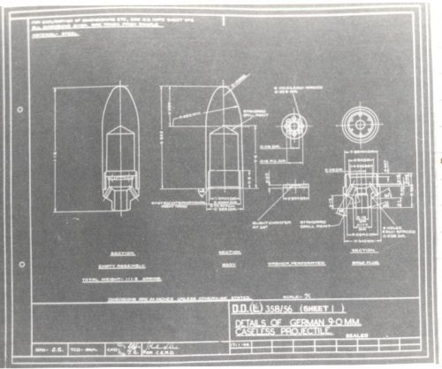

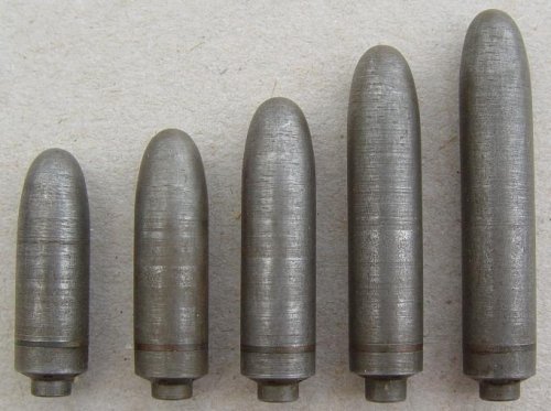

shaba said:
here is some more on the gyro jet http://www.deathwind.com/project.HTML does anybody have information on pre gyrojet rocket smallarms Ian V, hogg describes a German ww2 project and a fifties U.S army project that led to gyrojet.
[quote author=colonial-marine]
Are there any records of the Gyrojet seeing use in combat (in Vietnam) by soldiers who bought them? [/quote] The Deathwind project site has some testamonials on operational use of the Gyrojet pistol including some on Vietnam: http://www.deathwind.com/review.htm This site describes a "rocket-musket" developed by Denmark, though it was mostly used for incindary effect or signalling. http://www.milhist.dk/vaaben/lands/rifle_rockets/rifle_rocket_uk.htm Side note here; Somewhat related to the development of rocket Arms by Denmark ended up in the development and deployment of a "Metalstorm" type weapon system in the early 1800s. Called the "Espingolen" it fired a consecutive set of "nested" ball-and-powder charges with the barrel/magazine being removed and replaced with a fresh one once discharged. http://www.milhist.dk/vaaben/lands/espingorgel/espingorgel_uk.htm Randy
