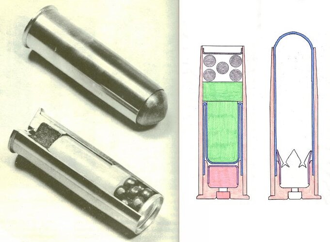

In the article is a section on "silent pistols" (on page 86 of the magazine). Here is mentioned four different types of "silent"ammunition. The Russian 7,62x42mm SP-4 is well known (http://www.quarry.nildram.co.uk/sp-4_topE.jpg - unfired on the left, fired on the right - and http://world.guns.ru/ammo/sp-e.htm#SP-4), as is the American .40 QSPR (http://world.guns.ru/handguns/hg213-e.htm).
Both these designs use a captive piston in the cartridge case, situated between the (necessarily small) propellant charge and the projectile. Upon firing the propellant gas pushes the piston, which pushes the projectile. Once the piston reaches the mouth of the cartridge case it is "captured" by a crimp or ridge in the case, holding back and containing the propellant gasses, preventing them from escaping rapidly. This seriously reduces the noise of firing, reportedly almost to the level of the "click"of the hammer/firing pin striking the primer. According to http://world.guns.ru/handguns/hg213-e.htm: "The sound signature of QSPR round fired from QSPR revolver was about 110 dB, or similar to that of traditionally silenced .22LR"
