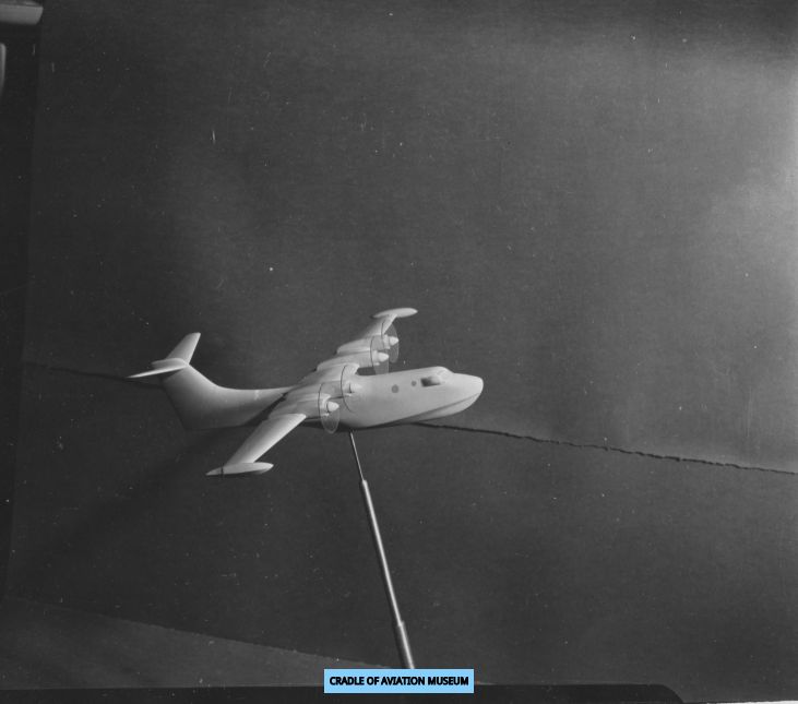

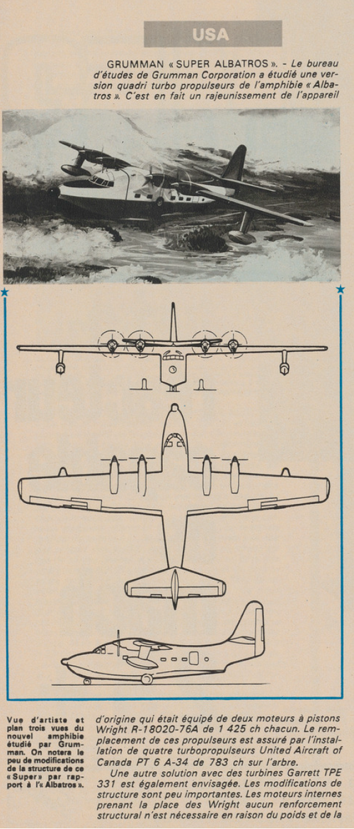

I’m looking for the Grumman design number of this ”Albatross“ turboprop conversion. I only know it’s NOT the G-305 (another proposed four-engined turboprop flying-boat for ASW duties from 1961). Any idea of the G-xxx number?
SOURCE: “Der Flieger“ 11/1968

Four engines?
It doesn't surprise me, because four 750hp PT6 category turboprops were cheaper and lighter than a pair of Darts or T55s.
I do wonder what engines were being considered?

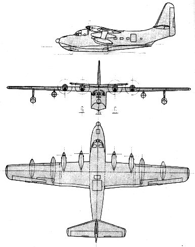

For comparison, this is the mentioned G-305 from René Francillon’s “Grumman Aircraft since 1929” (Putnam), powered by four GE T64-GE-4.
Hesham, I only know of the existence of a projected G-215 (Nov 1959). Please, more detailed information on the G-251.

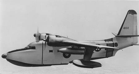

Dear boxkite,
The Grumman G-251 was a version of G-231, which also entered service
with USCG,but I have not any picture,the only I find was for G-231,which
called G-111-2

The info about G-305.
Could that Der Flieger image represent the unbuilt Frakes proposal to refit the Albatross with four 1,000 shp PT6As?
American Flying Boats and Amphibious Aircraft (pg 243) also mentions a proposal to re-engine the Albatross with four 1,100 shp Garrett TPE331s but doesn't name the company involved.

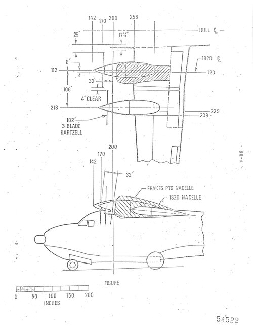

Good Day All -
From the Matt Rodina collection, a xerox copy of a proposed 4 PT6A powered Albatross. Based on the radar nose and interior arrangement, this is not the Frakes 4 engine proposal but may likely be the Grumman proposal.
I have a Frakes proposal summary for a 4 engined Albatross, date September 1985, addressed to a Michael Braunstein. This proposal is from Matt's collection and outlines a program where Frakes teams up with P&W Aircraft of Canada that lists four engine options - PT-6A-34, PT6A-42 and PT6A-61 and a twin engine option using the PW120. Interestingly, that is the only mention of the PW120 in the proposal - all the performance curves in the proposal are for the three PT-6A options. There was a single drawing in the proposal defining the engine/nacelle placement on the wing - I've attached that as well.
Enjoy the Day! Mark
