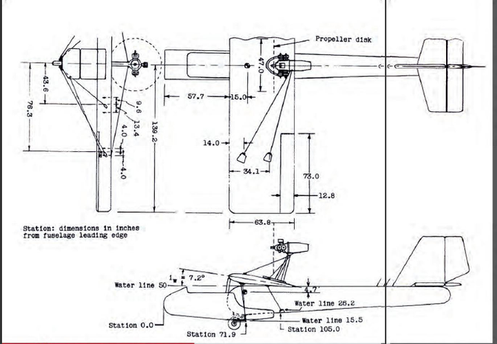

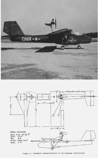

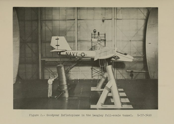

Early Office Naval Research sponsored Inflatoplane - GA-447 report.
Later Inflatoplane GA-468 report.

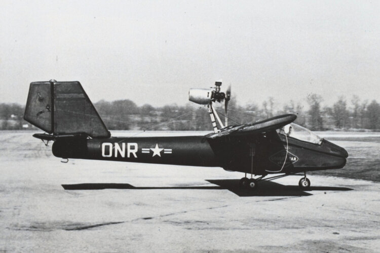

I`ve found some good hd pics of a single seater inflatoplane that was up for auction at morpheys last year.
It looks to be all there,just a little rough around the edges as one would naturally expect of a rubber aircraft of this age.
Also some interesting looking books included with it,especially the one titled: The Rubber Flying Machines by Ernest Stadvec.It would be interesting to track a copy of that down.
