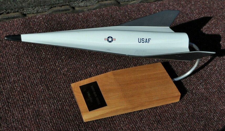

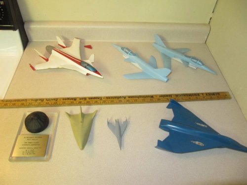

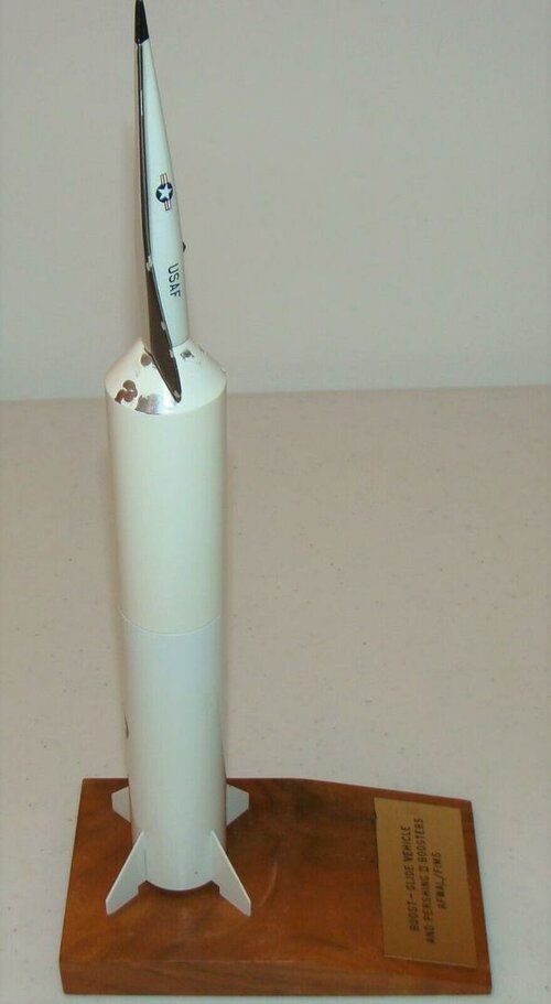

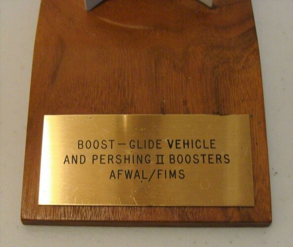

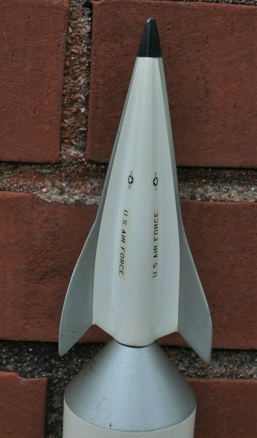

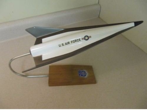

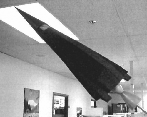

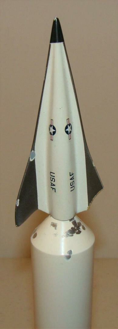

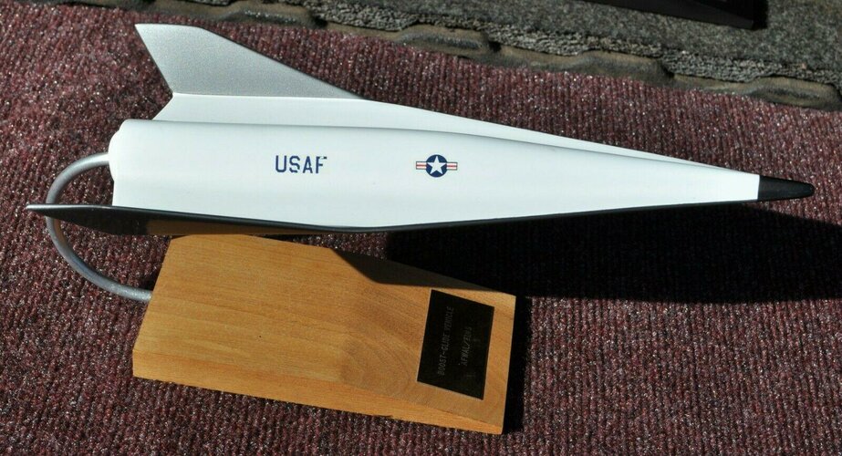

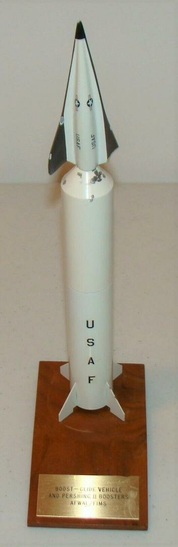

RAP said:
Interesting model. Also has pics of other models that look will be up for auction soon.
http://www.ebay.com/itm/RESIN-BOOST-GLYDE-VEHICLE-and-metal-MINUTEMAN-3-BOOSTERS-/201483158527?hash=item2ee95503ff:g:nikAAOSwnH1Wauuj
Related:
http://www.ebay.com/itm/RESIN-BOOST-GLiDE-VEHICLE-Desk-or-Shelf-Model/201488689278?_trksid=p2047675.c100011.m1850&_trkparms=aid%3D222007%26algo%3DSIC.MBE%26ao%3D1%26asc%3D20140602152332%26meid%3D6ba044b79d104f5f9f74dc45333fb33c%26pid%3D100011%26rk%3D2%26rkt%3D2%26sd%3D201483158527

American spaceplane. Study 1992. The Hypersonic Glide Vehicle was a USAF project discussed openly in 1987 to 1988, which may have flown as a black project in 1992-1993.
AKA: Hypersonic Glide Vehicle;Strategic Boost Glide Vehicle. Status: Study 1992. Gross mass: 2,000 kg (4,400 lb).
A model of the General Dynamics concept for the vehicle was shown at the Air Force Association show in 1987. Martin Marietta was an associated or competing contractor. The HGV resurrected the Dynasoar boost-glide bomber concept of the 1950's. A booster would accelerate the HGV to Mach 18 and an altitude of 80 km. It would then enter a long glide, coming over its selected target at Mach 5 at 30 km altitude. An HGV launched by a Minuteman would have a range of 15,000 km; air-launched from a B-1 or B-52, a 7,400 km range.
Advanced materials and lightweight avionics were expected to make it possible for the ca. 2 metric ton HGV to have a useful payload. These might include an interceptor using Raytheon's LORAINE (Long-Range Interceptor Experiment) phased-array radar; or a surface attack missile using Loral air-to-surface guidance concepts developed for the USAF Maneuvering Re-entry Vehicle (MaRV) program. In 1987 the USAF was considering a five-year, $400 million program ending in four Minuteman-boosted HGV flights from Vandenberg AFB. Reports as late as 1992 indicated the tests may have occurred under the Have Space project, with the air-launched version referred to as the HGV and the ground-launched version as the Strategic Boost Glide Vehicle.
The NASA Hyper-X air-launched scramjet experiment may owe some of its launch vehicle underpinnings to HGV.

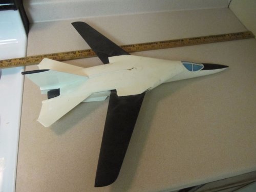

The image is not of an HGV model, but of Isinglass. Isinglass was not a GD project.
In the late 70s and early 80s DARPA pursued a program to demonstrate an air launched ballistic missile with hypersonic glider for air-to-air. This was the Ballistic Intercept Missile. The reentry vehicle was to be SWERVE. LORAINE was the guidance and seeker package. The thinking was that this missile could be used to shoot down bombers threatening the US or carrier groups.
At the same time USAF was pursuing their boost glide vehicle for hitting ground targets, and the navy had their own program. In 1987 congress ordered that the DARPA, USAF. and Navy programs be consolidated (sound familiar?). The USAF program at this point looked at air launch, ground launch, air breathing and rocket, air to air and air to ground. This was the Hypersonic Glide Vehicle program. OBB's image shows some of the proposed GD HGV configurations at that point. There are some other images on the forum of models, etc. that depict the same vehicle.
At this point the DARPA effort was well along. Some parts had been flight demonstrated (SWERVE) and some were maturing in labs and almost ready for flight test or demonstration (GPS INS guidance, terminal X-band seeker). But no service really took interest or ownership and the program died. The air force program generated a lot of paper studies and some tech development in labs but that seems to be it. The likelyhood of some covert flight test of a glide vehicle is small - that would be difficult to conceal.

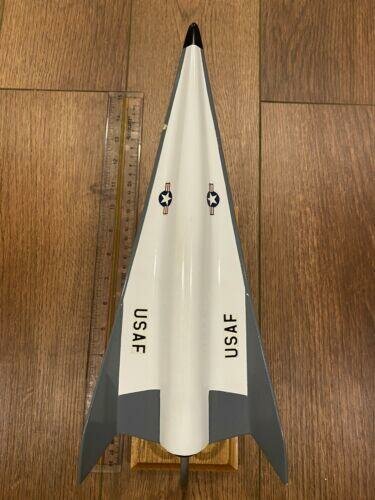

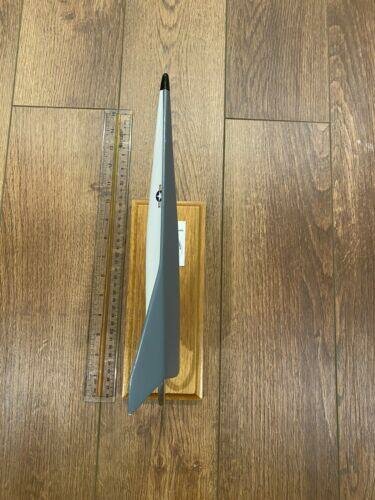

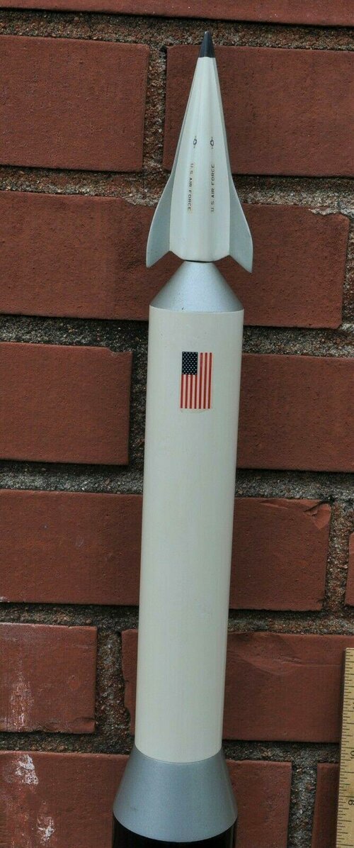

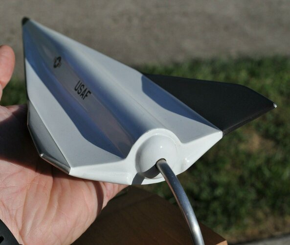

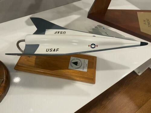

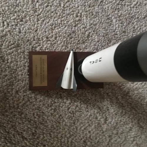

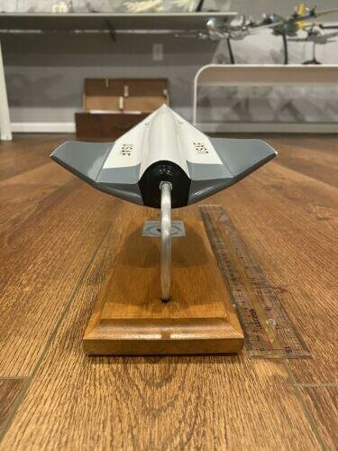

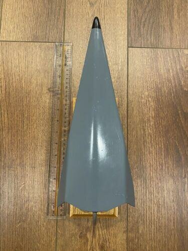

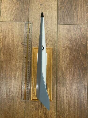

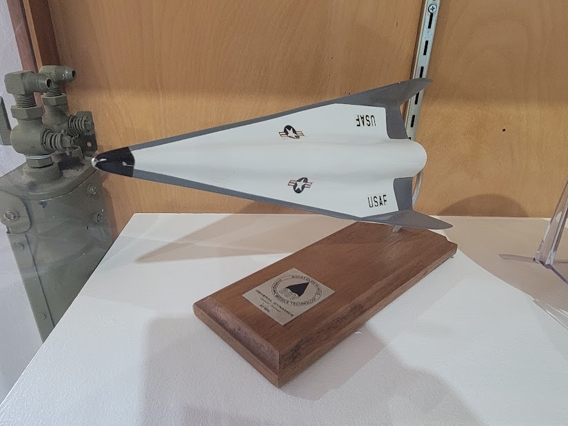

Boost-glide model found on Ebay. Bidding closes in less than an hour.
From the seller's description: "THIS AUCTION IS FOR A RARE EXECUTIVE DESK MODEL ROCKET. THE ROCKET IS A " BOOST - GLIDE VEHICLE. THIS JUST CAME OUT OF AN ESTATE FROM AN EMPLOYEE THAT WORKED AT WRIGHT PATTERSON AIR FORCE BASE. I BOUGHT THIS MODEL AND OTHERS THAT I WILL BE LISTING. THIS ROCKET LOOKS TO BE MADE OF SOLID ALUMINUM OR SOME TYPE OF HARD COMPOSITE. THE BOOST VEHICLE IS 12" LONG. PLEASE LOOK AT MY OTHER AUCTIONS FOR MORE GREAT ESTATE FINDS"
The whole page has now vanished…

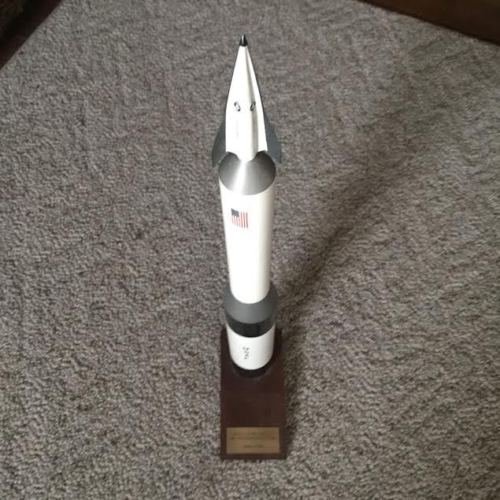

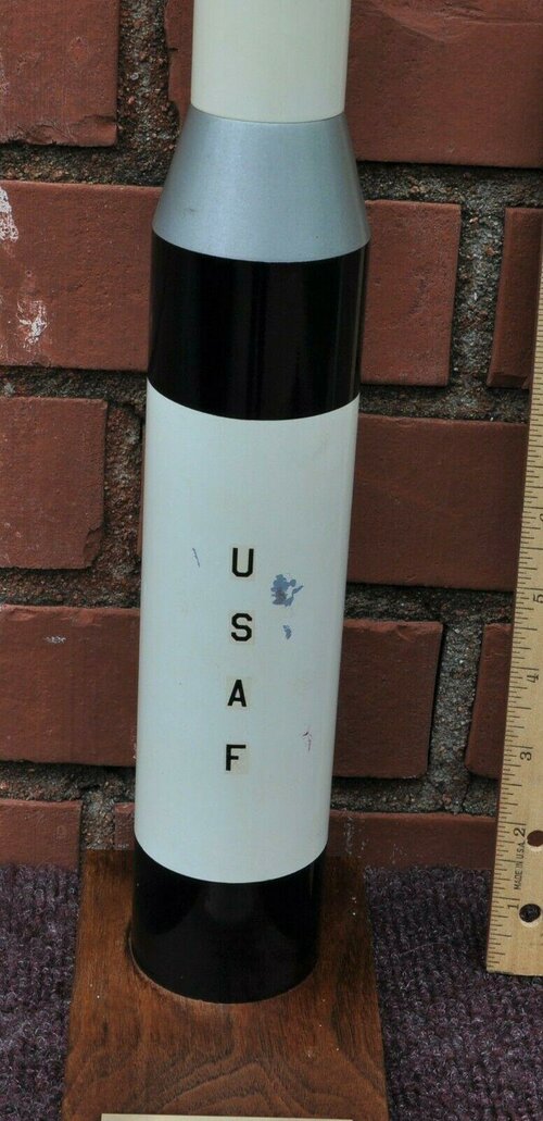

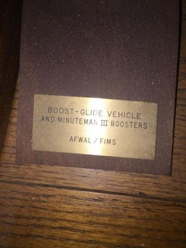

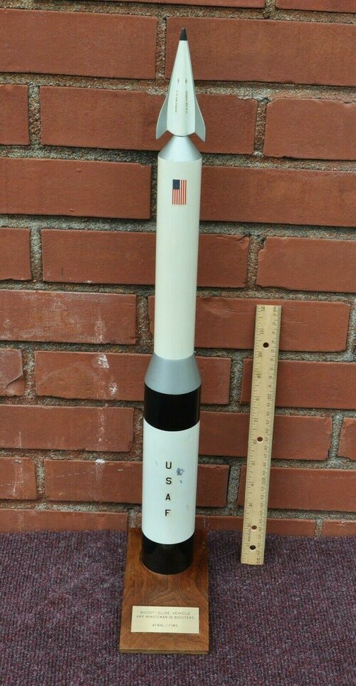

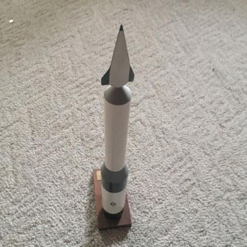

This seems to be related to another model discussed elsewhere in this forum: https://www.secretprojects.co.uk/threads/minuteman-boost-glide-vehicle.26249/
wherein a combined Minuteman/BGV model sold on ebay and similar to the one shown here above.

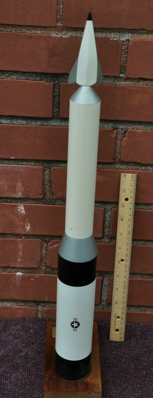

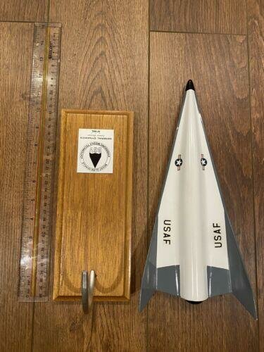

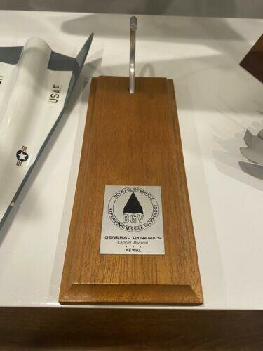

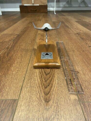

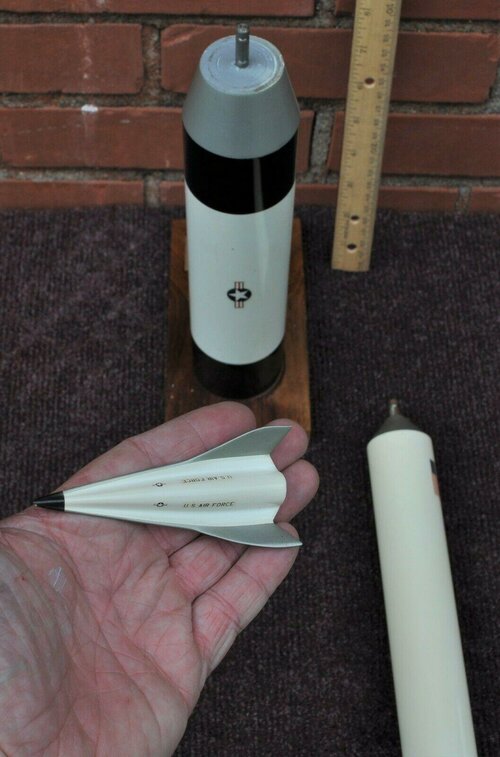

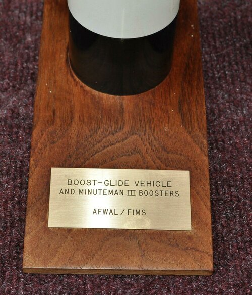

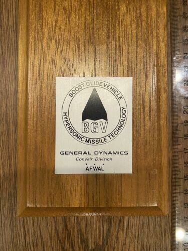

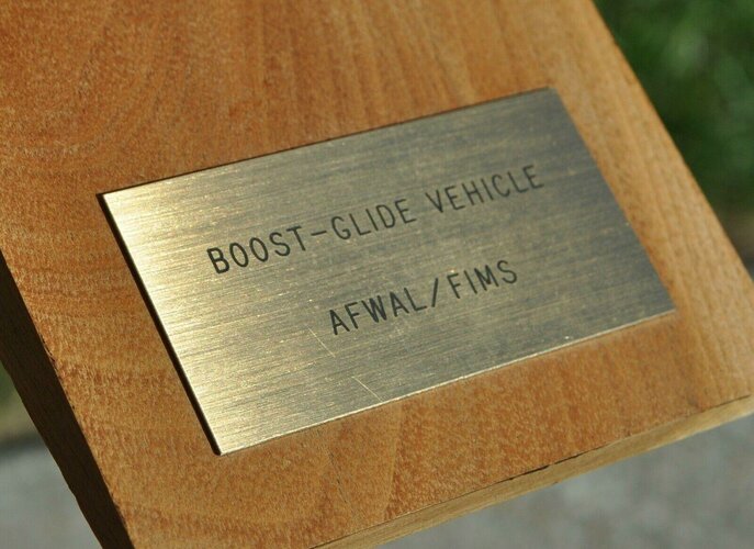

Better quality photos of the initial post eBay lot
