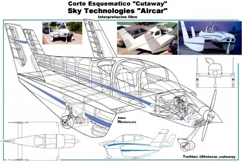

Cutaway Sky Technology "Aircar" the ing retired from Bell Helicopters Kenneth Wernicke working for many years in his own version of Auto Volador, study limitations that made it impractical, decided to design a flying car would not have to undergo the "Surgery" before each flight and after this, as in many other designs of flying cars from Gustave Whitehead (I built the first flying car in history) to Terrafugia, not to mention the dozens of projects that were more or less a success in flying but not so successful in sales, auto flying ones who got the media attention were: Paul Taylor and the Aerocar Airphibian but both had to undergo a conversion according to its makers was very simple "removing a screw here and a pin there, "but it should have a place to store the wings and tail when you were not at home, the project engineer. Kenneth Wernicke instead only had to attach the propeller and find the nearest track to fly, its design was quite simple, but his greatest contribution was those very short span wings with large vertical fins (These help reduce aerodynamic drag and generating the necessary stability) this trait made ​​the Aircar a relatively compact vehicle that could patrol the streets and avenues, its engine a Mazda Wankel modified to fly and this in see moving a hydraulic pump that conveyed by high pressure oil traction to the wheels perfectly faired after huge "Pants" which in turn favored stability and reduced drag only would have two speeds forward and backward, and its top speed of only 110 km / h but the air could fly over 300 km / h, with that engine, its designer argued that more advanced models would use turboprop engines higher power that would allow it to fly at almost 500 km / h, after extensive testing of wind tunnel and compare different models, I build one controlled radio that flew very well in the words of Mr. Wernicke, I manufacture a Mockup of the same demonstration but did not get the interest of investors leaving only a technological promise for the contributions and advances made by Wernicke, author Motocar in a free and highly speculative interpretation of Aircar.

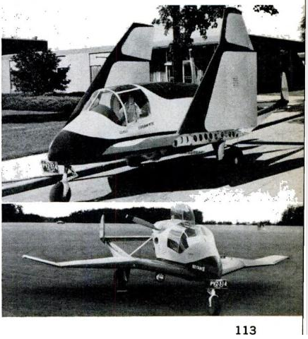

my dear Robunos displayed before the Bryan II roadable aircraft,and may be that's
the variant III.
http://books.google.com.au/books?id=htQDAAAAMBAJ&pg=PA113&dq=Popular+Mechanics+May+1973+PAGE&hl=en&sa=X&ei=EleAVJTpJoveaP7igJAB&ved=0CCQQ6AEwAg#v=onepage&q=Popular%20Mechanics%20May%201973%20PAGE&f=false

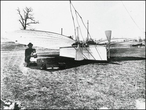

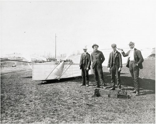

Whitehead's achievement was all the more remarkable when you realise that he was designing a flying car and not just an aeroplane. The No.21 had two engines, one for the road and a second to be engaged only for flying. It was said to run down the road at a respectable speed for a car of that era, its wings and tail neatly folded against its sides.
But I doubt that it really flew in the accepted sense of being all of powered, sustained and controlled. Powered, yes. Sustained, maybe - but several uncontrolled craft had already done that, including an earlier steam-powered two-seater of his. The No.21 had no effective control system. Whitehead reckoned he could steer it a little by leaning sideways but while that is OK for a hang glider it is hopeless for a powered aeroplane.
His No.22 was a better design in this respect, having twin propellers with differential power feeds for turning. But there is at best insufficient evidence to verify his claim of a long circular flight over water.
It's a real shame that the history of these important flying cars is so buried under the kind of vicious controversy and malicious falsehood that is usually reserved for divorces and political elections.
Controversy will always be, my assertion is that inadvertently Whitehead built the first flying car in history that's the point, whether I run this theme is packed with dozens of ideas that example did not materialize the "Roadair" that made a schematic cut quite speculative, during his only attempt at flight just get up about 60 cm of soil but its designer and pilot never returned to try to fly, separated by 60 years in the future and that was the result, I am of the opinion that a flying car the future will be actually a flying motorcycle, they are lighter to only have three wheels and classified so many traffic laws, need not carry all the safety features that command the laws today day for cars. Moreover the Wright brothers had for many own developments and dedication and record all activity, although its first flight (jump) was only 36 meters and did not show much control, which in successive flights were improved in I repeat order Gustave Whitehead was the pioneer of the "Flying Car" that unknowingly

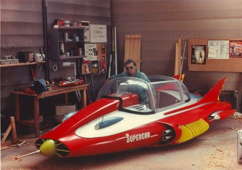

Here I leave the image of a true "Fan" of Supercar and Auto Volador fantastic ......!
Success

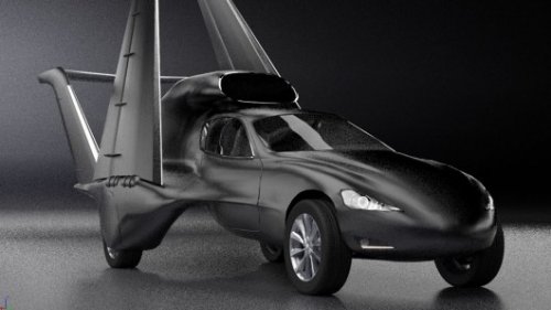

hesham said:
here is the GF7 flying car;
Surely that wing is too far back. I can't believe that the lift coefficient of the windscreen is that good.
steelpillow said:
... I can't believe that the lift coefficient of the windscreen is that good.
;D
But judging the CG, that is shown with a small spot in the side view and the jet
engine, that is positioned well behind it, I think, the weight distribution may be
ok. The wheels are driven by electric motors, not by a by a piston engine, as the
long, sports car like engine cover suggests. That's just a stylish element, I think.

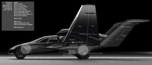

The wing's centre of lift is barely in front of the rear wheels. For stability on the road, the centre of gravity will need to be a foot or two further forward. The conventional way to reconcile those is with a downforce from the tail - in which case I do not believe the required wing loading. The only other way is to generate strong lift from the windscreen and bonnet, which I also do not see. No, this is not a real design, it is a concept.
Just to be an idle pedant.
The difference between this and the Mizar is that the latter's wings and car separated. The CG when separated (as a road car) and the CG when assembled to fy were in different places. With the wings, the CG moved aft almost to the rear wheels and the car was barely balanced on the ground. Takeoff and landing could be a bit hairy, and ISTR seeing photos of it sitting up and begging. Even given a wide empty airfield to play in, this was not an assembly you could just drive around.
The GF7 does not have this luxury. Its CG is stuck in one place, leaving one or the other travel mode hopelessly unbalanced. Nor does it matter where the weight distribution puts the CG. The only thing the weight distribution affects is which travel mode it upsets, if not both.
No, just precise, I think.
And you're right, the comparison to the Mizar was a poor one. The hinge lines of the wings
seem to be parallel to the longitudinal axis, so no way to use the folded wings as counter weight
on the ground. The only way I could imagine in the moment would be pumping fuel from forward
to rearward tanks. Very inconvenient and not very probable !

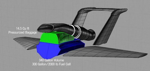

An interesting picture, that shows the positions of tank and engine more clearly can be found
on http://thetechjournal.com/?attachment_id=176715

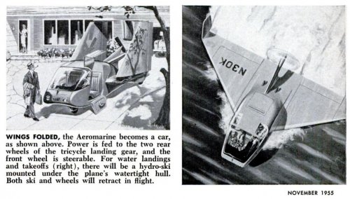

Recently came across what may very well be the earliest ever project for a roadable aircraft (1911):

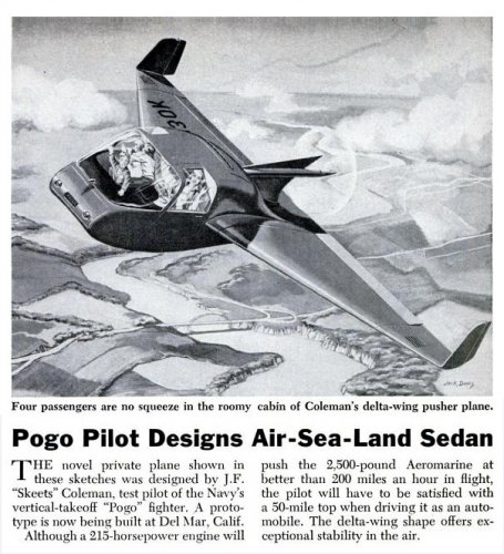

Recently locate this project amphibious flying car designed by a test pilot, named "Amazing Automobile Flying Boat" a novelty in itself to be designed for three media, air, water and land. was little or no information that achieves get over it, here I leave the image taken from the cover of a copy of an old magazine Mechanix Illustrated in an edition unidentified 1956
P.D. I wonder if some friend has more information on this project or even better magazine to identify
This seems to be the Aeromarine flying car of 1955, designed by J.F. "Skeets" Coleman, a test pilot of the Navy's vertical takeoff Pogo fighter.
See post #99 of this same topic.
Definitely IS Coleman's Triphibian Aeromarine project.
If you right-click on any post's title you can copy-paste its link and it will lead to the post in question.
It's much better than browsing page after page of such a long thread... ;)
Thanks friends for fast answer....!
Motocar
Awesome idea.
Can't help thinking the propeller is a bit exposed to spray, it would need to be mounted above and slightly forward of the trailing wing section.
How about using it as a sailboat?
